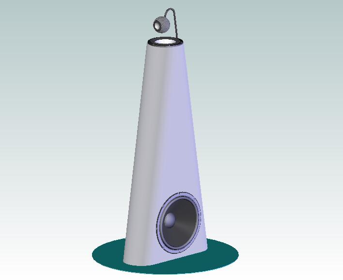

Transmission line Omni speakers? Duevel Planets clone with transmission line?

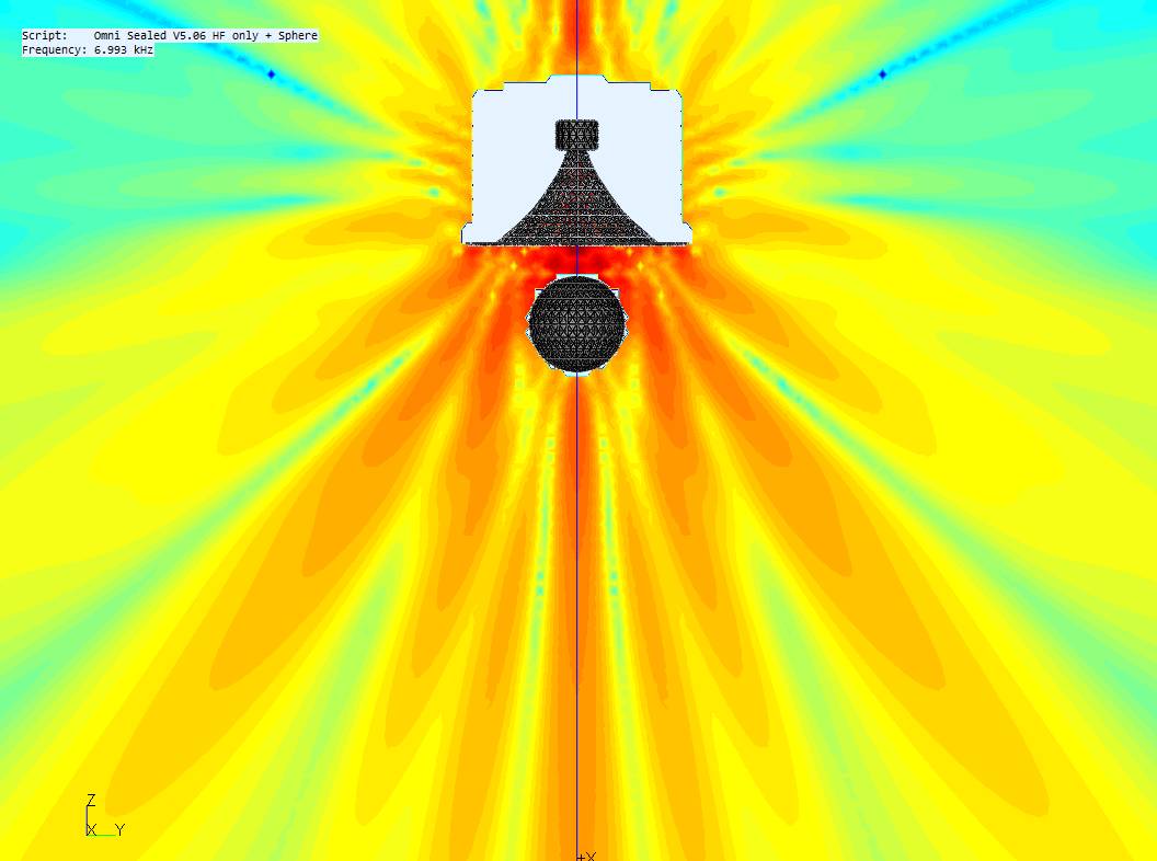

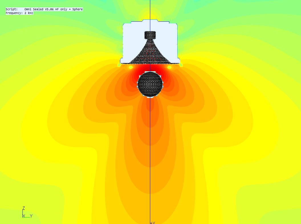

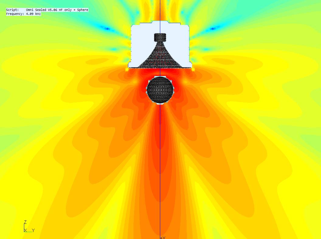

Now with a sphere.
Hi Don, thanks so much for all of this!
So looks like the HF is a mess of nodes with the sphere, but better than nothing i guess and the sphere does aid the dispersion somewhat. I assume the ceiling reflections will help a bit as well.
Yes, but its surprising what gets filled in by the room when you spray it with an Omni.

I've tried a few shapes and drivers to get 360deg dispersion and ended up heading in the direction of the other Duevel omni models like the Belle Luna.

Stock spheres are easier to get and it does allow quick experimentation to try out the listening experience. I've been thinking about the sphere idea and whether it could be modified to improve it for the HF section. Something like "saturn" (center mount disc+sphere) with a smallish cone attached on the sphere's bottom. Custom making complex curve shapes manually is definitely more work, I'm not at the point where I can 3D print them.
