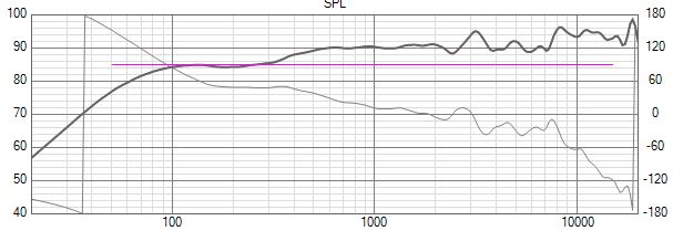

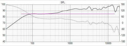

I am with Perceval, and me too I don't want to rain on your parade. I am usually very wary of really expensive fullrange drivers... seems all of them are presented to the unsuspecting buyer pretty much the same way.
They usually make quite a bit of drama how their driver is absolutely unique, that they found special 'tricks' that no one has found or tried in the last 70 years, they employ eye candy in the way of chromed this and that etc. You get the idea.
When you can find a frequency response it is usually very stretched out in X and 'compressed' in Z... makes for a 'flat' response. There is no indication how the driver was measured (... I didn't look), but the response indicates an infinite baffle that will boost the bass region by as much as 6dB. Only you will not put your drivers in the wall of your living room.
All, and I mean all fullrange drivers with a wizzer cone have a rising response with local peaks due to break up modes and interference to some degree, and as Perceval pointed out every driver underlies the laws of physics. Which means that the 30 and 60 degree curves are bogus because especially the 30 degree usually looks a lot more jagged. Physics, not marketing.
Attached are a few responses that I happen to have... equally stretched out on purpose, and you will see the rising ersponse of all the them (not filtered of course), usually around 15 dB.

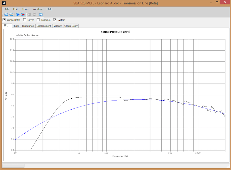

It should be very similar to Martin King's Mathcads.
Maybe check, if everything is the same (driver parameters, ...).

I wish I did it the other way round [emoji6] still figuring out why my curve is still not similar. Looks like stuffing makes the difference, when I lower stuffing it seems to approach the same curve..
Yes, I think stuffing simulation is slightly different.
Compare it with no stuffing.
It is usually better to start without stuffing to reduce harmonics by changing dimensions (especially important for full range drivers).

What can I do to make the model more representative?
BTW, I do not know if I go the right way about this in this thread or if I should be making a seperate one. Please do tell me if I should.
You can't since T/S theory peters out at the driver's [effective] upper mass corner and even then, it only shows a flat piston's response: Fhm = 2*Fs/Qts'.
Above this point the better programs can do pistonic polar plots, but any driver TL, breakup modes will modify it in ways that can't be predicted without significant actual measurements and the massive programming required to replicate it.
Qts' = Qts + any added series resistance [Rs]: HiFi Loudspeaker Design
Above this point the better calculators will include wide range response due to inductance [Le @ 1 kHz]: Fhvc = Re/[pi*Le], and a few that include thermal power distortion at higher power and at least one that includes lossy inductance options [Hornresp].

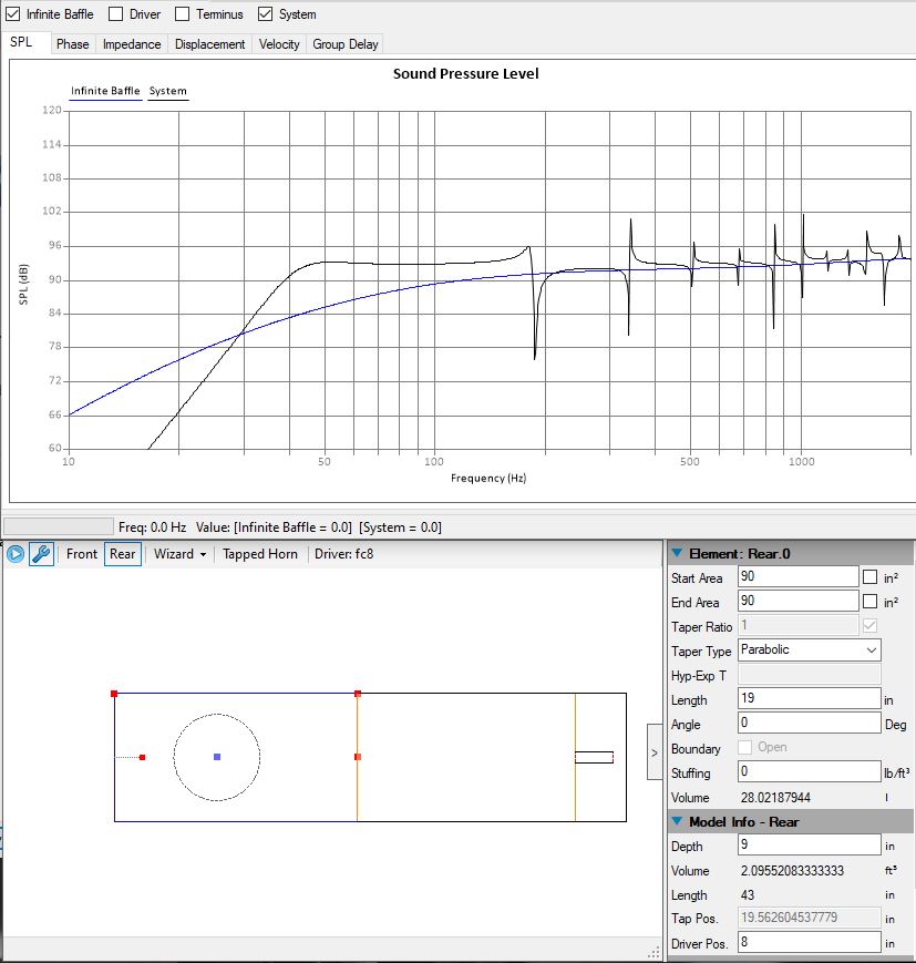

Hi all,
I managed to get Leonard Audio TL software to work and started to model one of the DIY cabinets provided by Cube Audio for their FC8 driver.
Could any of you confirm if I am heading in the right direction?
Greets!
Did a quick sim in Hornresp
using your LATL alignment [not the folded drawing] that while quite rightly should have a parabolic expansion, the LATL is plotting the opposite [horn] flare even though the response plot is near enough identical, so assume it's this that's inverting TH sims: Transmission Line Modelling Software

Ok, I have tried a MLTL with dimensions 10"W x 9"D x 40"H. Port diameter and depth both 3" (Positioned 4 inch from bottom). Without stuffing I get the attached result. This looks like a much smoother "knee" right?
Indeed it do! 😉 But this one doesn't line up quite as well since HR plots 90 dB/~36 Hz Vs LATL's ~38 Hz plus the HF ripple is somewhat different, so combined with the sim's data, not sure you inputted it right, though been away from this program long enough to not be sure.
I mean you show the rear view, why? IIRC all that's needed is to just input the data in the front view.
What is the 19" length?
What is the 19.56+" shadowed in the Tap Pos. field?
