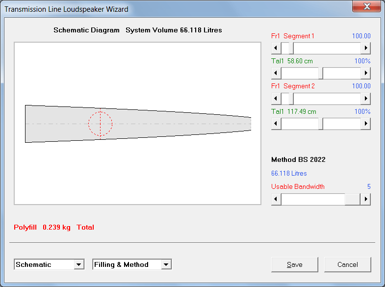

Have you tried using the Input Wizard in Hornresp - that may make things a little easier for you. The Wizard can be selected from the Help menu on the main input parameters window.
No I followed the video step by step to get a usable result. He used the Loudspeaker Wizard so I did the same. Although when I repeated the exact same steps today the Loudspeaker Wizard was greyed out and not select-able. (not exactly the same I didn't add the parameters, I used the driver I previously saved) so not sure why that isn't working when I did the same things (unless the act of entering the values somehow enables that option).
I took a quick look at the Input Wizard I found under Help (strange place for it to be). Without more instruction on how to use it, I am shooting blind on what to choose. What did come out the other end was anyone's guess and seemed to be based on the default driver, so I am assuming that you need to have the driver you want already selected on the main page for it to produce a meaningful result.
The record needs to be in Edit mode for the Loudspeaker Wizard to be enabled.
The Input Wizard is there to help the user, which is why it is accessed from under the Help menu.
The wizard produces a design template based on the options chosen by the user, which can then be customised as required. The driver can be changed from the default as part of the customisation process.

Hey what is this screen that has popped up? It says Schematic Diagram, that's pretty now what do I do with it? I have what appears to be two usable tabs "Windows" and "Tools" I click on tools because it is first in the order. I see a couple of options that don't really mean a lot to me at the moment, so I press "Windows" to see what is under it. OK I seem to have a list of different views.
I start clicking to see what each of them does... At no point is it intuitive that depending on which Windows number I have selected that it is going to alter the options available under Tools. I am only going to later discover that (hopefully) by flicking around different tabs and being observant enough to see that there are different options.
Whereas... a simple sub menu under each of the numbers in the "Windows" visually shows me that there is additional information there, I click on it, and I see all the same options that would have been there had I known I needed to click tools. By having a sub menu under each of the Windows numbers, I don't have to switch away from this same screen and it is visually much easier for the user to see. I can even delete the Tools tab entirely, unless I want to put some wizards like the one currently hiding in Help in there.
All the same stuff, just way easier for the user to navigate and use. Some tool tips on each of the buttons with a brief explanation obviously helps that little bit more.
