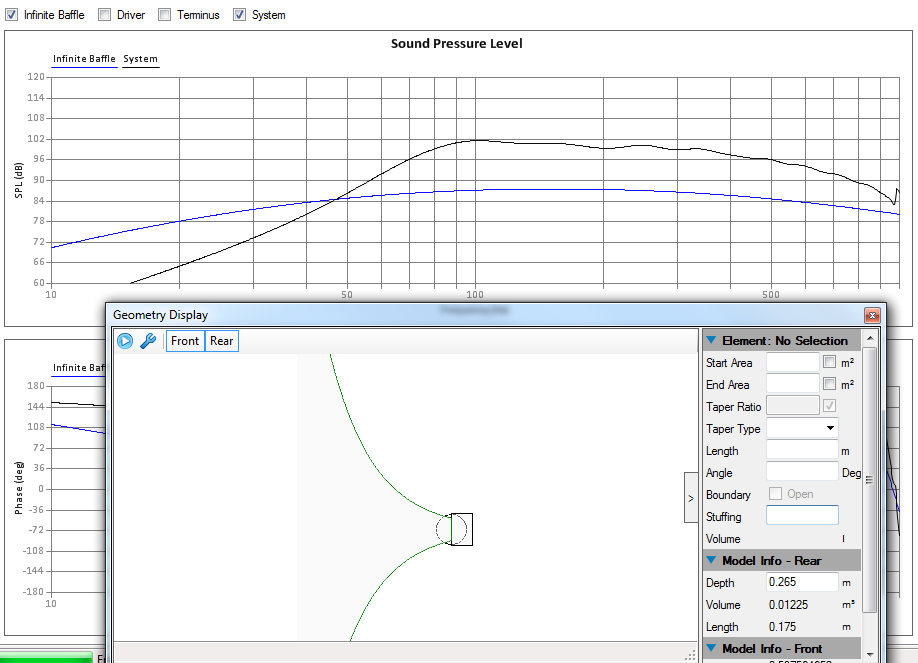

Well.. To design most enclosures you can use the program in exactly the same way as you used to.
However, to design something like a Front Loaded horn then you need to have an enclosure both behind the speaker and infront of the speaker. (So you cannot 'see' the speaker).
The below image shows the kind of enclosure you would design using this method:
For Example:
- Start the default project and open the enclosure window:
- The existing element is 'Rear' i.e. behind the driver. So make this into a simple closed box, like in the image. Lets make it 12.25L (0.175m x 0.07m²)
So set its length to 0.175m and its start and end areas to 0.07m²
As it is now, your enclosure is just a simple sealed box, but we also want there to be a horn in front on the speaker. So you need to add an element to the front of the speaker. Right click anywhere and select 'Add Front Element'
Spin, the new (green) element around so it is facing the other way (180 Deg).
Make it open.
Make it 1.3m long
Make its start area 0.05m²
Make its end area 1.66m²
You should now have a horn enclosure that (with the default driver) is tuned to around 75Hz.
