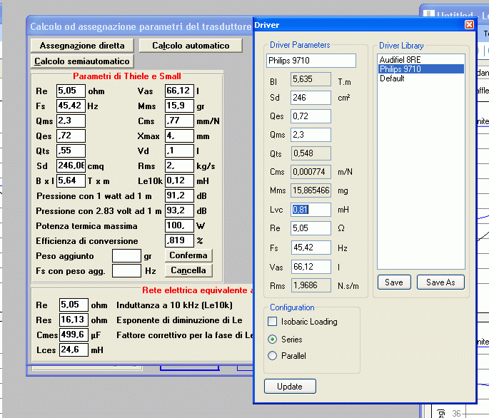

Just a detail...
It seems that in the driver data entry window, parameter "mms" is signed wrongly as "mg" where it must be "g"
look for comparison side by side the data entry window of TLMS and the one from another highly regarded program , everything fits, except the mms value...
Ok, I have found the error here. Fortunately it was using the correct but just displaying the wrong units. I'll release as an update later this week with other changes I am making at the moment.
Thanks for letting me know.

- Fixed the Mms Unit bug.
