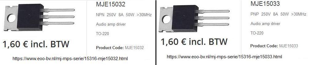

Why didn't you start with some not so expensive transistors to get it working and later on there is allways the possebility to upgrade 😕I have indeed noticed that on other amps and if possible always decided to go back to original. This amp according to some is different in design which actually makes this not so, I'm just saying what I read and heard, I'm not stating who is right or wrong. There was a lot wrong with the amp (not only the outputs so just replacing with the original ones wouldn't have fixed it, and again, the cheapest (not fake ones on ebay) I found were 23€ a piece meaning a total of almost 200€ just for the outputs...
Very rare but not impossible.By poking around everything in the neighbourhood vibrates a little, it take not much for a bad contact to misbehave.I was poking around with a wooden stick and precisely when I hit the 2SK109 I had a little peak, since then it seems stable, I've checked the solder joints but they are clean and not touching, could it be that the transistor itself is failing at some point ?
Mona
I had some BD911/912 in my stock, I started with those but another member of the forum advised me to go straight for the single pair of outputs so i GOT THOSE 2sa5200/2sc1943, they weren't very expensive and at that time the amp seemed to be working ok.
