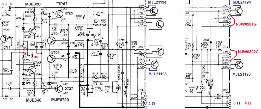

Question of protection with (two times) one or two power transistors is simple.
The protection is for only one transistor, the other is supposed to follow (without check).So if you put only one in, it is fully protected as long you put it on the right place (protected side).
With transistors that can do the job for two, just connect them to both emitter resistors.The protection acts on double current as originally with two transistors.
With other output divices the bias risk to be different since that depents on the Vbe of the transitors (both driver and final).
To make it adjustable, an example drawn.Gives a range of somewhat more than original to zero.

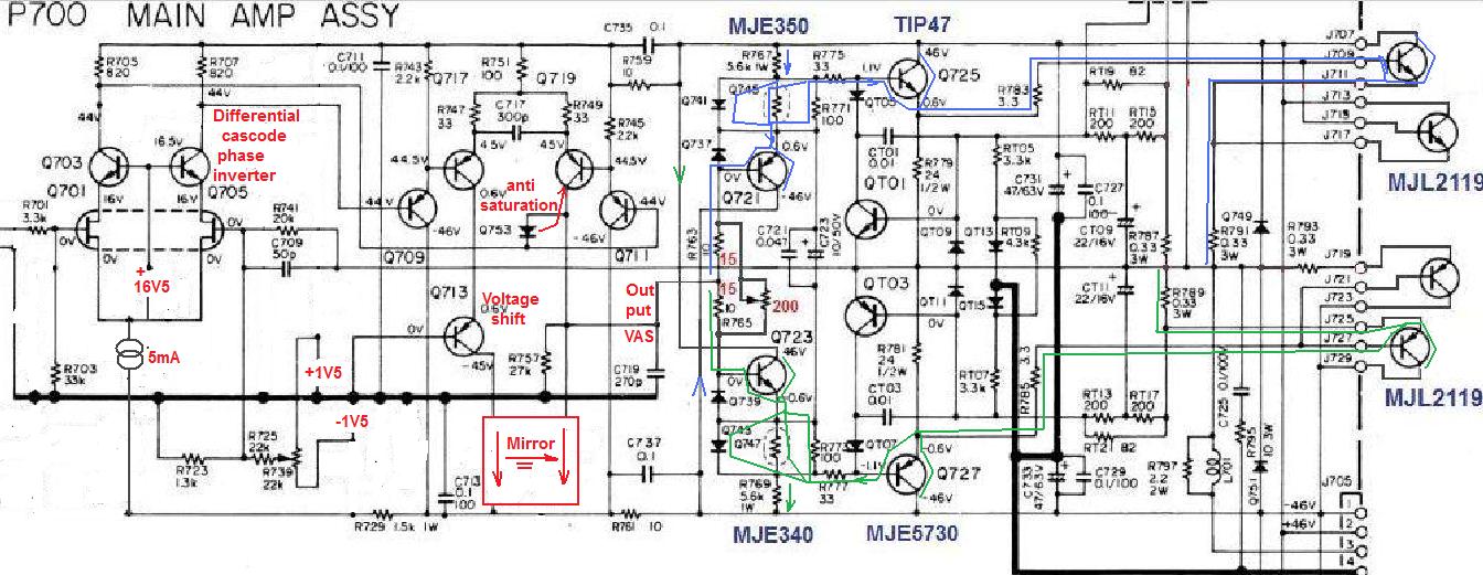

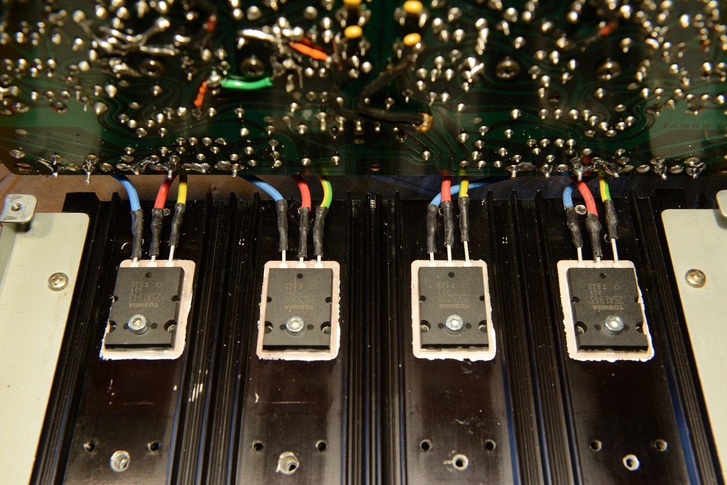

I actually removed the emitter resistors of the pair of transistors that I removed and just put two in place with a higher power dissipation, is that also going to work or should I leave the 4 of them and just connect the emitter of that one power transistor to both resistors as you said ?
As for the power transistors I put a pair of 2SA5200/2SC1943
and the drivers are MJE15030/MJE15031.
For the bias, do you replace the 10Ohm resistors by 15Ohm and than put a variable resistor across and set it for 200ohm or did I get that wrong ?

A emitter resistance of 0.33 gives a protection up to half the max. current, the other half is supposed to be come from the parallel device.If you want to have max. current from one transistor you must give the circuit the impression that it hasn't reach the max. yet.That is make the emitter resistance half or put two in parallel.Double current gives the same voltage as before.
The 200 at the trimmer is the total value (adjustable from 0 ... 200 Ω ).

The 2x 10Ω there is 20Ω between the bases and with 200Ω in parallel gives only 18,2Ω max.With that value you can't reach the original value again.
Now 15Ω gives a variation 0 ... 26Ω, and 20Ω is within the range.

All current in the power devision comes from the resisances R767,768,769 and 770 (all 5k6).How much is realy go to the driver-finals depends on how much is snooped away by the bias circuit, Q741//R771-Q721-R763-R765-Q723-Q743//R773 (for 1 side), and warms up Q721-723 with a max a little over 200mW.
The driver get 25mA bias (according schematic, 0.6V on 24Ω) at 46V for less then 1.2W heat.

If both drivers from the same amp gets hot it is the bias current to high (make the mod to adjust), if only one side it is in the power division.
The jumps in the output can also come from a bad zero-adjust potm.(R739,R740)

To give you an idea how the thing function I tryed to put arrows and deleted non essential things in the schematic.Hope it helps.
