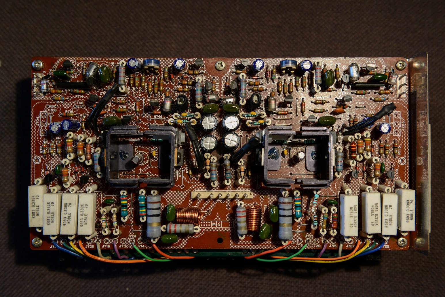

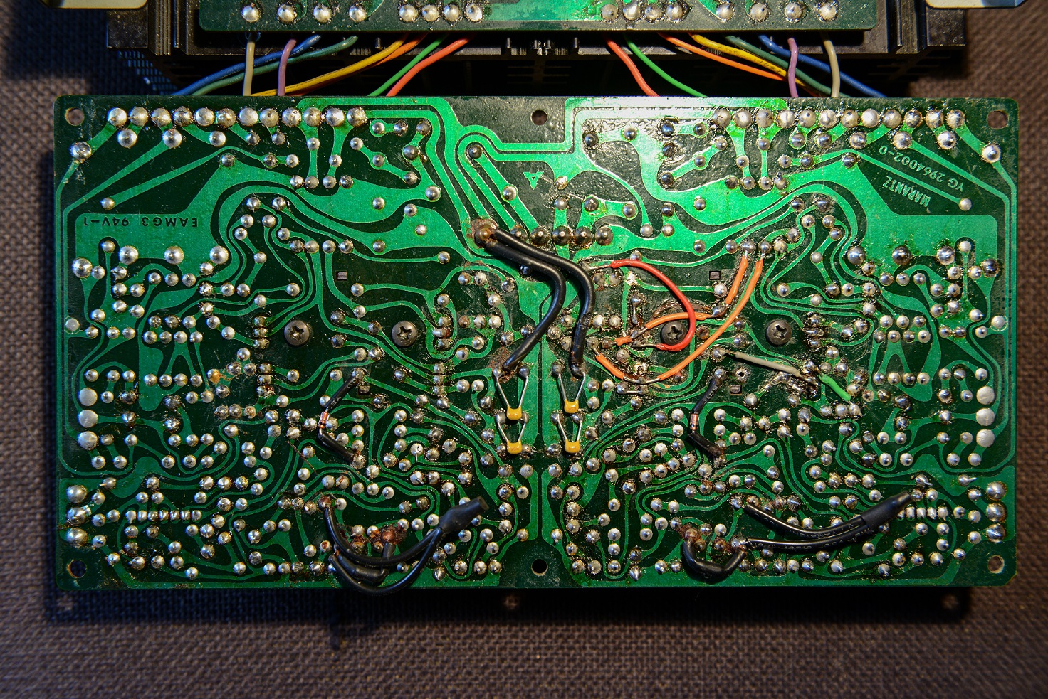

Got a new marantz sitting on my table but the main amp board is in pretty bad state, it's obvious one or more failed attempts to fix it have been made, a lot of tracks are missing and were poorly repaired, some resistors had been replaced but soldered in series in stead of both connecting to earth, some transistors only had one or two legs soldered to the board and 4 of the 8 power transistors that had bee replaced with BD911/912 pairs are shorted (one entire channel). The pre drivers and drivers have alson been replaced with MJE15031/15030 for the drivers and MJE 340/350 for the pre-drivers (those are fine but are they good replacements here ?
My actual question is what would be the best substitutes to the original 2SB618/2SD588 power transistors ?

OK so finally I decided to go with some new BD911/912 and everything seems to work fine, I'm able to get a DC offset of about 5mV and I get a beautiful sine wave on the speaker terminals but the problem is that I only have 3mV idling current on one channel (between the emitters of both pairs of pnp/npn) and 9.5mV on the other channel. The service manual doesn't give any info on what the bias should be and there is no adjustment possible. Are these values too low and too unbalanced between both channels or is there no need to worry ?
Obviously the 911-912 combo is slower than the original and a bit lower voltage ,,,,Obviously also it doesn't turn on the same way like the Japanese cousins do so that is why you cannot bias it properly ...
I could consider a repair like that as a degrade ...

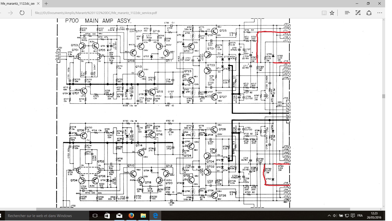

Hi Sakis, finally received my parts today and am starting to redesign the output stage to fit only one pair of complementary transistors per channel. Can I just remove 1 pnp and on npn on each channel and their corresponding emitter resistors or is it a little more complicated than that ?
here are the schematics with the corresponding tracks connected to each transistors I'm going to remove.
I made a mistake on the schematics, on the upper side it's J717 and J719 that I will remove and not J711 and J719.
I followed your advice and bought 2 pairs of 2sa1943/2sc5200. So I removed 2 pairs of the original transistors (1 on each channel). these correspond to the wires connecting to J717 and J719 on one channel and J718 and J720. For the 2 pairs that I removed, can I just also remove the 2 corresponding emitter resistors and leave all the rest as is (except for the vbe that will have to be modified) ?
sorry i am not with you at this point
If you have one amplifier with 4 small transistors in the output that are unobtainable then you need to remove them all ( all 4 of the old ones ) install just a pair of bigger transistors drive them from the same base signal that existed in the past use emitter resistors exactly as the old ones, maintain the same value for the resistor replace though if the old ones are 2W types with 5W types

Now there are 4 emitter resistors per channel and I just wanted to know if I could remove the 2 that aren't necessary any more as I now have only one pair.
You gave me an answer without knowing it so thanks. I don't have micas for these cases and will have to get some more powerful emitter resistors so it might take some time before my nest update.

I could still use some help on how to calculate the overload protection, this is something new to me ! I've been looking for these forms you told me about but couldn't find anything (at least not clear enough for me to understand.
This is the datasheet for the new output transistors I installed, how do I proceed to calculate and how do I translate this into the actual values needed in the circuit ?

And this is the main amp circuit

Hello again,
Just finished installing the new output transistors and powered up the amp with a bulb tester. Relay closed after a while (a little longer than usual). I measured the offset and managed to set it to around 3mv but it isn't very stable (it goes up again every time I switch the amp off and on again). I have around 10mV of bias on one channel and 22mV on the other. So far I haven't changed the emitter resistors yet, should I just remove the pair that was connected to the second pair of outputs that I removed and replace the other pair by same value resistances but higher power dissipation resistors or do I need to change value as well ?
For the vbe I would like to install two trimmers to be able to adjust it precisely. there are two transistors in the bias circuit per channel (Q720 (721) and Q723 (724)) where would be the best place to put those trimmers ?
Ok so I replaced the emitter resistor with more powerful ones and started testing, relay clicked and the d offset stabilised around 0mV. I get 22mv bias on the right channel and 11mv on the left channel. Both test ok with a 1kHz signal and no load. When I connect a dummy load (8ohm 100w) to the right channel, no problem, nice clean sine wave and the amp stays stable but when I do the same with the left channel the bulb tester lights up quite brightly as soon as I turn up the volume and the amp goes nuts (oscillates between +/- 1v) and I have to power off.

Haven't really done anything to it these last days but today I fired it up again and did some tests with 8 ohm dummy loads and everything seems fine, got a beautiful and equal sine wave on both sides. Still I got around 6mV of bias on 1 side and about 24mV on the other, The vbe seems to be set by diodes so no way to adjust, is there anything I can do to get a proper bias on both channels (the drivers heat sinks are getting quite hot on both sides).
Also the manual says : rated power at 1kHz into 8ohms 76W two channels driven. That is exactly what I get when taking P : Umax² / 8 but when I use Ueff I only get 39W. Is the power stated in the manual obtained by using the first method or don't I get the power output that I should get ?
