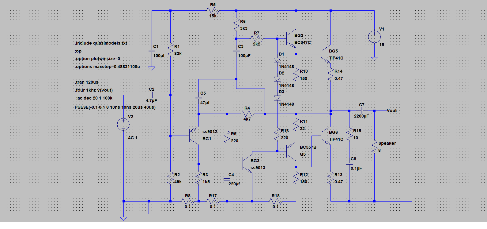

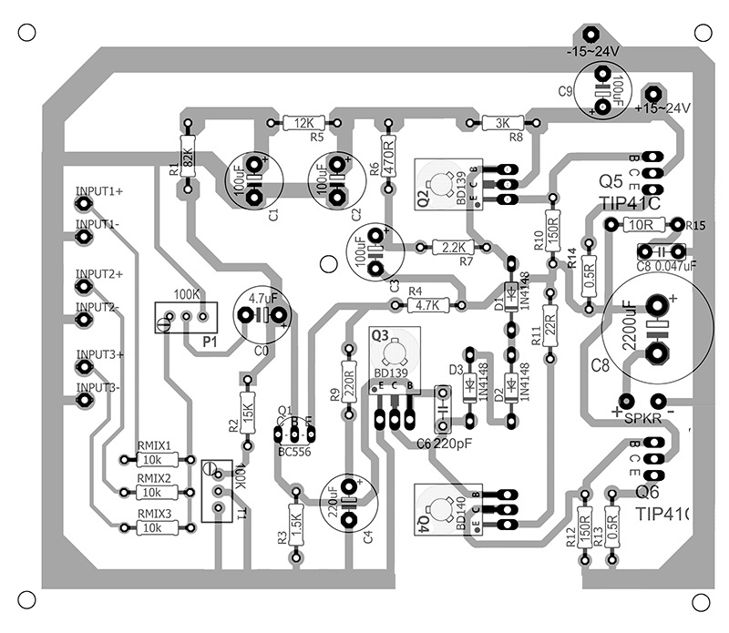

All done.... Speaker ground return, Boucherot Cell, R13 and R12 now return to PSU ground at the top of the board.

😎 that's a really neat board layout.
(There is one more 'refinement' that could be done although it would make minimal difference at the power levels involved here, and that is to take the NFB (negative feedback point) from the actual speaker output point (before the coupling cap of course).
Its the same problem... resistance of the print affecting things. The right hand end of R4 is the feedback take-off point and so only that one point is a correct 'copy' of the audio signal. Ideally the right hand end of R4 should be returned to the trace connecting to the pos end of the 2200uF.
Because of the low powers here it will make little difference but if you build more powerful designs then its something to consider.
Great work though

Thanks 🙂
If it will make no difference at these power levels, then I'll not bother, as I'd have to redesign as the trace connecting the Zobel's resistor to the collector of Q6. I could route that around the top of C8, through the middle of the speaker output pads, and that would leave me a path, but if there'd be no appreciable advantage, I'll call it done, but thanks for the heads up re: resistance.

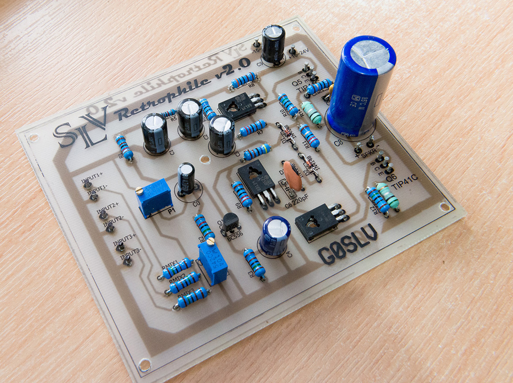

Built and tested the amp today. Works flawlessly, and sounds really, really nice! It sounds really warm in the mid range.. very retro... a whiff of the valve about it. So much so I've named it appropriately 🙂 Bass is really quite tight and transient.
Nice little amp!
The finals are on a separate heatsink (not included in shot). Seems a shame to hide it away in a box LOL

You're very welcome guys, and yes, that is a great looking board, one of the nicest I've seen actually. Those trusty old Veropins always come in handy 😀

That's a really neat looking board, pook. Do you plan to sell it?
I hadn't planned on doing, no. No one will ever see it again once it's inside the speaker enclosure... but every time I look at the speaker, I'll know what's inside it... so I gave it my best work. I just can't do half-assed.. it seems morally wrong LOL
