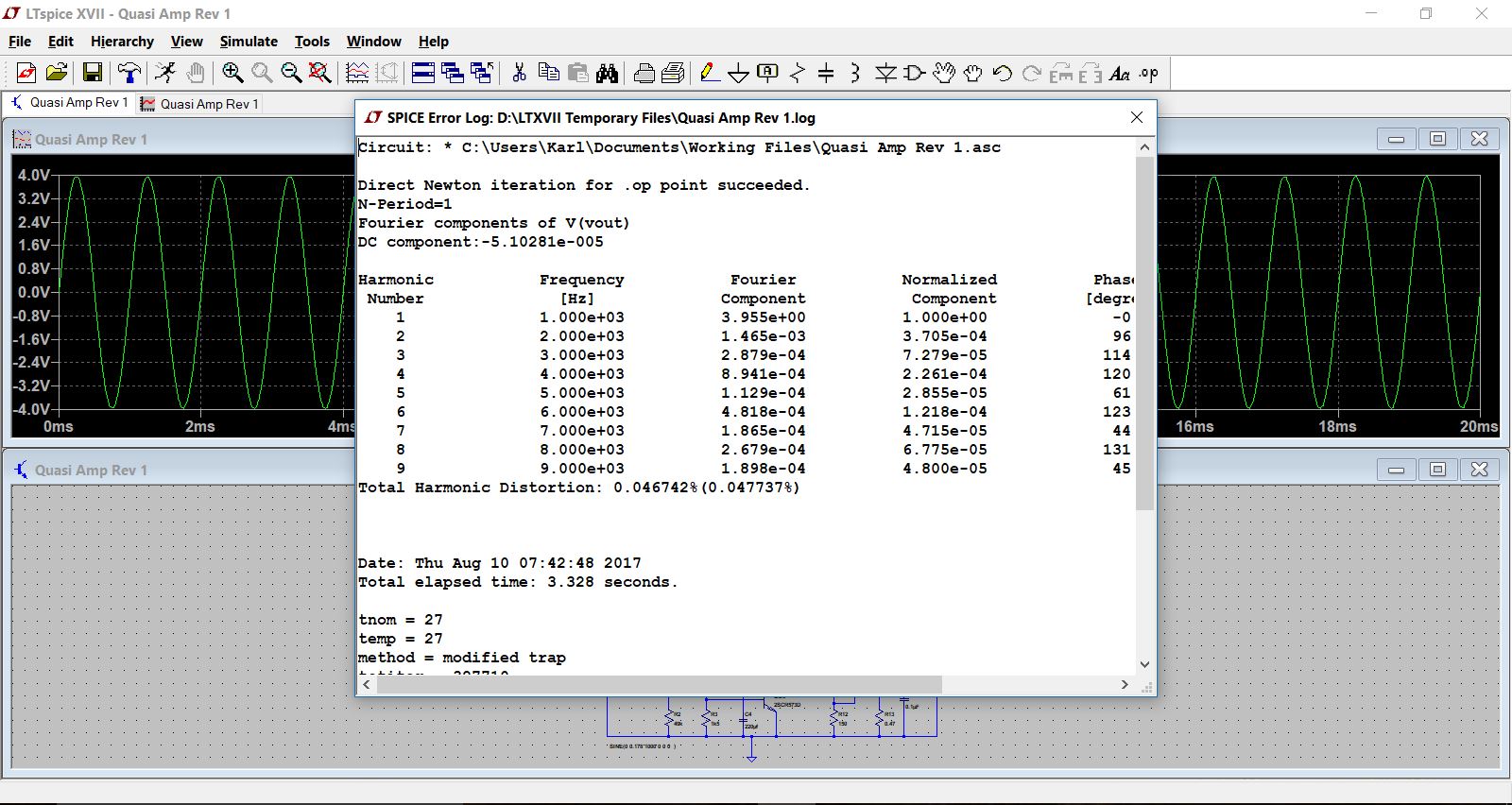

That BU406 BF parameter looks way too high. I used to use these transistors in line output stages and the current gain was very low
I wouldn't like to say how accurate all these models are. Here is a BU508
All these line output transistors have pretty dismal forward gain in reality, at least in the terms we think of for audio.
That said the simulation is fine with the 508 as well.

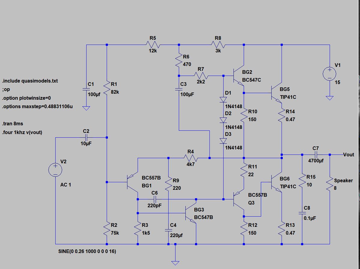

And when you power this (assuming its a normal power supply and not an SMPS) then use a 'bulb tester' in series with the mains. It can save a lot disappointment as it helps protect the output transistors from overload in the event of a construction error.
Also start with low bias which means having one and maybe two of those series diodes shorted out to begin with.

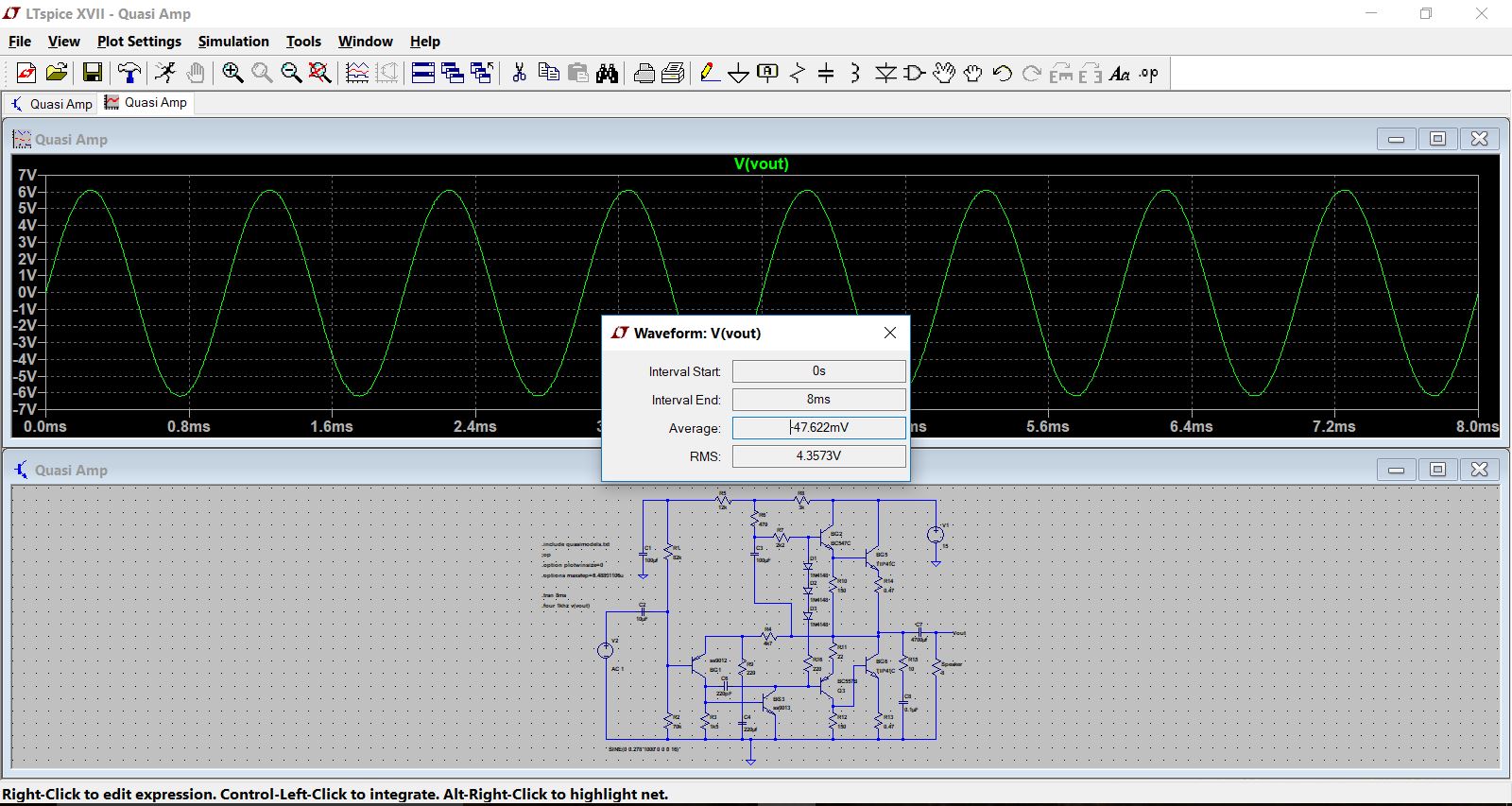

I'm not sure I'm using LTSpice correctly, but I'm getting the final output power at just over 4 watts.
Does this seem right to you?

The maximum power output depends on the supply voltage. A 15 volt supply can never deliver more than around 3 watts into 8 ohms.
(15/2)/√2 is 5.3 volts rms.
Watts = V squared/R so for 8 ohms that is 3.5 watts RMS. Knock a bit off for loses in the output stage and you are looking at around 3 watts RMS.

Yeah.. that's what I was thinking... I was expecting less than 4.
Cheers.
Will build in breadboard later this week and report back 🙂
Lets see what the simulation shows. This is right at the onset of clipping and we have 4.36 Vrms available across the 8 ohm load.
That works out to 2.36 Wrms. Guess I was over optimistic with the loses and wasn't accounting for the relatively high emitter resistors.
The good news is that you wouldn't really be able to tell a 2 watt amp from a 4 watt.

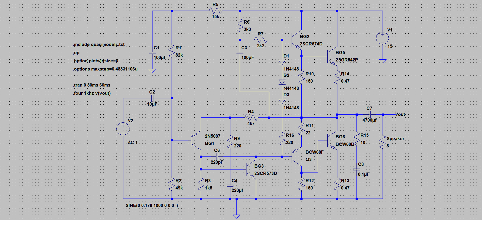

No specific reason, in LTspice for generic circuits like this you will find the models make little difference. I didn't mean to pick different, just me being to quick and not keeping it consistent.
I would really suggest you go with something like the BD131/BD132 for the drivers though.
Look at the totally random models (and in reality unsuitable ones) that I picked here. Does it work... yes.
(Transistors in LTspice never fail or burn a hole in your screen when overloaded 😉)
Well.. I built it. Sounds nice.
Not as powerful as I thought it would be though. I'm getting just under 3v at the speaker. The LTSpice sim suggested 6. The finals remain stone cold even at full chat... PSU cold... It's only a 1.5A PSU.
I'm using BC557/547s though.. not BD131/132s. CPC had none... discontinued apparently.
Oh well... it works 🙂
