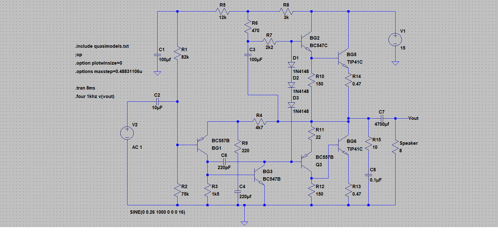

It's a low power amp I found on somewhere on the internet. Not much information about it, but it mentions being widely used in 80s for a range of tv audio amplifiers. It looked simple, and probably perfect for my needs.
I wanted to build a discreet amp, simple because I like building things. So many circuits found on the internet seem to not work though. As a beginner, I find it hard to spot problems with circuits as a schematic though. I'm trying to get to grips with LTSpice, but I'm not quite there with that yet.
I've included the schematic in this post.

The schematic says 9012 and 9013... I just assumed 2SCxxxx
The BU406 as an output looks odd. BU devices are typically high voltage and low gain and have their origins in TV line output stages. Something like a TIP41 would make much more sense.
The drivers are non critical and given the low supply pretty much anything would work. BD131 and BD132 come to mind as good general purpose devices for experimenting with.

It looks a very workable and forgiving circuit. The only thing I would beware of is the fixed bias arrangement... perhaps initially power it up with one of the three diodes shorted to further reduce current.

Actually, and just studying the circuit in more detail I can see one possible error. R9 is way to small at 10 ohms. The gain of the circuit is set by the ratio of R4 to R9 and 10 ohms is way to small. Something like a 150 or 180 ohm would be suitable. C4 could do with being a little larger as it sets a low frequency roll off point for the feedback network. 220uF or 470uF should be OK there.
The basic circuit will work though... its a classic arrangement.

The BU406/7 has an average hfe of only 7!
The 2SC9012 is now known as a KTC9012 as is the 9013 and are readily available.
As Mooly stated, I would also go for the Tip range of output transistors as the BU406 will not amplify the current required to let the 2SC9012/3 work properly.

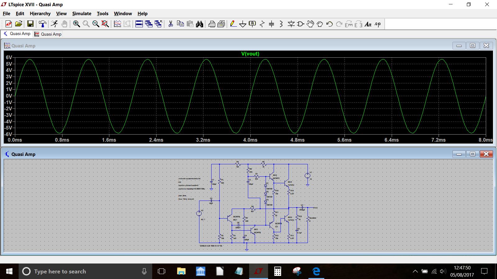

I'll throw a simulation of it together.

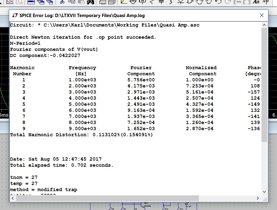

Here you go. The asc file and TIP41C model is attached so you can have a play in LT.
Edit... if you have a play with this then take a look at the standing DC current in the output stage with the TIP41C models. Now try changing those to the standard 2N3055 and recheck. You can also try altering the 220 ohm (R9) and seeing the effect on the gain. R2 at 75k in my diagram is really the combined value of the 15k plus the pot value needed to get symmetrical clipping.
I've also added the BD131/132 and S9012 and 9013 models to the list. Be sure to enter them as written in the text document, for example the 9013 is ss9013
