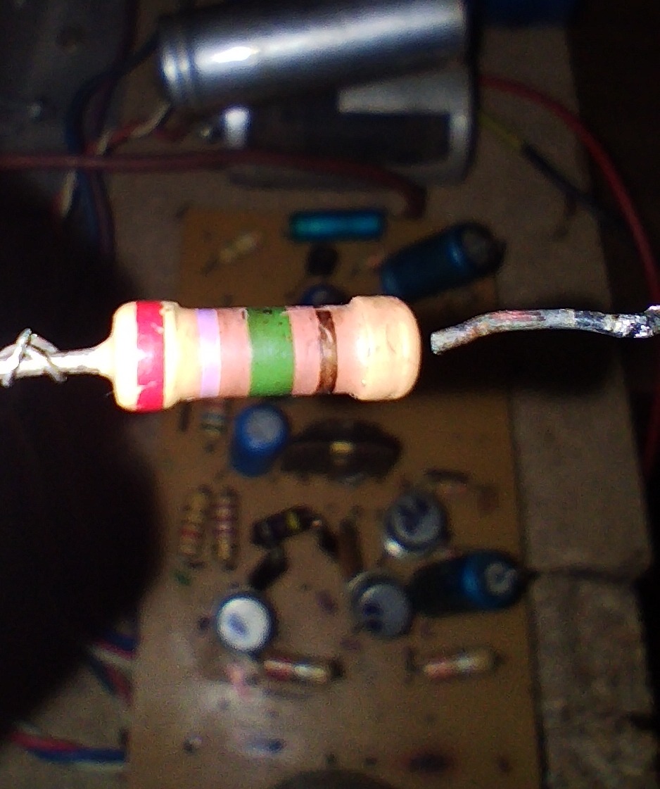

question is when i replace two resistors that are needed. should i connect both 2n3055 at once or one by one t osee how it works ?
Connect both. Make sure you solder the correct wire to the correct pins. Third wire goes to the metal L-profiles.
Again test first with a bulb. If all is well, you should have enough power for a small party.
After that you can leave out the bulb circuit.
My guess has always been that these are emitter resistors. Its' very difficult to see from the pictures.
Anyway, they are there for a reason. They only way to know if they are bad is to desolder the coil around them and to measure their resistance.
If they are indeed emitter resistors, they are there to stabilize the idle current through the output transistors. If you would bypass them, you would have to reset the idle current, and you would have the risk of thermal runaway and destruction of the output transistors. So, better be patient 😉
Reactions: sg97
btw for ones that are interested xdd here are what are those resistors. one on right was 2.7M Ohms 1% second one is too burned to read the colors. wires dont measure anything, resistors measure like sometimes 300k sometimes 600 or more i am not sure why
other one i cant tell but this one is like that
