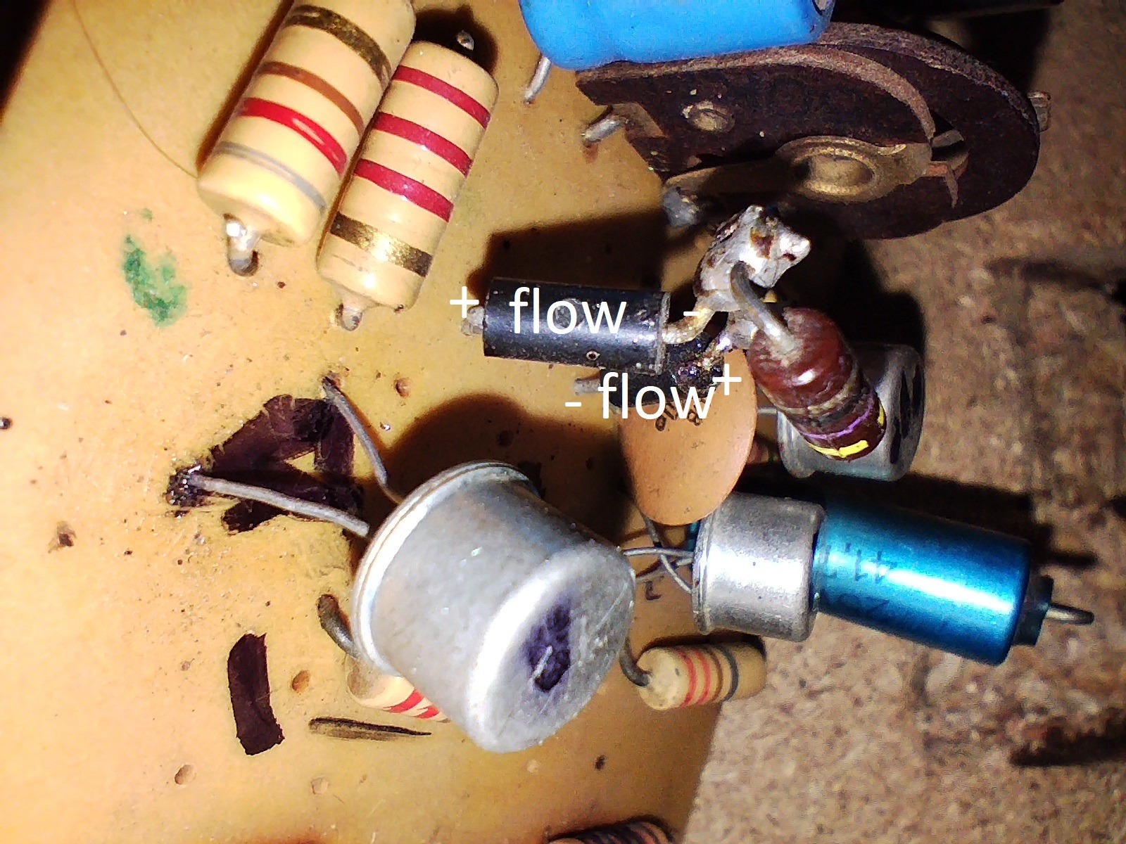

transistor amp not working after shorting output

Testing a component out of circuit requires desoldering it. Desoldering components from PCB that are not damaged can pull the lands off the boards. It can also break leads off the component. I've done both. The forwards-backwards diode test on b-e and b-c can determine some of which ones are bad quickly. sg97 has already determined both 2n3055 are bad. Likely one or both driver transistors are too. Those tests are to be done.
After the absolute trash is gone, powering up through a light bulb, one can measure Vce on the transistors to determine which other ones are bad. <1 volt is bad. B-E <.6 volts is bad. Or find bad resistors, or find bad solder joints. This pcb has apparently been soldered by an amateur, which can cause bad solder joints.

i found out that this is 46 ohm on top of two reversed diodes wtff
Probably good, that 23, but measure them the same way you did with the big ones.
