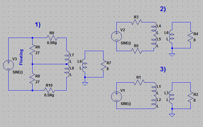

Test Setup
Hi, esltransformer,
1) What test setup do you use to test frequency response of push-pull (not SE) output transformers?
Menno van der Veen recommends setup #1, which somewhat resembles real world conditions. However, much simpler setup #2 and #3 produces very similar results (I tried all 3 just to be sure). I would be glad to know your experience.

The purpose of my few scribbles is to illustrate the point that the OP numbers are totally possible
Conclusion: As I said before, a lower primary impedance make things easier and the open poster did a superb design with its OPT, and you are only capable to criticize them.
