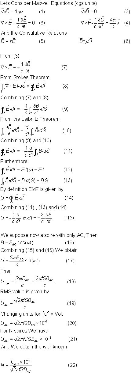

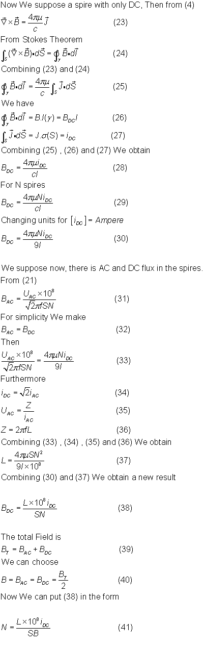

I am not sure about your numbers. Even without considering that pretty small loss, what is the Bmax (AC + DC) you get for 30W at 18Hz with 120 mA DC current and 30H minimum (i.e. with 10 Gauss AC)? Although the C core has an advantage respect to E+I in terms of size for the same specs the difference is not like between night and day.
The biggest core I consider acceptable is the EI 150/70 (i.e. 50x70 core size) and this would not be enough! 50x75 would be the minimum to achieve 30W at 18Hz with 120 mA DC current at my usual Bmax = 7500 G. So I would need to accept higher B at that frequency for 30W (and thus more distortion because in less linear area). A 50x70 core alone weights about 8.5Kg!!! For a reasonably sized transformer those numbers are impossible. Specifying max power at 30Hz is more than enough for SE OT, provided that will work not so close to saturation (7500 Gauss total induction limit for E+I and a bit higher for C cores). Together with an inductance that gives a ratio between reactance at 30Hz (i.e. 2*pi*f*L) and equivalent resistance (i.e. the plate resistance in parallel to the nominal primary load) equal to 8 it will already guarantee low distortion at least down to 30Hz. Of course the higher the better but practicality cannot be ignored at some point..... what's the point of having a huge transformer to get those numbers down to 20Hz rather than 30?
I don't know amplifier details, but the OP claims
Zp=3500 Ω Zs=8 Ω ip=120 mA fo=18 Hz W=30 W
Supposing a more common lamination like EI155 (EI114 for eu), and your suggested Bmax=1.3T, using Eq.(41)
Np≈3836
Using
W=Ep^2/Zp
For 30 W
Ep≈324 VRMS
Using Eq.(22)
Np≈4316
Then we can increase current up to ip=135 mA, easy with current density of 3 A/mm^2, and not so big transformer. 😉
It is easy to write down numbers without an idea of what will happen in real operative conditions! The inductance as function of B? The distortion? The power loss? Frequency response? Sorry...too many turns and sky high current density. Your design would be really poor for hifi standards!
I agree, but with that particular arrangement, see Eq.(40), magnetic hysteresis curve become thinner and more linear, and then reduces loss.
As a physicist you would already know it. 😉
Inductance was chosen to obtain a 18 Hz roll off, 30 H as you correctly suggested.
Too many turns? Probably, but if clever interleaved, you could obtain a very good FR.
Is 3 A/mm^2 a sky high current density? Probably, but with 0.25 mm wire, losses are pretty low.
BTW, what current density do you use, or Tango, or your favorite transformer?
The purpose of my few scribbles is to illustrate the point that the OP numbers are totally possible, I can't to design a Hi-Fi OPT in just ten minutes, and if I could it, it would be a commercial secret. 😀
I think your Bmax of 1.3T is too high for a core carrying D.C. The excursion at low frequencies will distort. As a rule I use half which would be 0.65T.
John
John
John
Me too, 1.3 T is a lot, so I took 0.65 T for Bmax(AC) and 0.65 T for Bmax(DC) for calculations, if you look Eq.(40) in attachment, is difficult to make my own notation consistent with other posters notation.
Yes I know as I know there is copper loss as well! Have you calculated it? And transformer insertion loss is usually referred to 1KHz.I agree, but with that particular arrangement, see Eq.(40), magnetic hysteresis curve become thinner and more linear, and then reduces loss.
Probably? This is funny.Inductance was chosen to obtain a 18 Hz roll off, 30 H as you correctly suggested.
I didn't want to be unkind with you but I don't think you can put over 4000 turns into that core using 0.25 wire size. Even if you use the lower insulation type (0.285 mm) you wont be left with any useful space for the secondary once you also add in the insulation between primaries and secondaries!
Try to do it and you will see by yourself if that is possible even not considering HiFi requirements! Once you know it doesn't take ages...The purpose of my few scribbles is to illustrate the point that the OP numbers are totally possible, I can't to design a Hi-Fi OPT in just ten minutes, and if I would it, it would be a commercial secret. 😀
