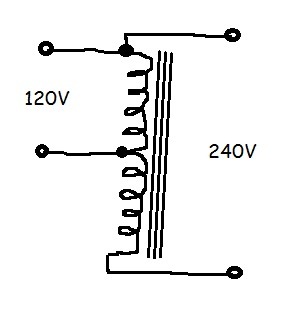

Ok I've moved on (I'm the original poster). This thread has gone down a couple or rabbit holes and gotten in the ditch a time or two. 3 phase power was never the subject and is not related to my question. Single phase power is only sort of 1 leg of 3 phase power (did I mention that I'm an engineering manager at an electric utility?). The "2 phase 120" is not just 2 phases of a 3 phase system as that would be nominally 208 since they would be 120 out of phase rather than 180. Here is where we could discuss Y and Delta transformers, but we won't.

I'm continuing to happily listen to music on my amp plugged into 240ish volts achieved by putting the red leg and the black leg of my home electrical system into a standard 3 pin 220 outlet (no neutral needed for European equipment--oh my, we hadn't even discussed the neutral).

A 3-phase wYe system tapped to give 120V each leg will give 208V between the hot ends of two legs. Root 3.

Another update. I finally did receive a 5000W transformer that put out actual European voltages (0, 240V). I ran the amplifier on it for a few hours to confirm there was no difference. I monitored the heat generation and it was the same. I was surprised that I could not tell any difference in the sound. I also monitored current. I was very surprised that current in the line approximately doubled. My amp is 400w load (not output) and with the transformer in the line the load doubled to 800W. The transformer also had an annoying hum--the bigger a transformer gets the more likely it is to hum. Transformer is now gone back and I'm glad the amp works fine on US voltages. --Jerry
Did you measured how much transformer consumed without load ,without amplifier ?My amp is 400w load (not output) and with the transformer in the line the load doubled to 800W.
No, I didn't measure that. I thought about that after I boxed it up but didn't want to unbox it. However the transformer didn't heat up much sitting there plugged in so without load, I think it was not a load itself. But I didn't leave it plugged in and turned on for an extended time.
Sometimes transformers are wound with increased magnetic field , reduced turns count ,increased hum and heat ... In example microwave oven transformers are so ugly ,eating 200W with no load ,even with secondary winding removed .It have about 600-1000w output high voltage ,but if rewound it properly ,according core size ,using calculations ,can output only 70-150W ... Huge difference at cost of complete efficiency loss . Maybe yours 5000w was made using similar strategy ,so i didn't wonder if 400w load doubled - its very possible that it consumes another 400w for core magnetisation ,and for 5000w those 400w is less than 10% loss ,so overall it may have even 90% efficiency .But not for so small loads like yours .
