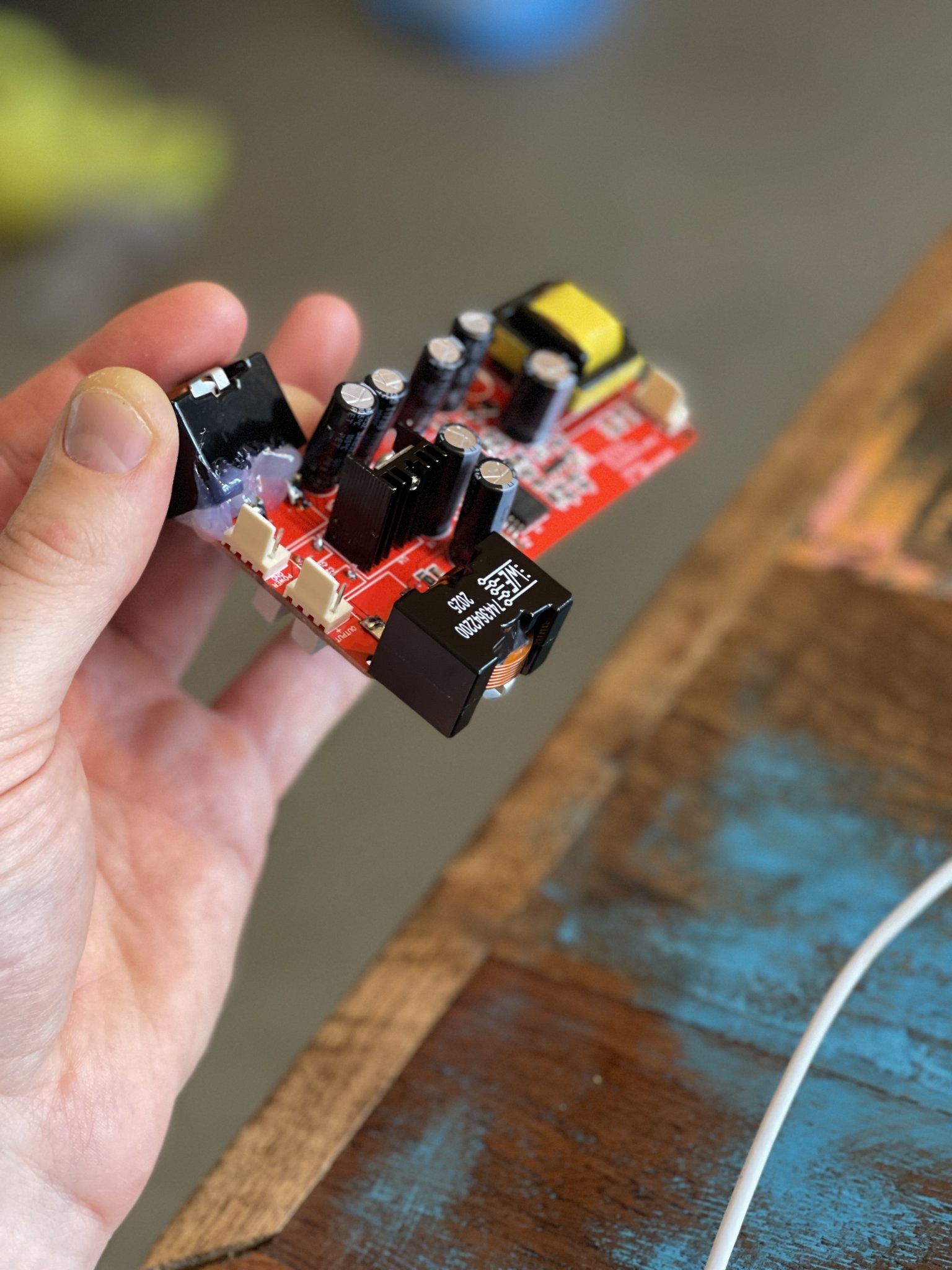

I thought it wise to explain my journey with Richards TDA8932 boards, so others could enjoy the adventure too;
Shipping
Firsts first, ordering and shipping was much faster than expected, kudos. Buying from the UK to EU is more troublesome these days, that's a story for another time!
Quality
The boards are very well made and robust. That has been proven with several swaps on the pads in some positions, without issue, except one small piece of inductor pad, but that was my bad for knocking it off the draws that the stereo gear sits on, and the pad was still easily usable with the amount left.
The presoldered SMD parts is good with no reason to reflow anything.
Sound, stock
The sound out the box is excellent, really well balanced, great bass, sweet twinkling highs, midrange is great, rich but crystalline. Fast but bloomy.
The soundstage is where these little gems shine, super wide, the accuracy and pinpoint suspended elements to the music are fantastic and some of the best I have had in my system. Depth is good too. As others have mentioned, very musical. Really quiet too.
But still I missed a little detail from some of my other amps.
Using a Chinese LPS giving 24v 2A.
Modifications

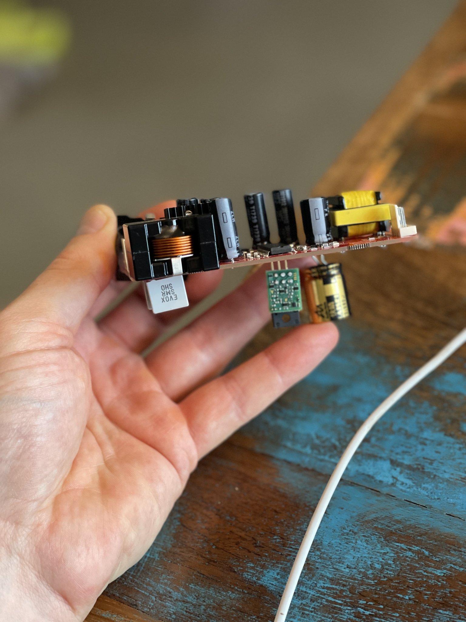

I first ordered better quality regs for U3. U4 is a better reg in stock form so I thought I would give it a twirl only for U3, at least that was the plan.
2x Sparkos SS1117XX with 21.5v output was ordered, same pinouts, easy to swap out, only to install on the underside because the Sparkos are a little more cumbersome than the 317.
To install the Sparkos you must short the diodes U3 - D2, D3 & remove R15. U4 - D5, D4 & remove R16. Please correct if this can be improved upon Richard.
This took the noise floor to zero, I mean absolute 0. That will be one reason why these boards sound even better with these regs in. The soundstage became utterly 3D, the midrange richer, the highs sweeter, the bass thunderous when required and delicate when needed. Refinement I would say was a good some up, far more natural and palpable.
Then the inductors were the next to go, this is a common upgrade path for class D amps at the output, naturally.
The stock inductors, are quite ok, I swapped out the stock for some 4.9A Wurth, there was no difference in sound, I chose those because I was recommended the large 28A Wurth but could not order them at the time.
But then curiosity and availability crossed paths, the 7443642200 Wurth inductors were bought and brought more magic to the soundstage and bass, especially the sub bass. Well worth €30. Pain in the a*s to install, basically one side fits fine but the other needs to be flipped to follow the same polarity, there might not be a huge difference with this but I decided to employ this setup just to be sure. Glue used to clamp to board.
Changed the output caps to 1uf SMR and quite liked the change, the feeling was better detail.
Added a 470uf AN Kaisei cap and thought I liked what I heard, there was certainly no down side to adding it, for future - unnecessary.
These mods will make your board look like an IED from madmax, messy stuff, but the solution to that is coming.
