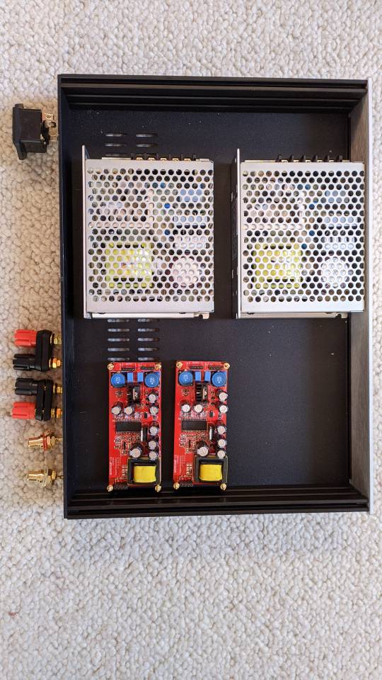

Wow - those power supplies rather dwarf the amps. Are they Meanwells?
I started out using a Meanwell (after graduating from my bench supplies) but for a boxed up amp I'd veer towards an open PCB design like this : 24V3A????? 24V70W?????? AC-DC???? 110/220?24-???
Meanwell supplies will certainly have safety and EMC certification, can't say anything with confidence about PCBs from Taobao though. Just this one is far from being the cheapest and isn't filled up with white gunk so at least the parts used are clearly visible.

Hi Richard, I agree, they dwarf the amps 🙂. They are 3.5 A Meanwells; they are from a company, which deals with sent back items and I paid 6 € for one.
