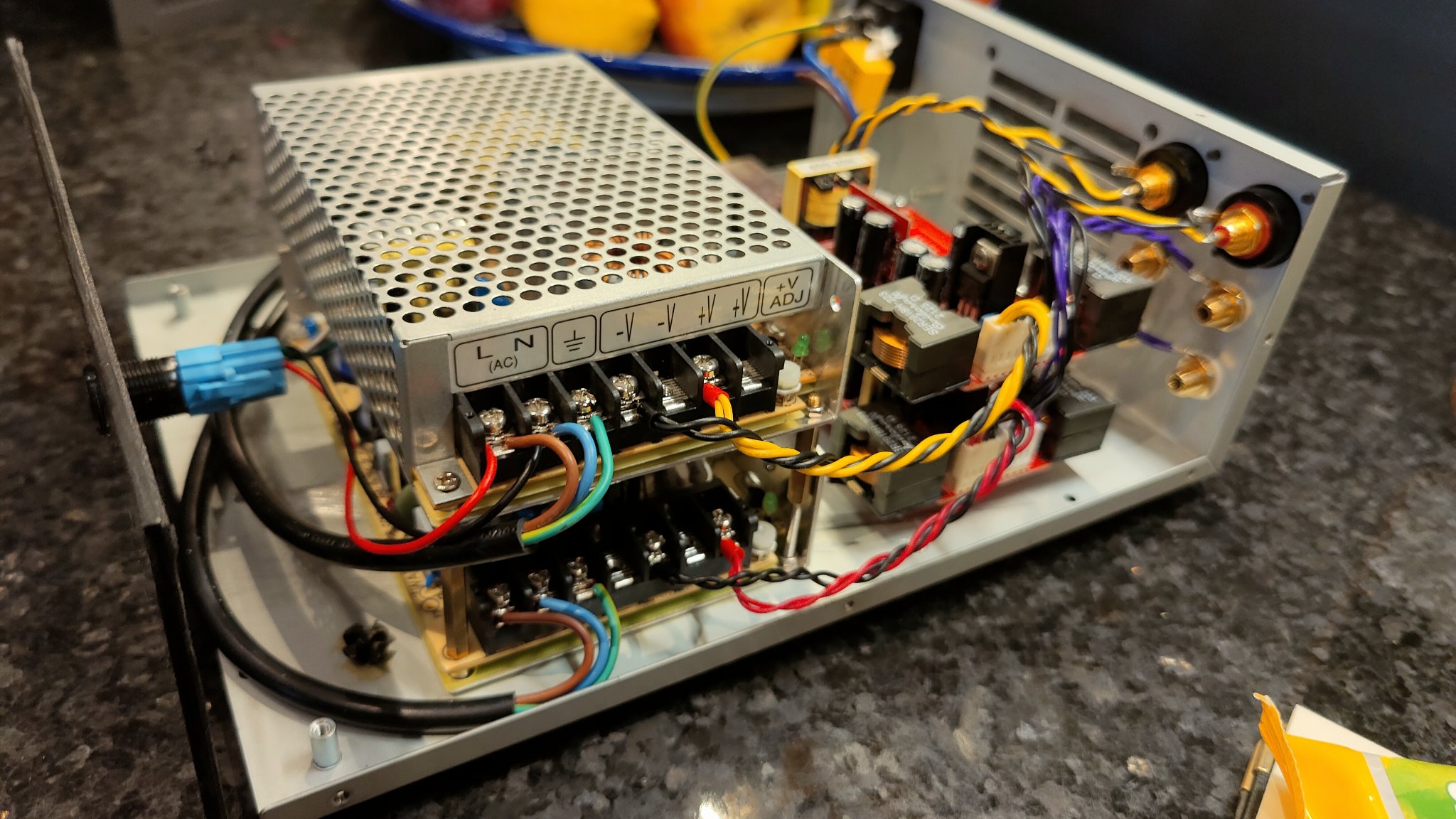

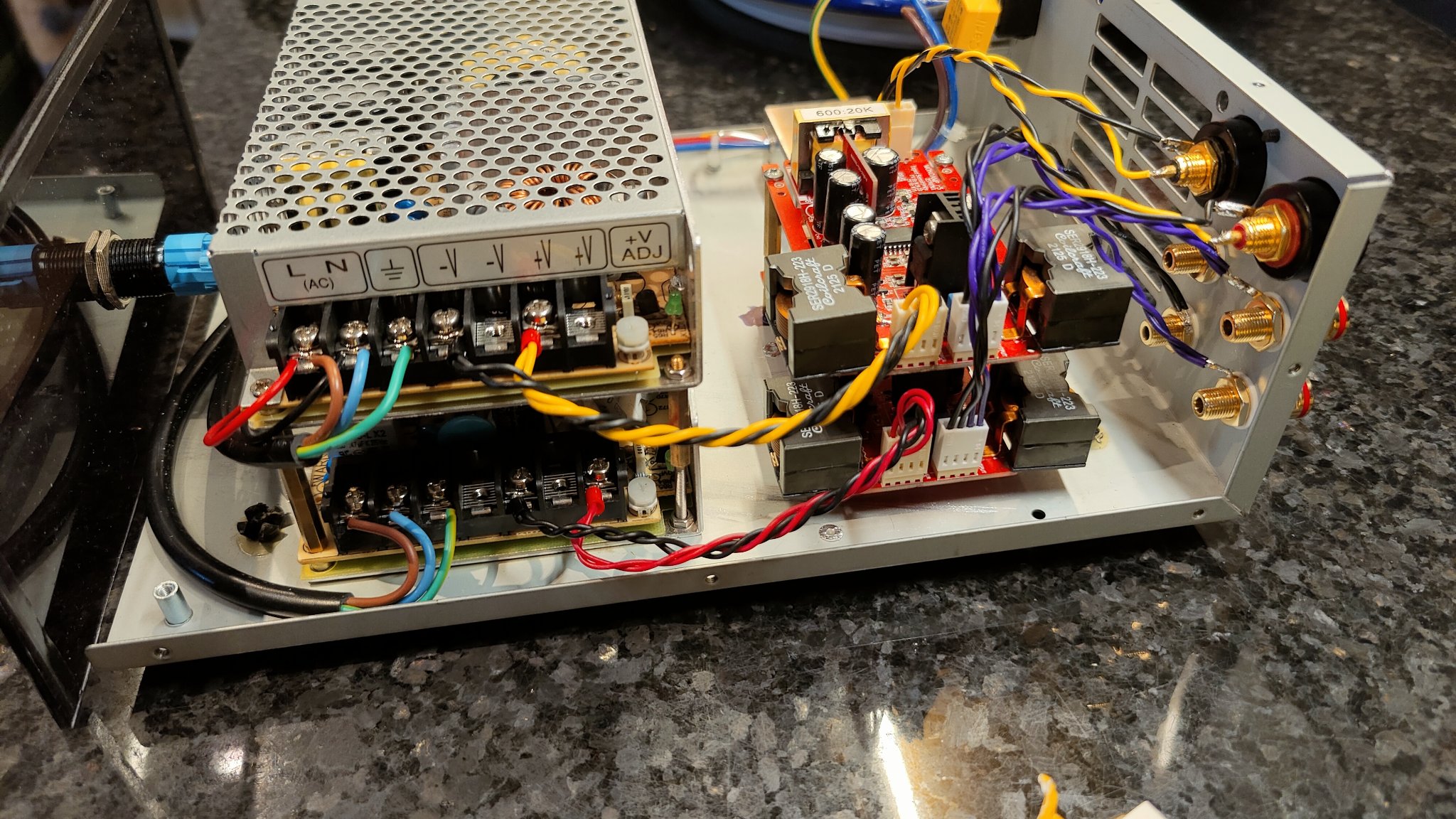

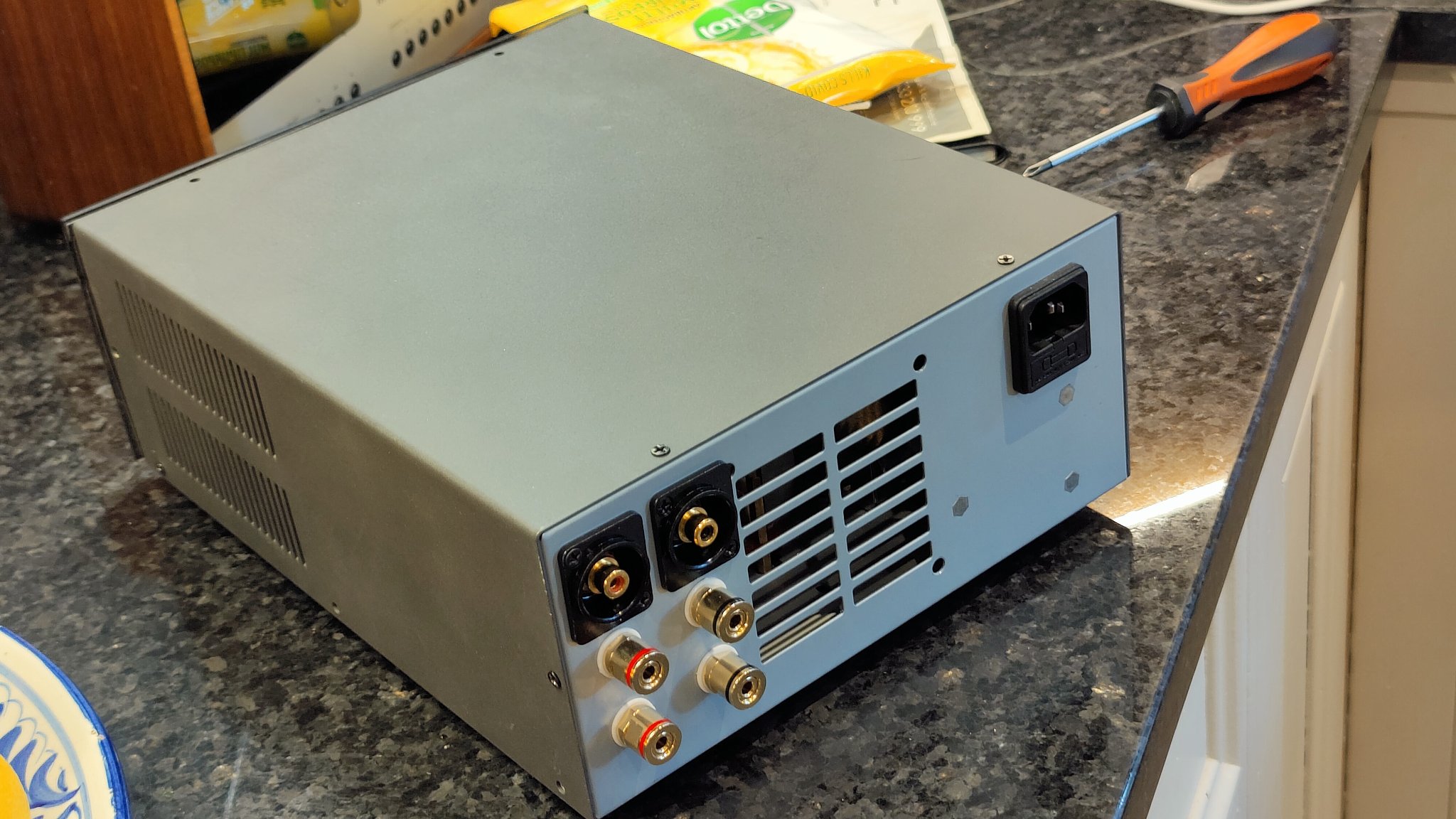

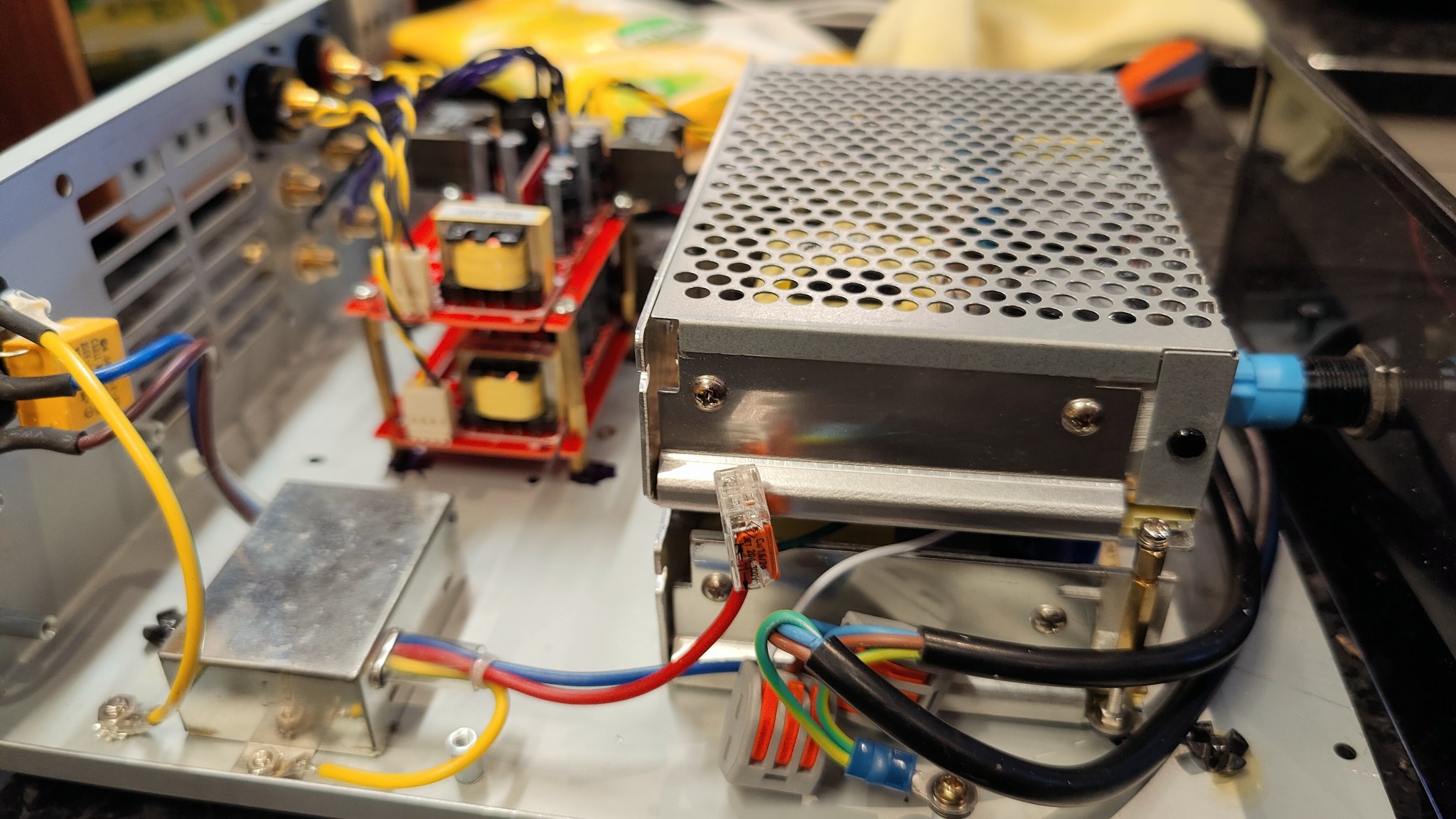

Been a while since I had mine in system but got them wrapped up in a chassis....finally. Not balanced input yet. That comes when I eventually get sorted with my active XO biamp set up.
Running a Meanwell LRS 100-24 per channel. No addition SMPS filtering as of yet.

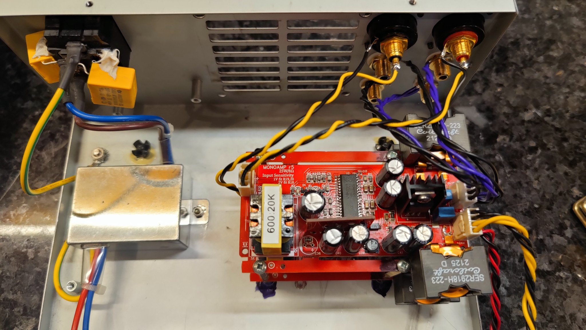

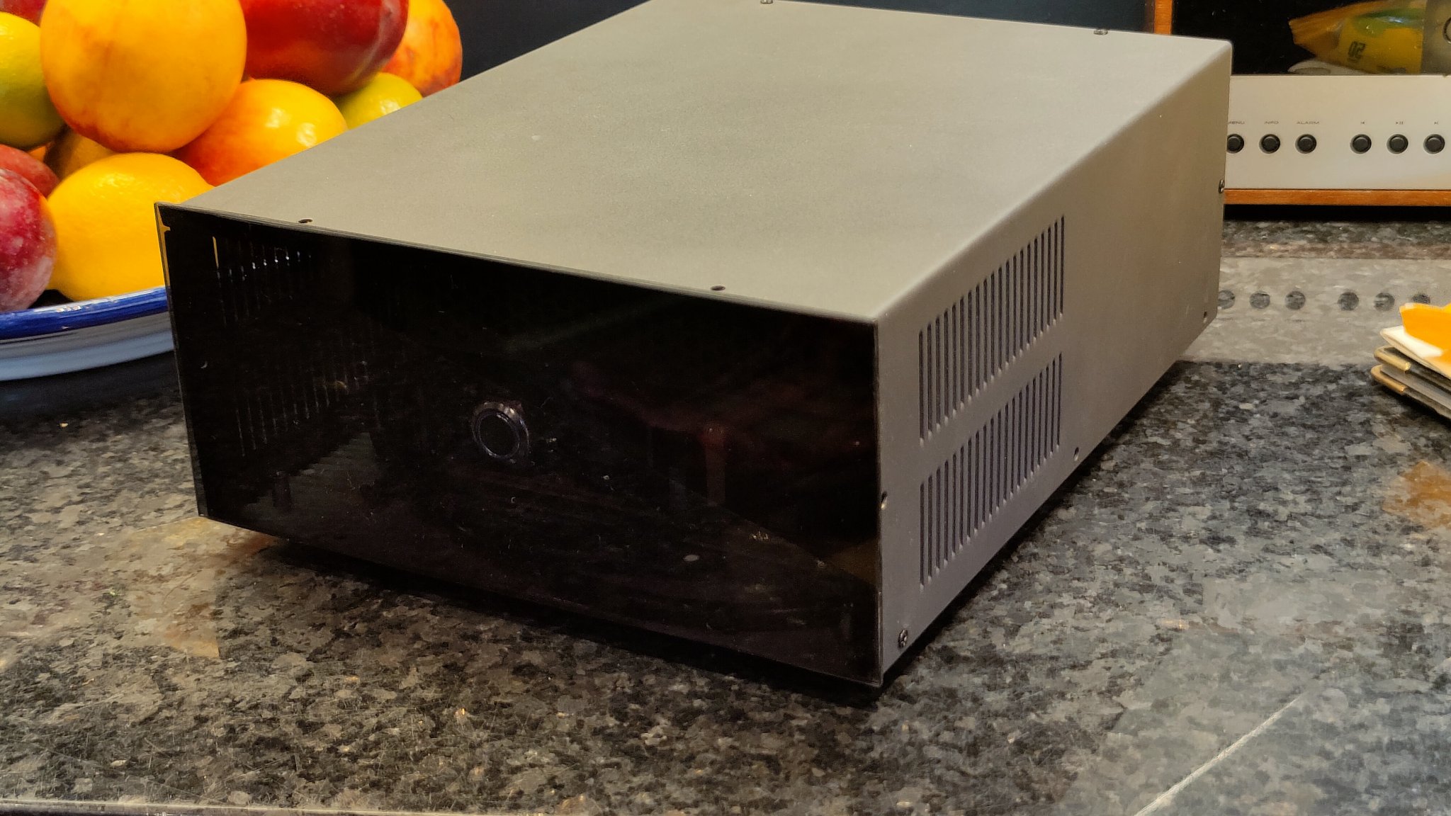

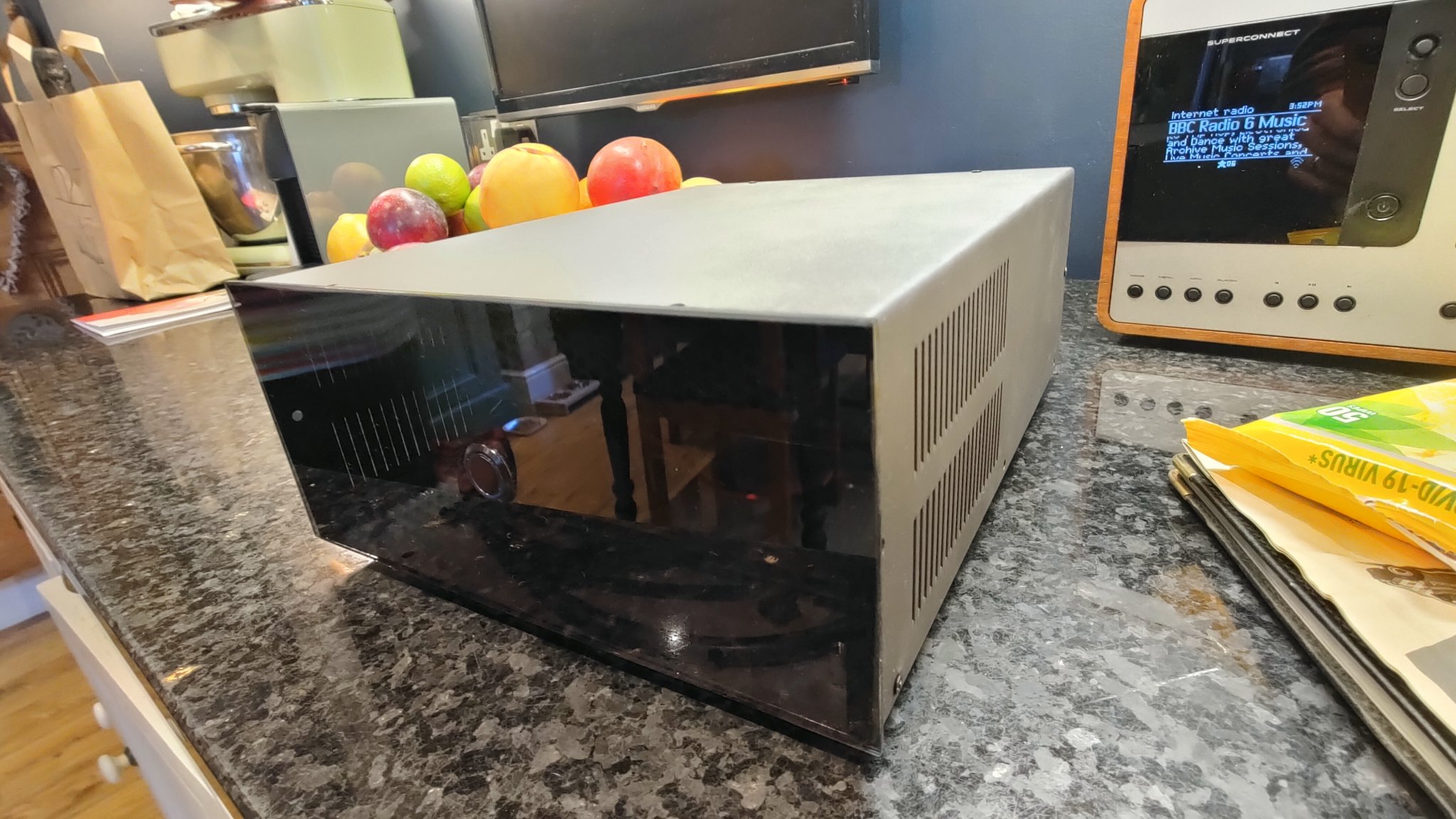

Its just an old bench SMPS chassis. Repainted the cover I'm VHT anthracite and a plexiglass front.
And forgetting to say after jogging my memory reading the 1st post again....this is with a DC coupled pre amp and no output caps in my dac output stage, but it's all trimmed down to probably less than 10mV so all seems to be working well.
The new to come input buffer will potentially have 3.3uf on the output of that
