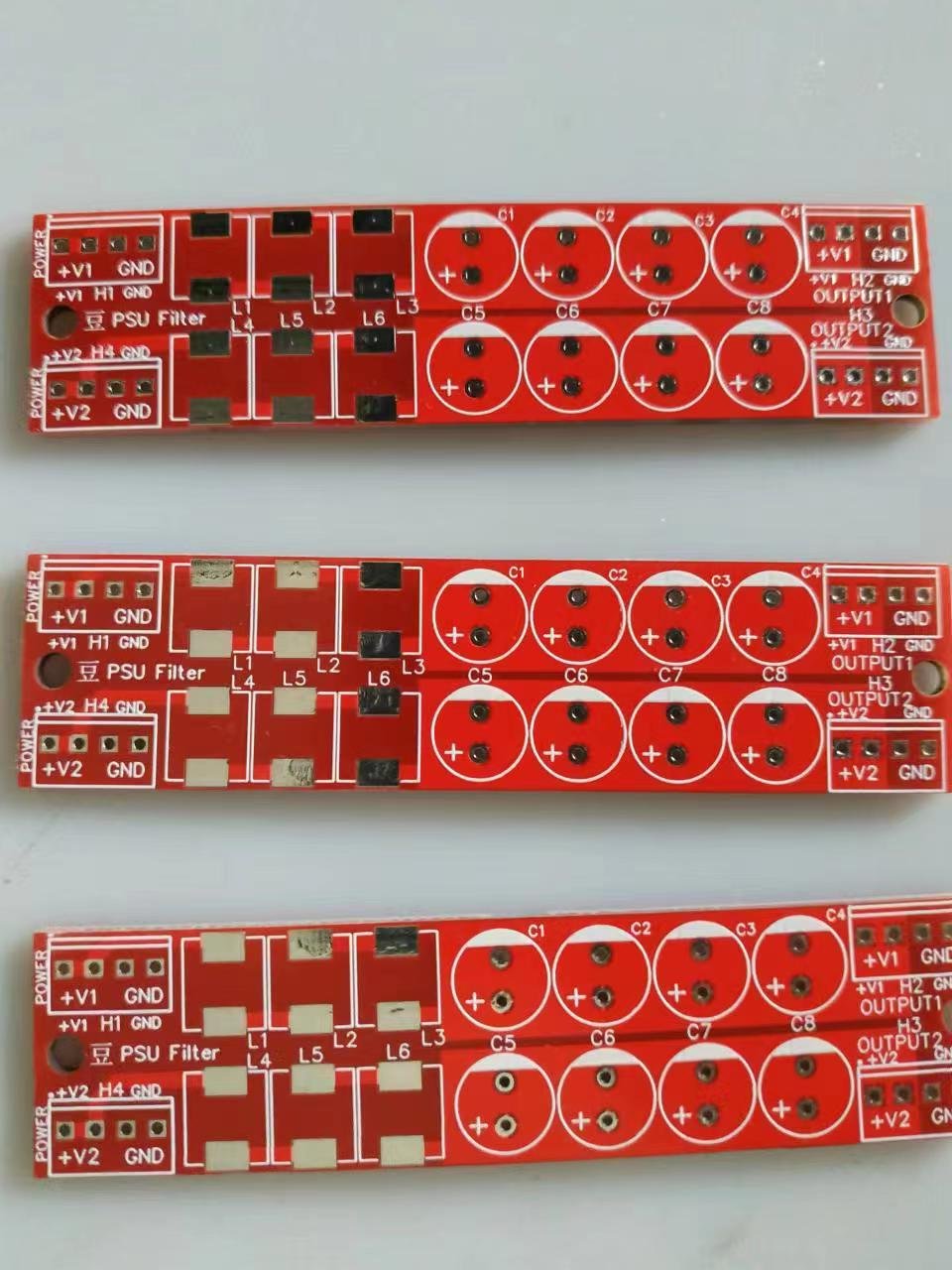

An LC filter is what I use when I need to clean up a switching PSU's output. I happen to have PCBs for it too -
