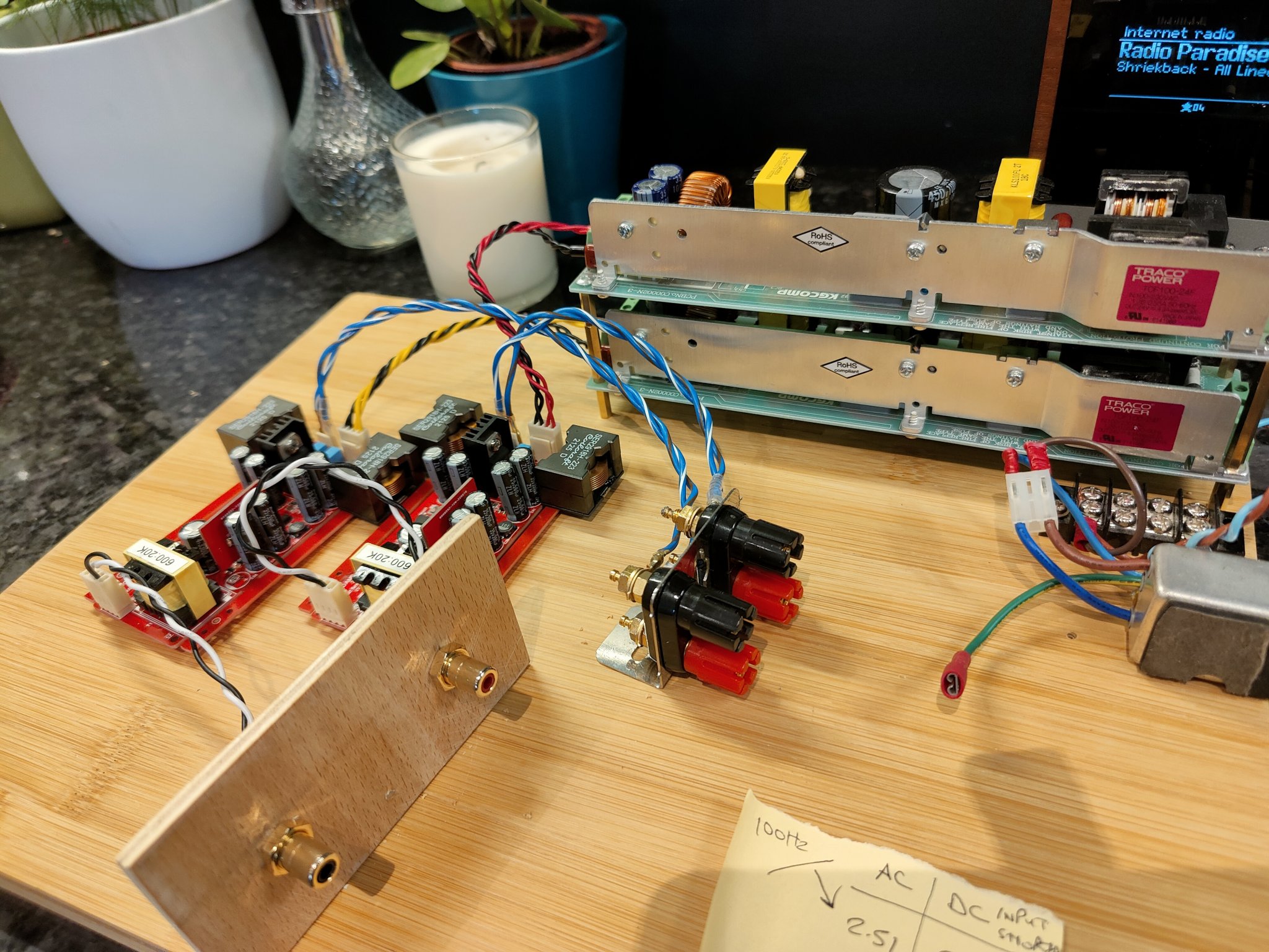

So got it on the bench....well the kitchen worktop. I played with my scope this afternoon.... learnt quite a bit. This SMPS is very low ripple. On the ACA with steady class A load of 1,5A it had about 15mv P-P and about 6mv of load. It makes a PwM noise with low or no load and it does this with the MonoAmps. Must be be much ripple going on . Haven't got the MJ filters in yet .
A few cursory measurements and I seem to have a lot more output on one channel. Fed 100Hz from my phone at full throttle, I have about 1,2v AC from one and 2.5 on the other.
What should I be looking for?
Dc seems good with shorted inputs I have 3.1mv and 7.5mv

I seem to have a 'connection' between output POS and NEG on the channel with high output. Did a simple beep test and got a buzz over the speaker outs. I measure between 3 and 5ohms over the outputs +/-. Only when powered up...
Edit...that's a red herring. The 'high' channel is ok. The low one isn't right. Tried with music and a cheap speaker. Maybe my inductor track fix isn't so good afterall...it is on that channel. Although resistances are equal on both PBTL sides
Seeing as one channel is roughly half of the other one then I'd be looking at the possibility that one half of the bridge on the 'low' channel isn't working somehow. Measuring the outputs relative to GND with a meter would show which but on AC Volts you might need a cap in series with your meter as DMMs generally don't much like DC superimposed on AC.
Thanks Richard, that was my thinking .GNDPWR or GNDA, does it matter? Assuming 'A' but I'm just wondering which GND will be easiest to probe.
No, it won't matter which GND you choose. Find one which won't cause a short if your probe slips.
I'll have a prod about when I can! Are the amp ICs ok with no load? I know some class D (3118?) can pop if there isn't a speaker or test load applied.
I've so far not had any problem when running them with no load attached. But then I don't put signals in normally without a load. You're keeping the amplitude small (1.25VRMS each side) I trust so that should be fine. I think the problem comes if the amp's asked to put out ultrasonics near the resonant frequency of the filter - then it looks like a short circuit.
So that was easy. Fed an arbitrary level of signal I had 52mv on 3 of the 4 outputs (stereo) but one on the bad board was well low. Was a dry joint on the big Coilcrafts. Playing music now on the main system. Yay!
Observations were I couldn't measure anything on the output resistors R13 and R14 and nothing on the input of L1/L2. I could only measure the AC signal on the out side of the coils. Is this due to the DC you mentioned and after the L the signal can 'see' the output caps and so my meter can give me a reading.?
