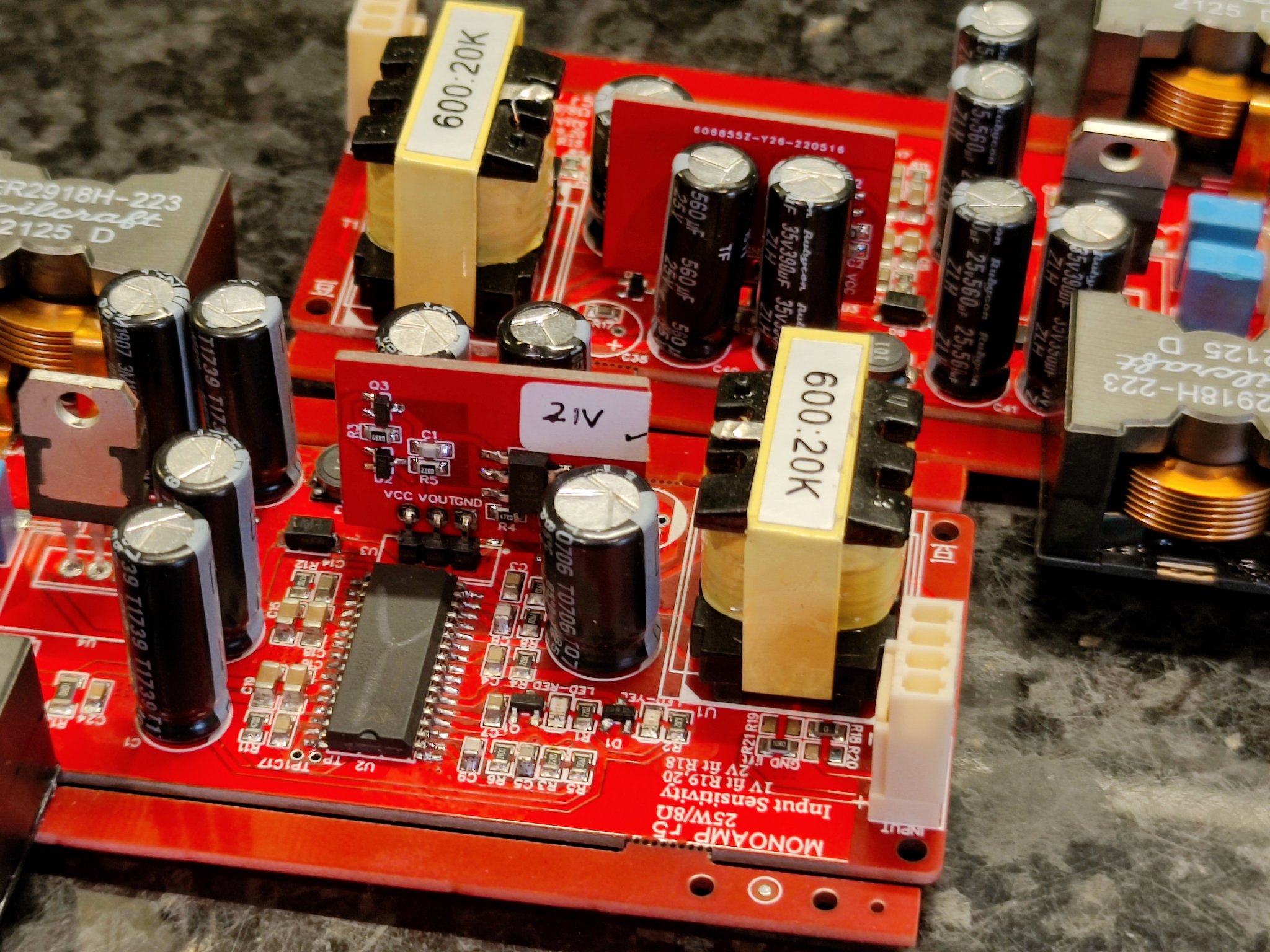

Mounted the Lm317 on the sockets so they could easily be replaced with an off board regulator. Was looking at the LT3042 board on AE, but is the 200ma limit too small? Also would long lead wires increase the inductance to the chip supply negatively ?
The 200mA limit would be fine in this application, only the TDA8932's signal stages are fed from this regulator, the typical current is 40mA or so, max 50mA. Yes long wires will increase inductance (and DCR) so shorter is better. There is a cap nearby though.
In substituting a reg its important to pay attention to the output voltage - if this goes higher than the power stage rail, the protection diode will conduct and that'll current limit the regulator when music is playing. So better to set the signal rail voltage a little bit lower than the power rail voltage (typically that's around 21V).

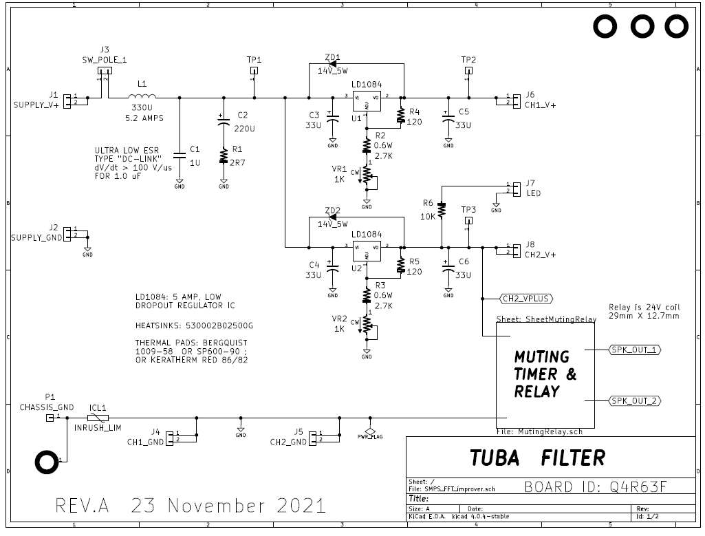

Recently stumbled on another of Mark Johnson's designs. I saw his low current SMPS filter on angchuck's build.
Here he has a regulated higher current affair that uses comparable regs to U4.
It has a 2v drop.
Though it interesting enough to share.

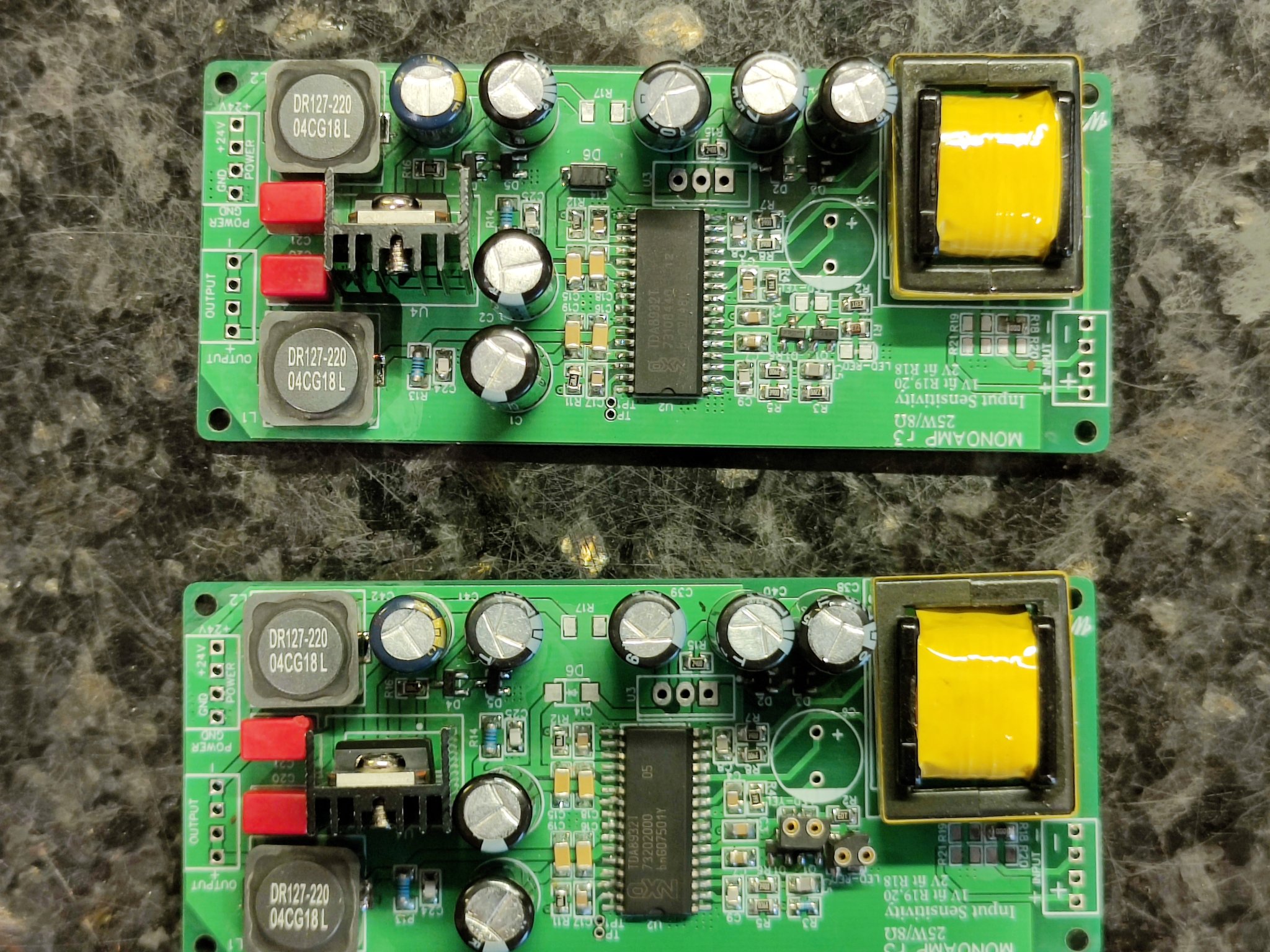

Richard would you be in a position to sell SMD pre populated rev5 boards as per your pic above?
You mean minus all the other parts in the kit? I'm sure we can work out a price for that, so long as you don't need a BOM for all the missing parts.
Yes just as is in that photo. BOM not required! Would save me a chunk of time on SMD assembly as id really like to listen to this amp!

Jim - C38 isn't fitted when you're soldering R17 in. C40 is. I've updated the build guide (thanks to wifey for the artwork) in the first post now, it's based on r5.
Oh I forgot - when using a shunt you also need to remove R15. If not, it'll smoke and remove itself from the circuit.
I managed to remove the R15s fairly easily, a bit tight when the shunts and caps are in place but no harm done.

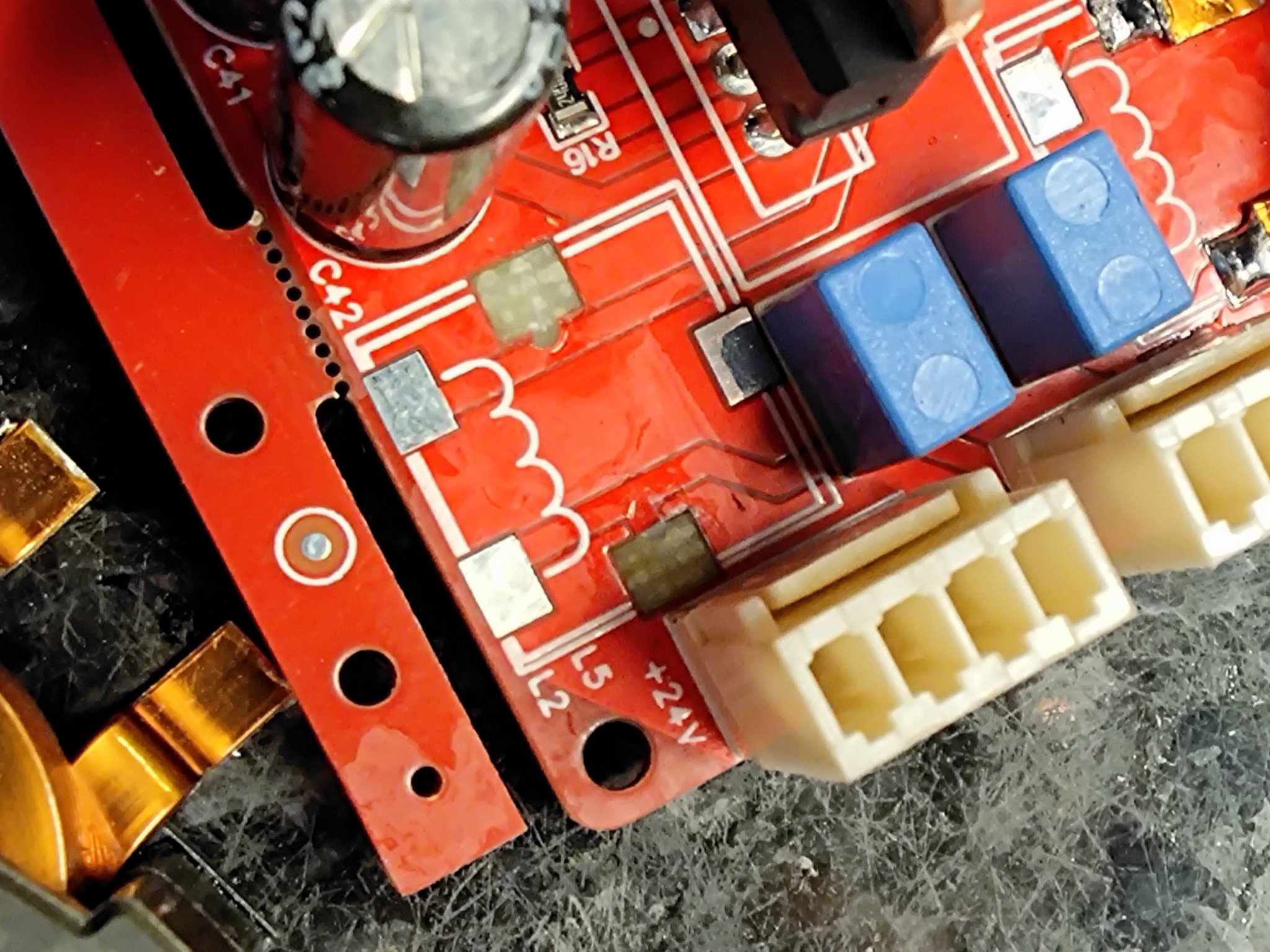

I also inadvertently 'removed' one of the big Coilcrafts. Don't leave your 'projects' in the boot of your car...forget....and go for a spirited drive in the country!
Ripped the pads off but I managed to mend it with copper tape. I've measured over and out of the coil and it has the same DCR as the original trace so I think the fix is adequate.

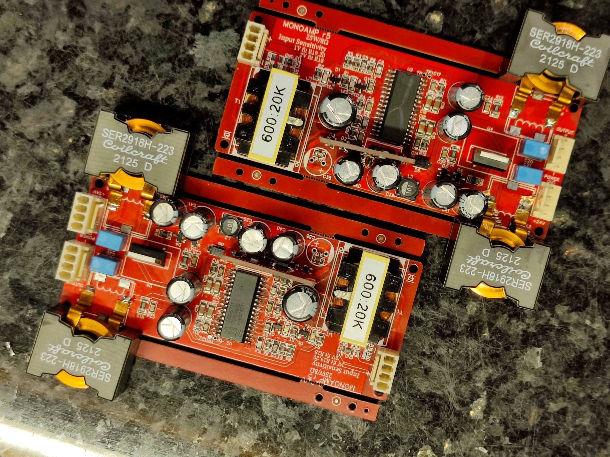

Nearly have 4 made up now so hopefully will be giving them a listen soon.The green boards are bare boards that I had made with gerbers. Steady old job populating those! I have had good results with a Traco power 100w SMPS. I have (had) a bit of an aversion to SMPS but I got these cheap enough mainly as simple test PSUs. I used one per channel on a recent Pass ACA build and I have to say they were silent. I measured the AC ripple just with a RMS DMM and I think it was below what it could read . So I'll try them with Mark Johnson's SMPS filter into these amps. I also want to try a CapMx.
