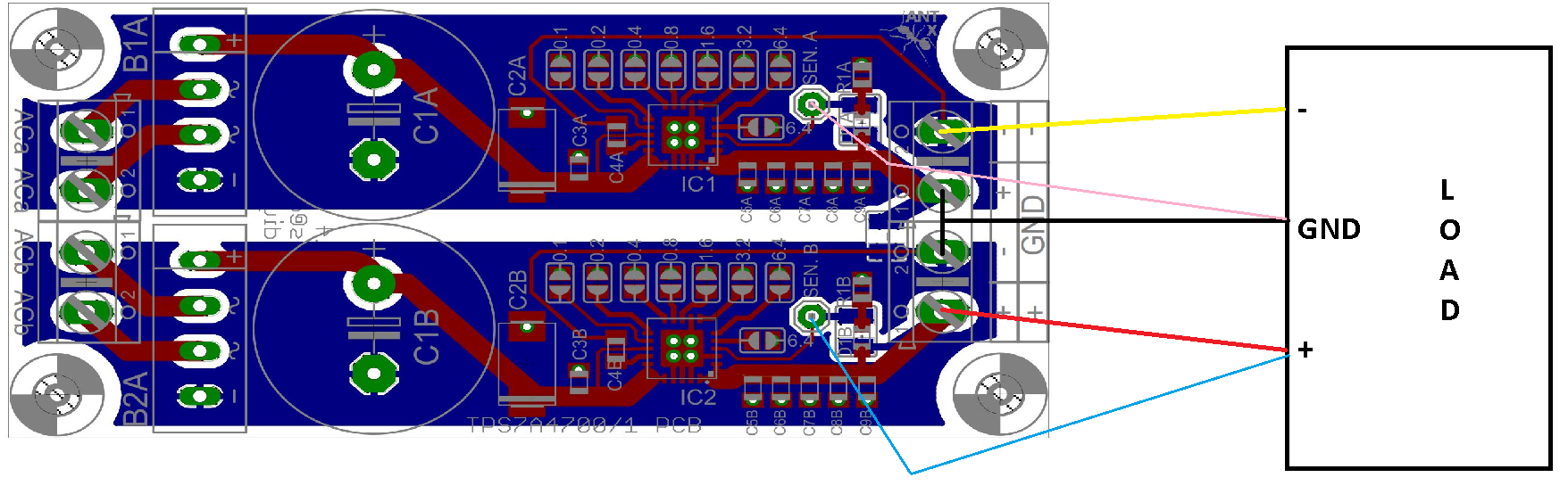

Hi Ales,
The connection of the sensing pins in case of a dual symmetrical +-power supply is not 100% clear to me.
On the PCB I see SEN.A(-side) and SEN.B(+side)
From the manual: The dual PCB has sensing only for positive voltage
Do I only connect SEN.B(+side) to the load and install a jumper for SEN.A(-side) ?
Danny

Danny,
you connect SEN. B to the Vo+ and SEN. A to the GND point (+ from A side and - from B side). See attached picture for more clarification.

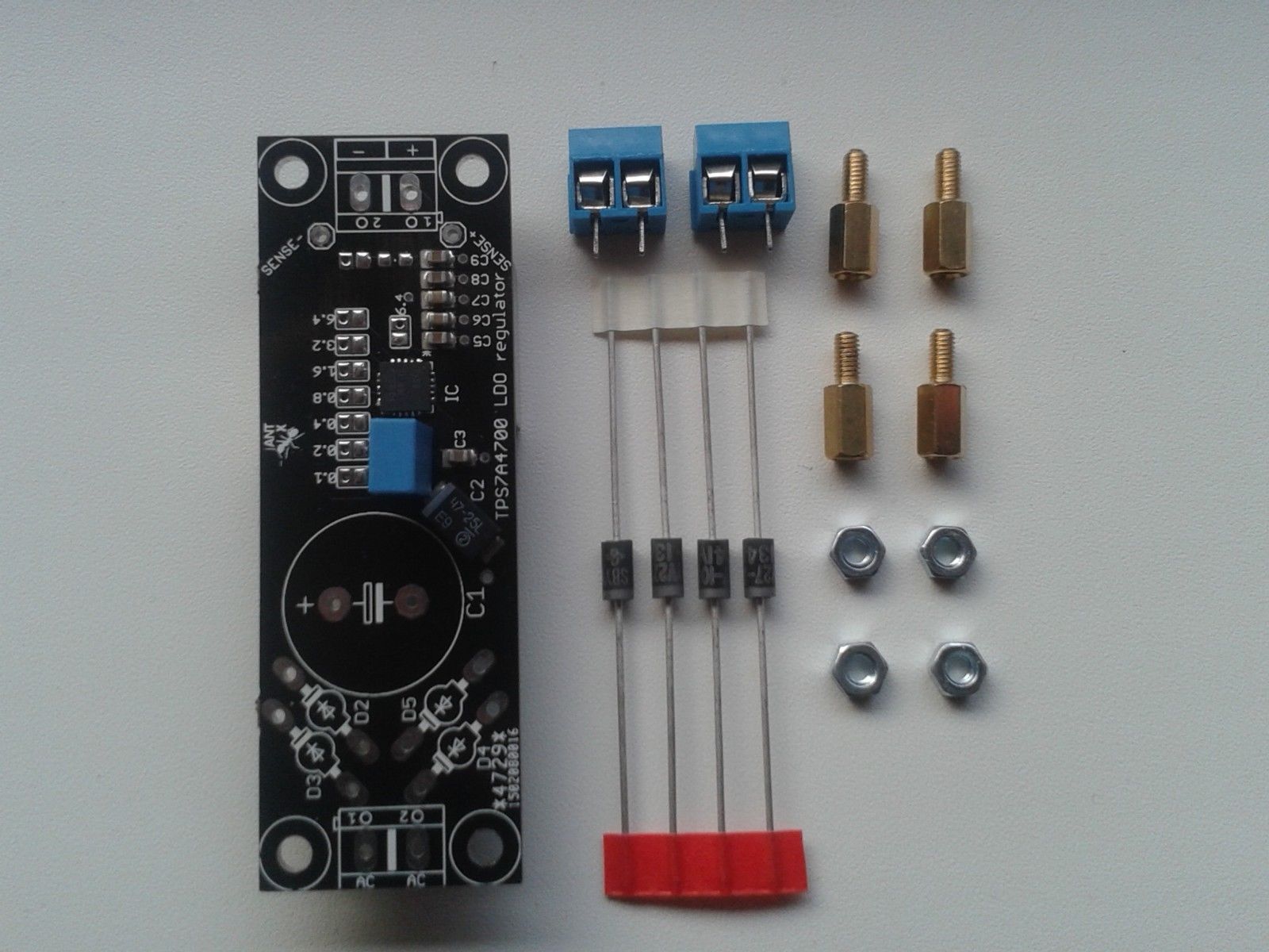

Hi guys,
I have single PCBs now available in black color.
Price = 21€ for 1pcs
What do you get for the price
Single PCB with smt components soldered on 1pcs
SBYV27 rectifying diode 4pcs
Epcos 1uF/63V PET capacitor 1pcs
Screw PCB connector 2pcs
attached aluminum block 1pcs (works as heatsink or heatbridge)
M3 nuts 4pcs
standoffs 4pcs
Panasonic FR capacitor 1pcs

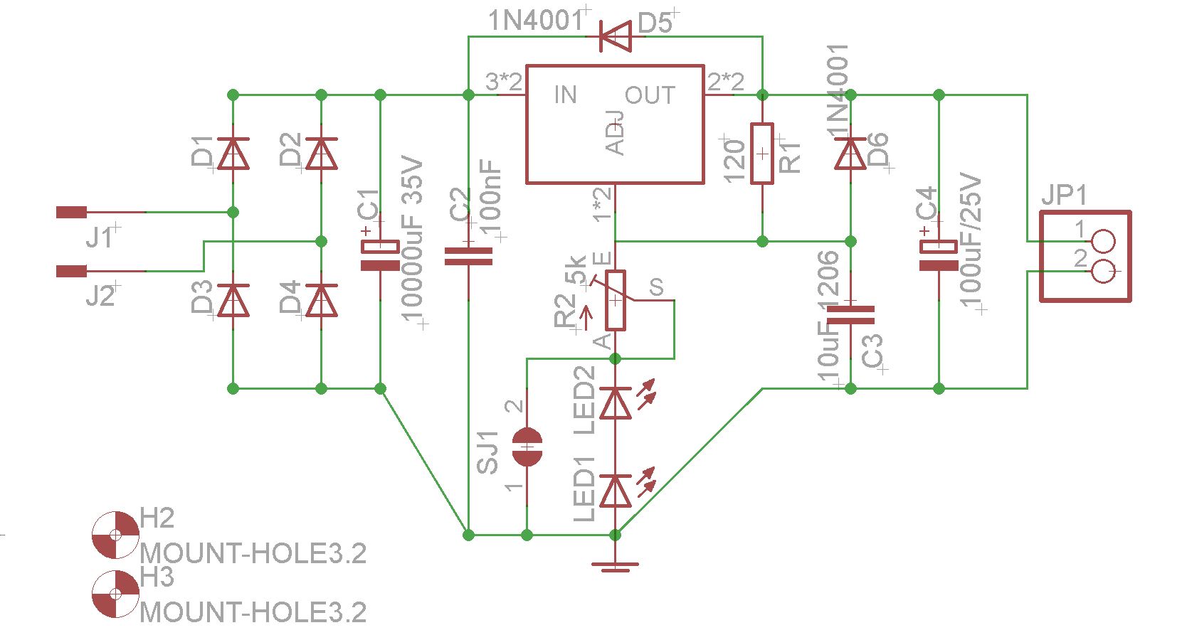

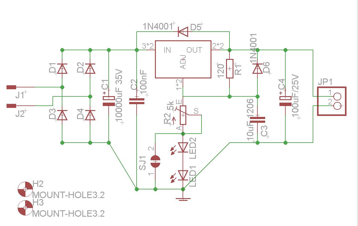

Hi Phil,
please find attached schematic for LM317. I measured both of them on 60Mhz scope, 5V, 100mA, 50ohm load. In both cases I got flat line on the scope. What I was talking about in previous post is that TPS7A sonicaly outperformed LM317, which of course is my subjective opinion.
I tested this on a Pavel Macura BUF634 based amplifier. Input signal was from ODAC with usb isolator, headphones driven were Beyerdynamic T51p.
Best Regards,
Aleš
I think your LEDs are the wrong way around.
Jan
Hi Jan,
you're right. This schematic is the right one.
Best Regards,
Aleš

please see image of what you receive, though you still can't see Panasonic FR capacitor and small heatsink,but are included in the package. I currently do not offer dual PCBs as one can use two single PCBs and achieve same effect. Price of 21€ is for single PCB + parts, shipping is additional 3€. See first post for additional postage pricing.
