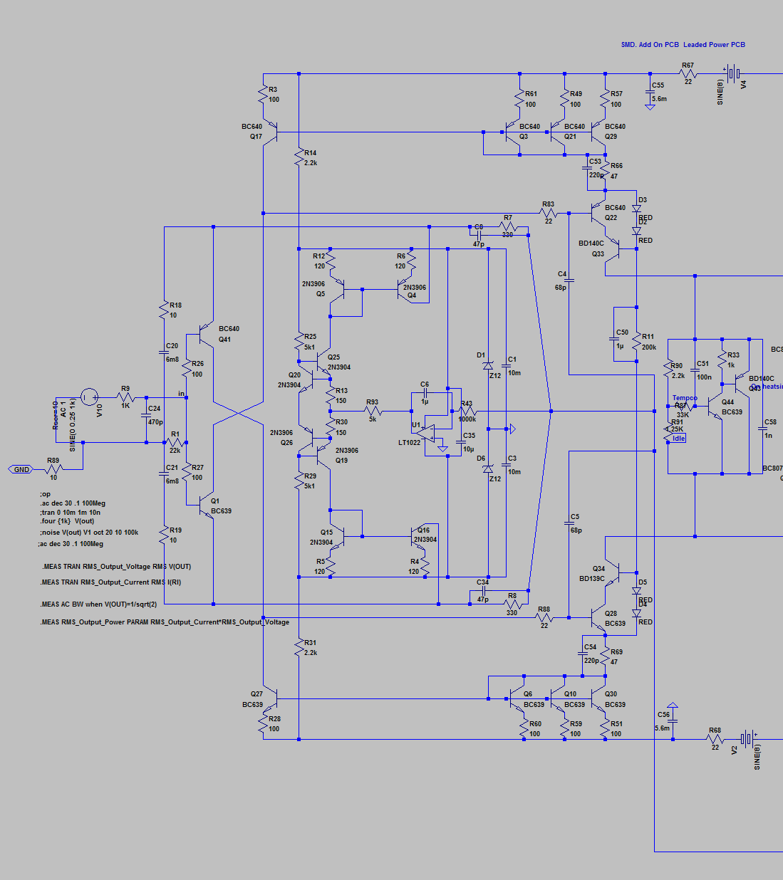

Some quick sims with my #4 offering for which I have done stability analysis using many different tools back to about 1980 show that this is indeed exactly what I'm after (for CFAs).
I tried to replicate the dodgy sims that seem to suggest Guru Zan's Tian on the output before the Cherry take-off pts weren't exactly equivalent to my Tian probes on the VAS input (to look at the VAS/OPS Cherry 'inner' loop). It appears I inadvertently removed my 0.1pF placeholders across the feed back resistor leading to the discrepancy.

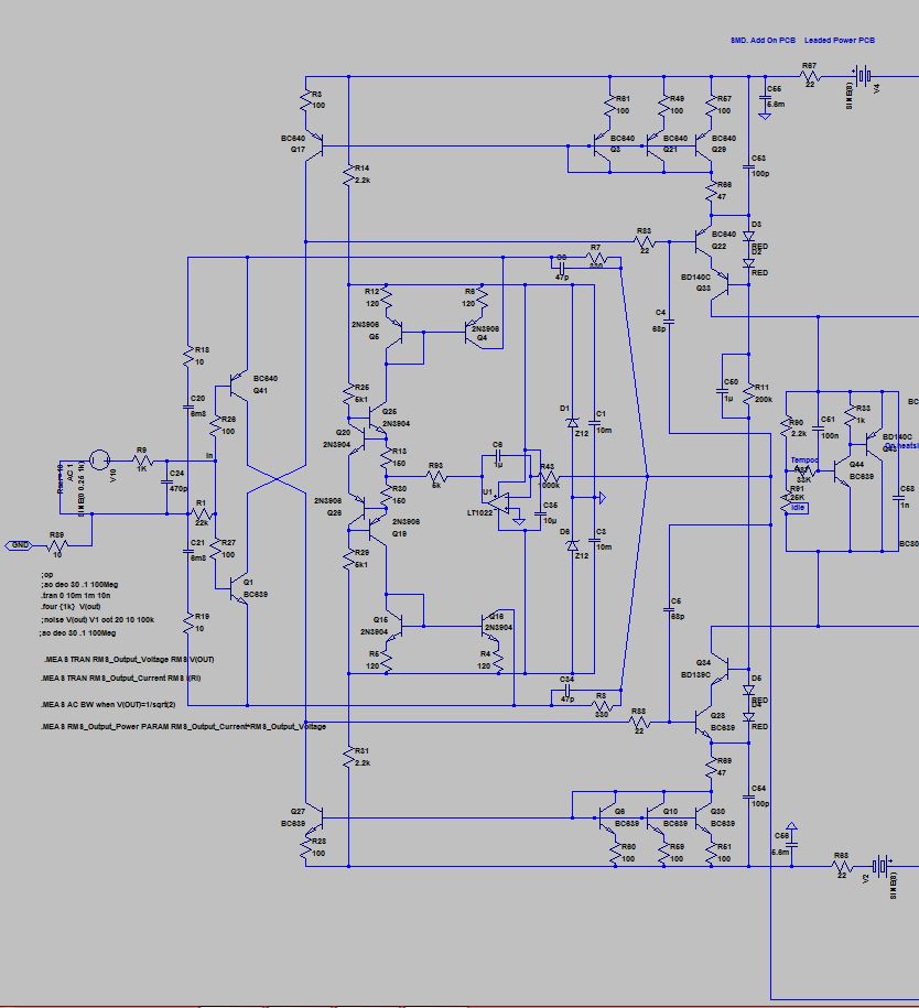

Dave Zan. This is in concept very much like my CFA amplifier, except that my Drivers are lateral mosfets, Also my housekeeping is different as i have made a +/- 12 V supply where I mirror in the drive currents, this allows for a simple implementation of an offset servo.
Anyway I find i interesting that the compensation can look so simple. I look forward to get my PCB's and experiment to see how it behaves and if this simple cherry can keep it stable.

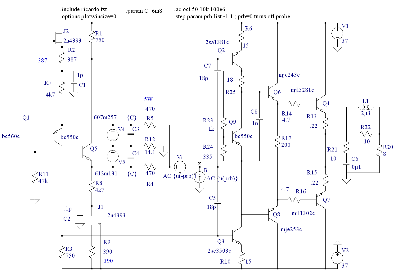

1. See the Return Ratio for the VAS + OPS loop in an Output Inclusive Compensated amplifier.
And then, separate problem, to
2. See the Return Ratio for the outer loop when that feedback loop splits to a pair of inputs.
So in this simulation you see the OLG of the amplifier with the CLG of the output stage or do i misunderstand the function of the tian probe..??
We use the Tian probe to see the Return Ratio (=Loop Gain, more or less) of a loop, the outer loop in the latest post.

And just to be even clearer, my circuit in #262 is only a proposal for which I asked Guru Zan to provide an important missing tool to investigate stability. Without this tool, I was unable to do the full tests described in #1 and also more stuff I've pontificated on later in this and other threads.
Without doing the full series of tests, I would not want to present this as a 'finished' design .. especially as I've no 'real life' experience with anything similar.
Now I have the correct tools, it may still be some time before I get round to doing these SPICE world tests on CFAs as they take quite a lot of time & effort.

MiiB, I'll just repeat my recommendation that your PCB allow for decouping the VAS emitter resistors (R6/10 in #262) with 100p - 1n NPO/CGO ceramics.MiiB said:This is in concept very much like my CFA amplifier, except that my Drivers are lateral mosfets,
Will you post your *.ASC or a pic of your circuit?Also my housekeeping is different as i have made a +/- 12 V supply where I mirror in the drive currents, this allows for a simple implementation of an offset servo.

To solve the dual path Tian probe I first recommended that you check a Paul Hurst paper, before I saw a simpler way.
But that recommendation made me reexamine Paul's paper and reminded me of his results for multi-loop feedback.
He discusses when a multi-loop structure can be analysed as if there is just one loop.
He proves that this can be done if a point exists that cuts all the loops at once.
This is intuitively plausible, that one point "sees" all the feedback and the return ratio there contains information about all the loops.
All the different feedback paths are effectively in parallel with respect to that point so the analysis effectively simplifies to just one loop.
Now for an OIC/Cherry amplifier that point is immediately after the OPS, where I placed the first Tian probe.
I claimed that the second, outer loop probe provided incomplete information.
That is true but not the full story.
In fact the outer loop probe is completely superfluous.
I am pleased to have finally worked this out, but sorry it took a while for the relevance of the article to sink in.

I try again this time PNG, sorry I can't disclose the output stage as it does not belong to me, This is now in final stages of PCB design, and I will fit it with the option for nested feedback. Then I'll/we'll get some real world results on how it will behave and if the Cherry compensation can keep it stable, I'd really like to get the 20-30 dB distortion improvement at high power/high frequencies LT-spice promises me. The front end is on a separate SMD mounted board, so it will be very easy to listen to and to measure the different options.
