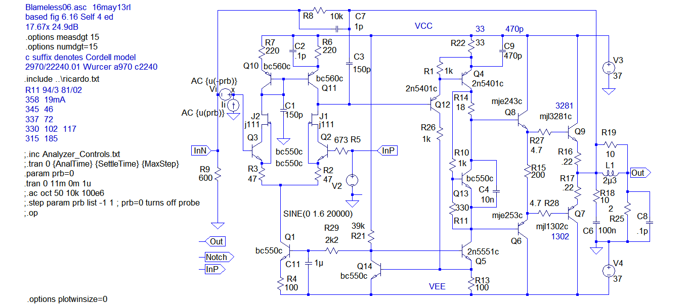

Frank, I won't have time to investigate properly for another month but using the #56 version and MJL3281/1302 seems to get rid of the wriggles into 2R load. Note R22 becomes 33 and C9 470pOkay, tried the variant as described in #56 ... and it looks nominally better at 2R - but then goes very wonky
With 1R5 load, even this is 'clipping' cos the VAS CCS runs out of current.
2R is a very cruel load for the MJL2994/3 version and exceeds SOA with any sensible heatsink. I note Self's fig 6.16 (4th ed) which is roughly what this series is based on, clips even earlier and shows the same behaviour even with its plain Miller comp. (with the same devices)
I won't be able to do a full stability analysis with this load until the end of Aug but please post what you get if you do. Do you have a simple 50W 8R example that doesn't behave like this that you could post the .ASC?
Thanks for drawing this to my attention.

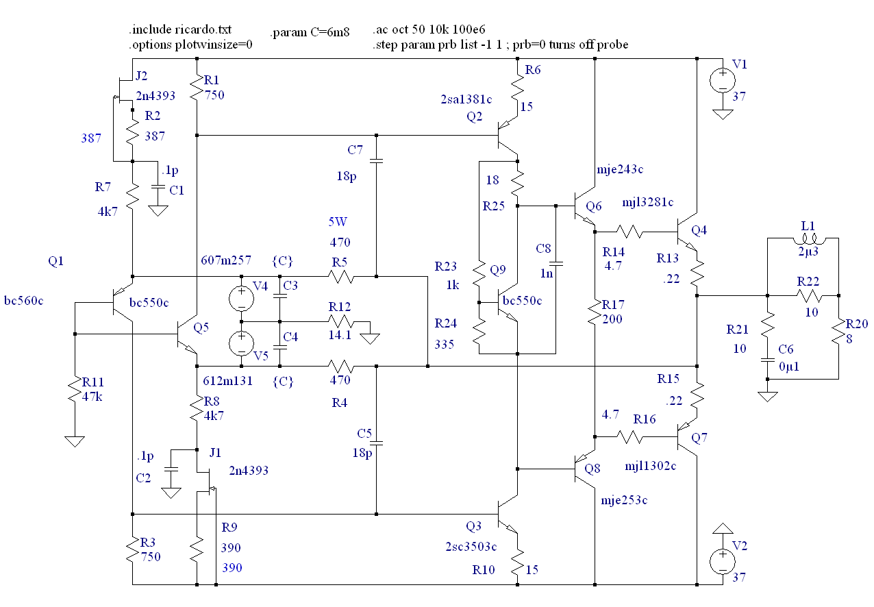

Just to point out that the .ASC of the 'final' pure Cherry version is at post #1480 cfa-topology-audio-amplifiers
This uses MJL3281/1302 which are seen to be da o/p devices of choice.

I would very much like to see an example (either sensible or stupid) of this mythical beast.An amp can have an unstable inner loop, this is does not have to make the outer loop unstable.
Consequently the outer loop stability indicators will look fine.
For the .ASC I posted in #1480, reducing C1/3 reduces LG for the 'inner' Cherry loop (ie makes it more stable) but increases it for the main 'IPS' loop. This reduces the stability of the complete amp...

The Hawksford error correction may have marginal stability but it is still STABLE. Hence the 'outer/main/important' loop is stable.>'An amp can have an unstable inner loop, this is does not have to make the outer loop unstable.
>Consequently the outer loop stability indicators will look fine.'
>>'I would very much like to see an example (either sensible or stupid) of this mythical beast.'
The Hawksford error correction OPS is a nice example. The inner loop uses positive feedback and thus extremely unstable, yet the outer loop is stable.
Perhaps a better example of marginal stability in inner loops not affecting the 'main' loop is TPC which often shows 10dB or more peaking in the midrange with no effect in the final amp.
But these 2 'inner loops' are still STABLE though with very small margins. (You'll note that my 'inner' Cherry loop has excellent margins even at that evil high frequency.)
Any of the Nyquist gurus want to tweak one of these (or some other amp example) so the 'inner' loop becomes unstable but the final amp still stable ?

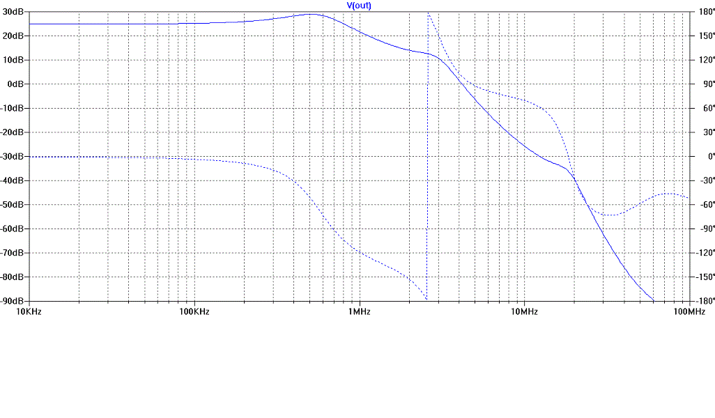

As an example of how the 'outer' loop reflects behaviour of 'inner loops', this is Closed Loop response of said evil amp with really wonky loads and stability margins cut to the bone. You'll note there are 3 bumps, each of them reflecting the behaviour of an 'inner' loop.

Doing more work, my initial thought that your 'Tian probe between OPS and the feedback take-offs' is looking at the VAS+OPS+Cherry 'inner loop' seems to be not quite true though it is a useful alternative view...
Why do you now think this?
Best wishes
David
I have taken the liberty to respond to some of your PM comments back in this thread, in case anyone else cares about analysis of feedback.
My analysis of the theory says the two placements should be completely equivalent.
But I also did a few simulations, just to check and was admittedly pleased to see that they matched perfectly.😉
That confirmed not only my analysis but that the Tian probe is correctly implemented, which I had always assumed but never actually checked.
I think this shows the inaccuracies of the inductor method rather than any problem with my recommendation.

I think we are both nit-picking here. What is still lacking is a good way to look at 'main/outer loops' for CFA amps. hint hint
I'm ashamed to say I haven't had time to look at the true implications of the VAS emitter resistor (ala Cherry) and its decoupling (ala Lee)
for more head scratching: http://www.diyaudio.com/forums/soli...terview-error-correction-250.html#post1328496
the Tian probe clearly isn't measuring what I'd like - pretty sure the loop gain isn't "flat" at lower frequency - my guess is the EC loop changes sign, becomes positive feedback at low frequency and cancels out the negative feedback in the Tian probe calculation
I've not yet learned the Middlebrook "final solution" extra element theorem GFT despite having Vorperian's book, the Middlebrook CD

...the Tian probe clearly isn't measuring what I'd like - pretty sure the loop gain isn't "flat" at lower frequency...
Tian probe doesn't know what you like, of course, but it's a bit counter-intuitive.
At least, it may be, but it's fairly hard to see.
If not an ASC at least a clearer picture would help.

The best 'linear' measure is simply to plot Closed Loop response. The curve I show in #248 has wonky loads AND compensation cut to the bone.Any linear model will have difficulty with actual instability since output will be unlimited. This has made me wonder how best to analyse the problem.
The 3 peaks are at UGLF of the 'inner Cherry' loop, ULGF of the 'main/outer' loop and the resonance of the output inductor with the wonky load. The 'inner' & 'outer' loops are on the verge of instability which you can see on their Loop Gains. This is reflected in the Closed Loop gain.
If the 'marginal stabilty' isn't a problem (like the mid peak with TPC) you'll see zilch on the Closed Loop response. But if the stability of the inner loop is evil, you'll see peaking on the Closed Loop response.
If anyone has examples that disprove this, please speak up and post the evidence.

Just so there's no confusion, is this the CFA you want to analyse the outer loop?
- TPC vs TMC vs 'pure Cherry'
