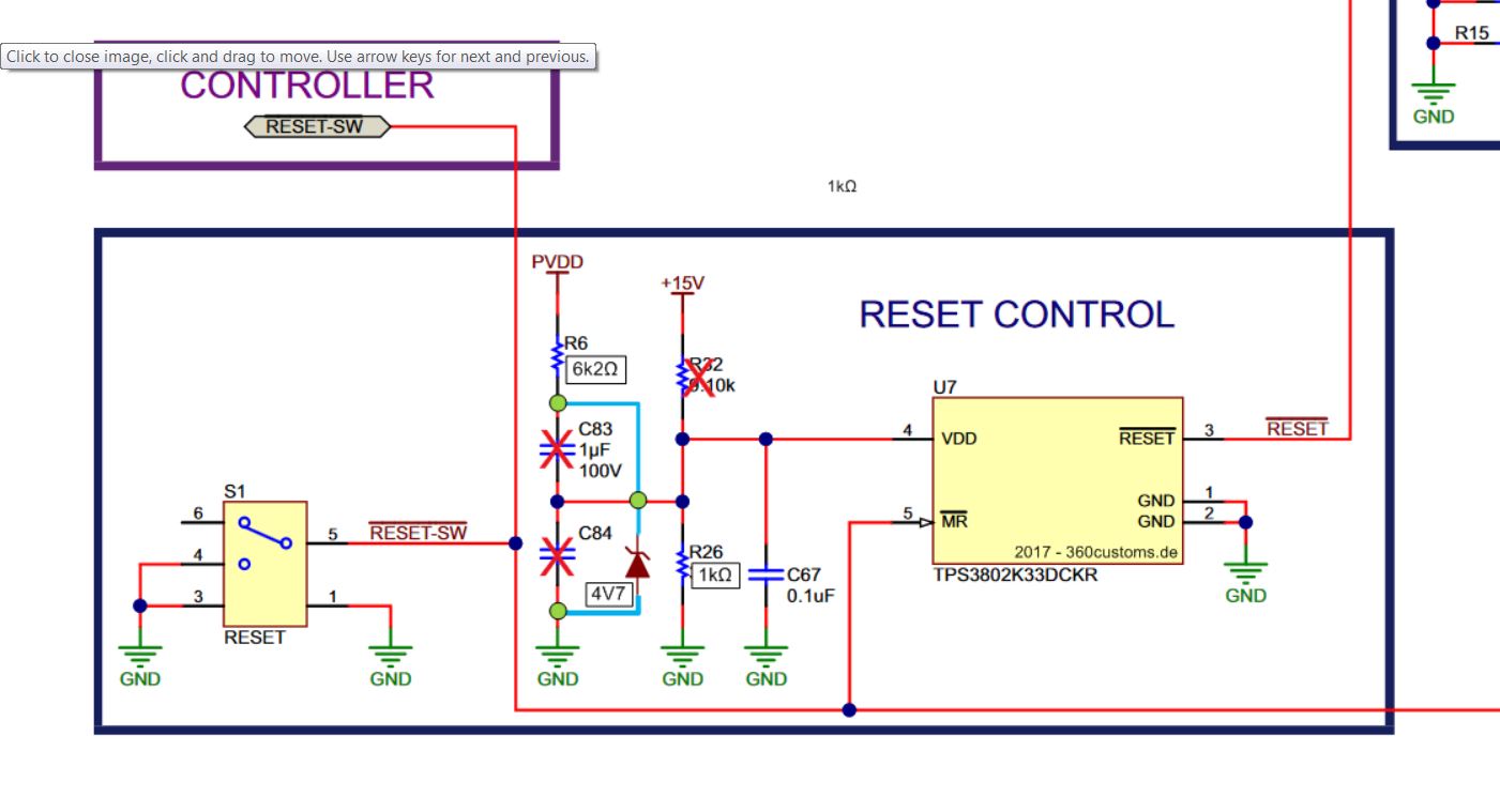

The RESET switch connection is accessible at pin 10 of the female header J28, so all you should need to do is connect this pin to one side of your external switch, and connect the other side of your switch to pin 22 (GND).
Hi, I have a TPA3255-EVM board coming, so I thought I would check through this thread. A little shocked to find out about this Reset switch, not seen it mentioned anywhere else. Does that mean I need to reset it everytime I turn the amp on. Cheers

Set S1 to the RESET position.
f you want to avoid a on/off plop you have to set the switch on...this set the reset pin to GND for the moment the power supply is running up.
to avoid this you have to deal with an extra circuit -the pic shows the valuse of th chines YJTPA3255 board...so recheck it

@gigi: in post 86 TPA3255EVM to complete amp (advise needed) I posted a link for a finished $1 module you can use to hold the reset switch for you. And linuxfan added that you can connect it to the big black pin header (J28) instead of soldering it to the bord in post 88 TPA3255EVM to complete amp (advise needed)
