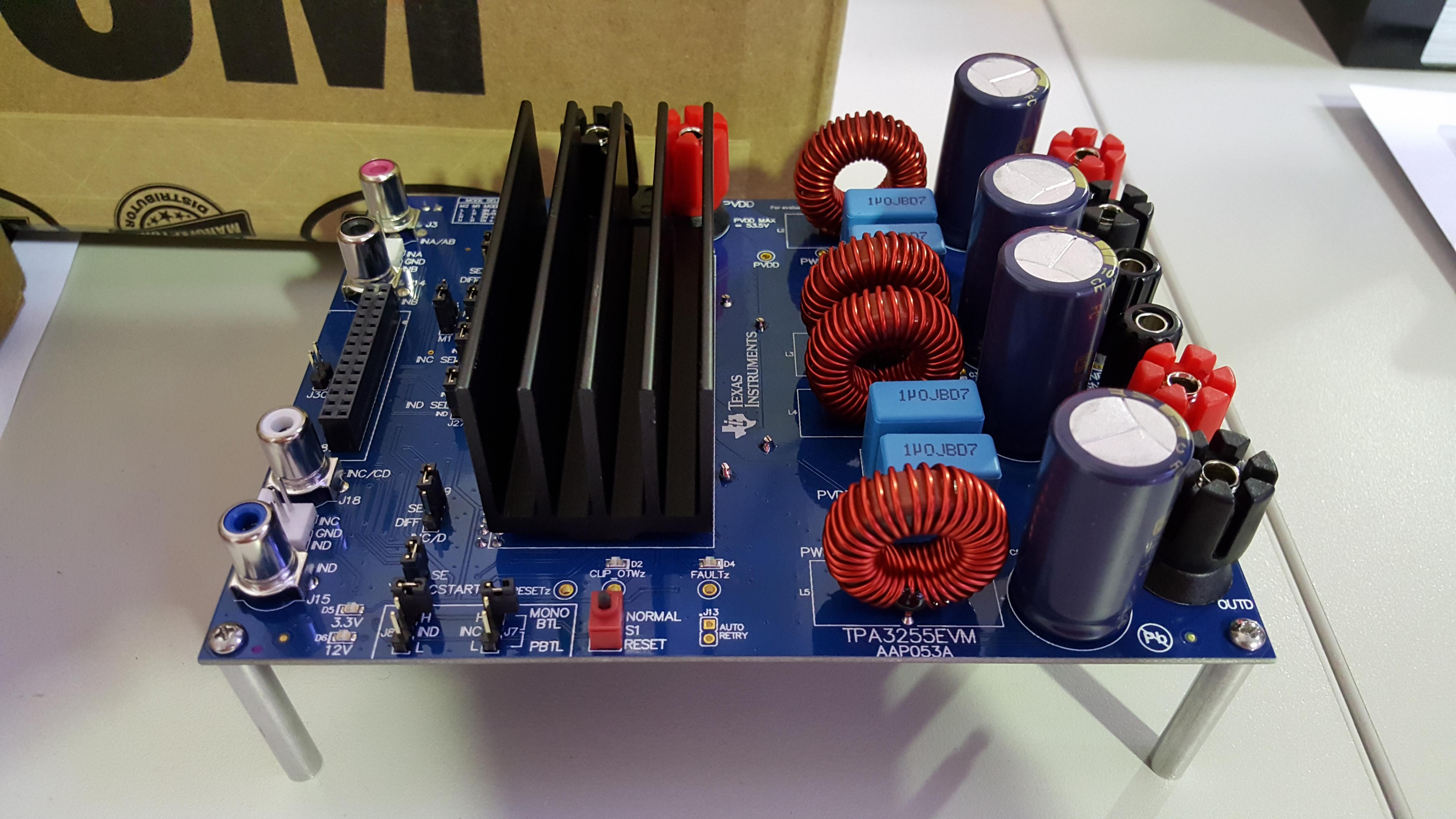

Thanks! So what would you do about volume adjustment? Do you have a go-to method which I could package in the same enclosure I place this amp inside?
Burble. Uhm... You would probably get a getter answer from someone else but...
http://www.ti.com/lit/ug/slou441/slou441.pdf
Piccy Figure 6) page 18) Input impedance to the amplifiers is 10K. Set it up single ended and use a 10K log pot. Not sure which way up things would go and it might be an anti-log pot but wiper to input on the RCA. Top to your source. Bottom to ground on the RCA.
Audio Taper...
What are Audio Taper Potentiometers?
I mention the input impedance because that will likely modify the response.

Hi, Is there a way to increase the gain on the T/I EVM board.
Cheers
Not via jumpers...
Piccy is Figure 6) on Page 18). R8 and R41 set the gain (With R7 and R42) for the SE/DIF amplifiers. Input impedance is set by R7 and R42. Gain is R8/R7 and R41/R42.
Gain as supplied is unity. Change R8 and R41 to 20K for a gain of 2. You can do similar with R7/R42 but it changes the input impedance. 20K would give a gain of 1/2.
Don't go mad.
