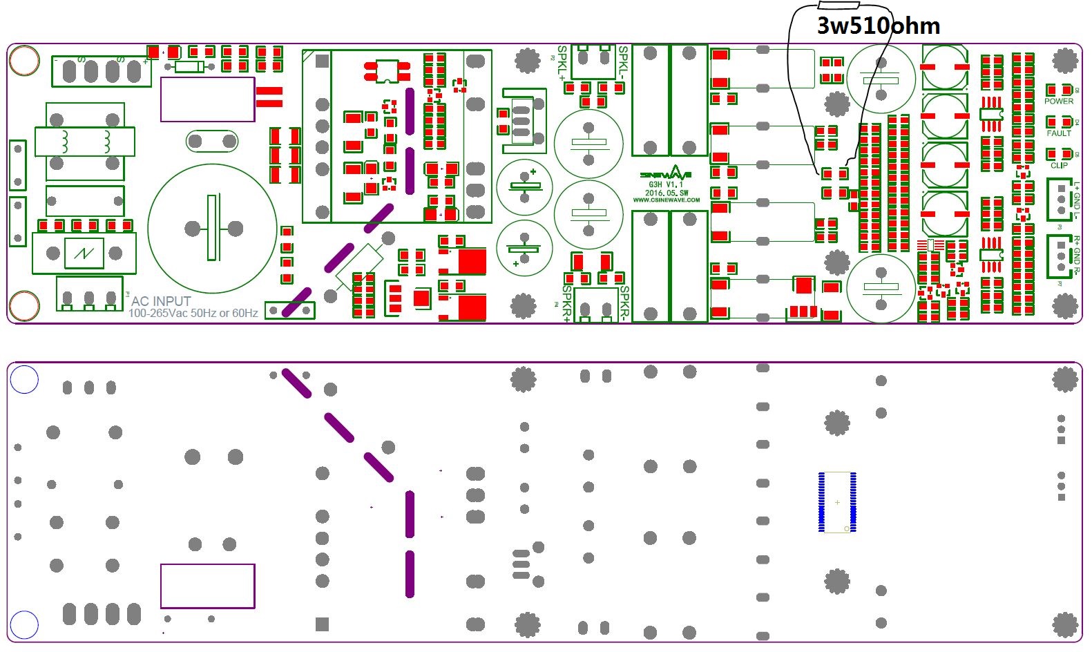

I have read a lot about sinewave and just had to try this out.
Unfortunatly there is a very high pitch noise from the PSU. It's so high that I can't really evaluate the amplifier. I have send a message to the company, and hope for a replacement soon.

Thanks for the usage report. How infuriating that SineWave would release an audio product which produces a high pitched whine!
I have contacted the seller here (Authlx), and on their aliexpress shop. Answer from their shop was that the noise is within their quality control specifications.
I'm guessing that the noise is coming from the on board SMPS?
Yes, and if so this is a design flaw that should be traced.
yes it's from the PSU, and if you read in the TAS5630 vendor thread they know about this, and that is also the answer from their shop (Freya responds). But, They say it's normal with no load.

Ah with no load isn't a surprise. Switching supplies tend to go into burst or discontinuous condition mode during light loading. This can bring switching or parts of the switching into the audible band.
The easiest way around this would be to load the output of the PSU with a suitably sized resistor, say load it with 10 additional watts, or however much is enough to bring it into normal operation.

Exit G3H PSU standby mode
Hello, everyone.
If you can not accept the G3H standby mode hitckup noise, please help us to skip this mode, (like our G300V21, we use one load resiter at 50V Vcc.)
You can solder one 3W/510R or 5W/330R resister to the main DC line, the position show below photo. of course standby power consumption increase, and amp case warm
Thanks for the 5th element reminder, we omit the load resiter in G3H, G300V21 have this load resister,aim to save more energy .
