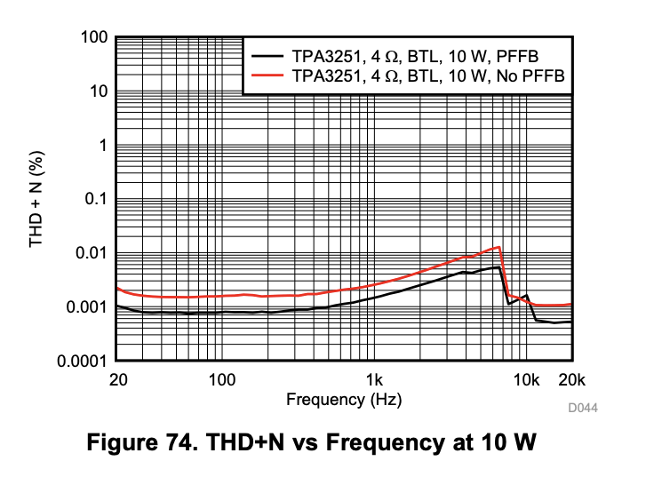

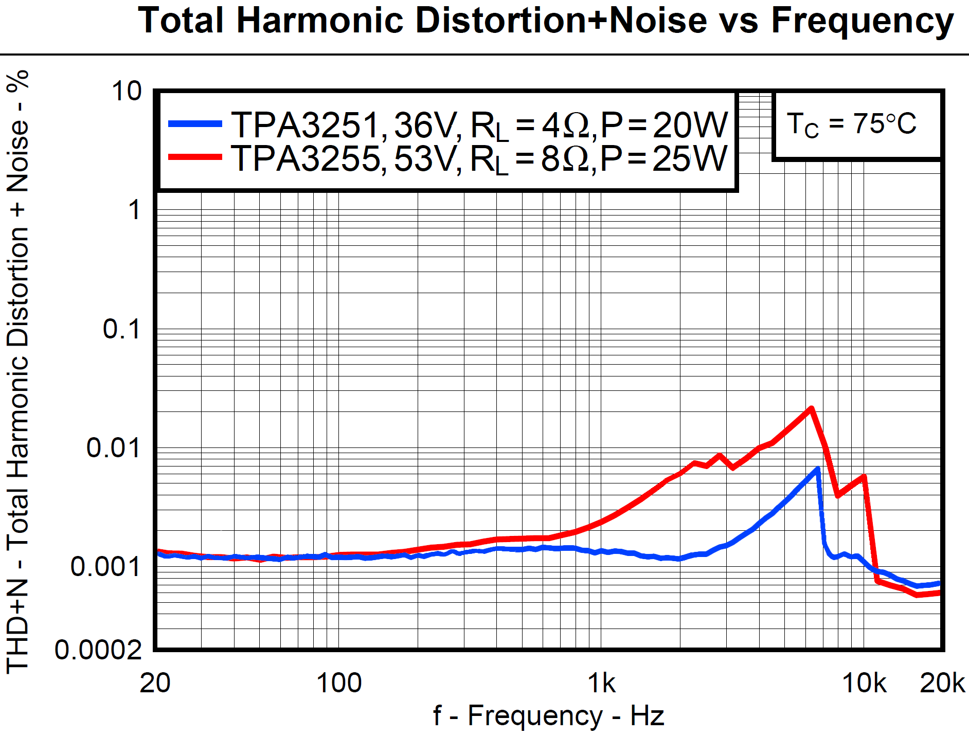

The reason is that there appears to be a big difference when running the TPA3251 and TPA3255 at their maximum voltages into a 4 ohm load in terms of THD+N in the desired frequency band (upper mids and highs), at least based on the data provided by the manufacturer. The next two graphs illustrate this.
Unfortunately, there is no frequency-dependent THD+N graph for the 4-ohm load of the TPA3255, but it can be seen that the THD+N for the 4-ohm load of the TPA3255 is even higher.
Therefore, it seems correct to conclude that in the frequency band above 1 kHz when operating with a 4-ohm load, the TPA3251 has a significant advantage. Since my amplifiers will be used for dedicated bands, I would like to get the highest possible quality that TPA can provide on one of the best boards for it, especially in such an important range as mid-high.

interesting but i am really doubt graph one as it is against with app note and TPA3255/50 series
the reason we don't build TPA3251 is that the test performance is not in big number different and only few people like 3251, they actually want MORE POWER (even they don't need so much power)when pay almost same amount money.
