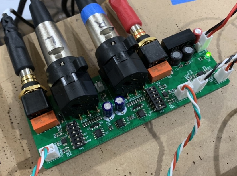

In case anyone wants a RTR Panel Mount BTSB buffer to go with this amp, I am now taking pre-orders here. They will be sold for $165 each as part of the GB.
https://www.etsy.com/listing/1376892619/rtr-panel-mount-btsb-buffer-preamp?click_key=5c33cd695b30c6107ce3a782372e5b9f969f1d75:1376892619&click_sum=e674c5de&ref=shop_home_active_1

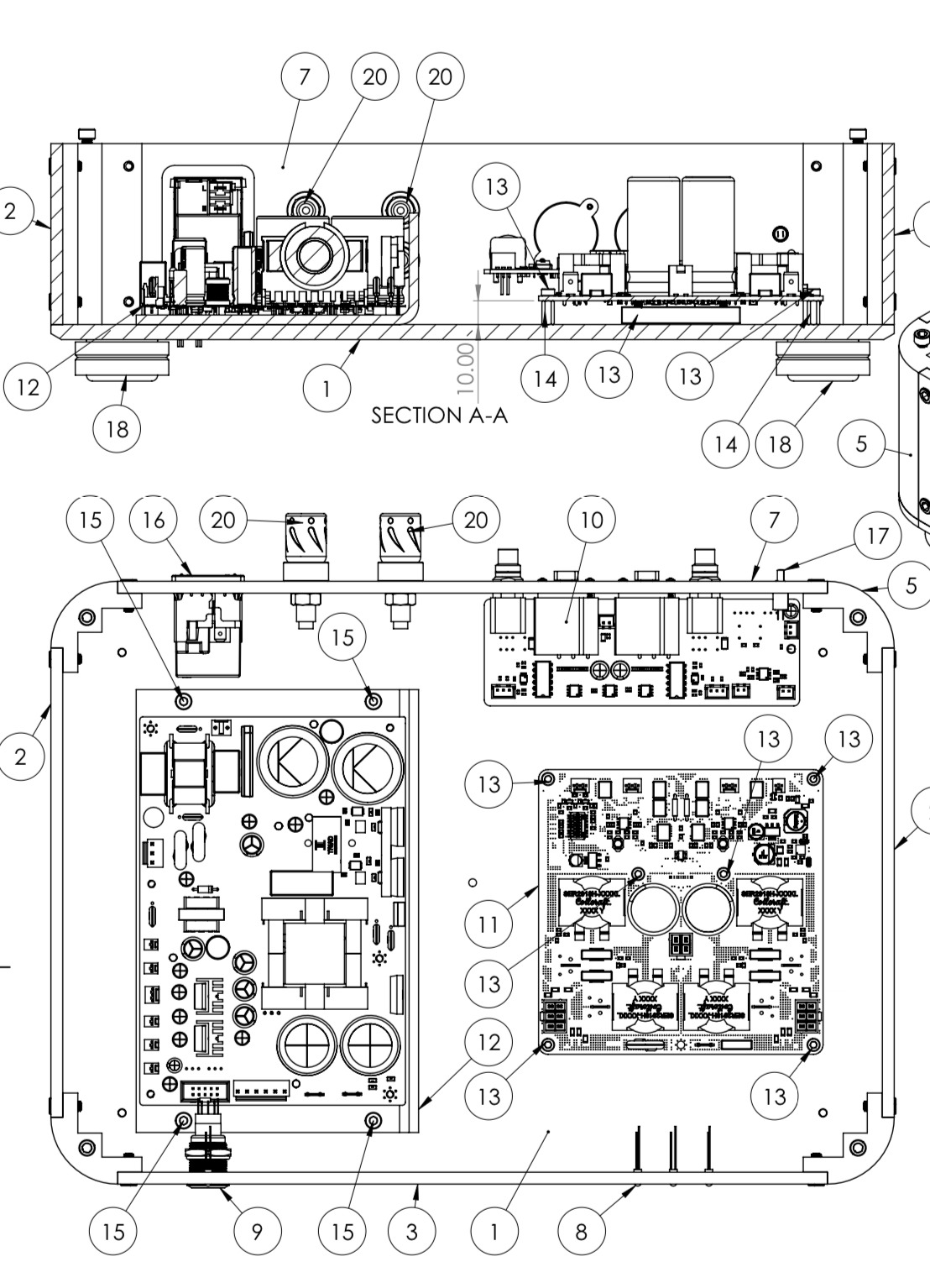

What is the minimum interior chassis height for the amp? I also purchased a BTSB buffer and a Micro Audio SMPS600-0 and an additional capacitor board with 40,000uF Gold Tune electrolytic caps.
Thanks XRK971! This is very helpful!I would use a 3in high (internal) chassis. Here’s how I did it…
