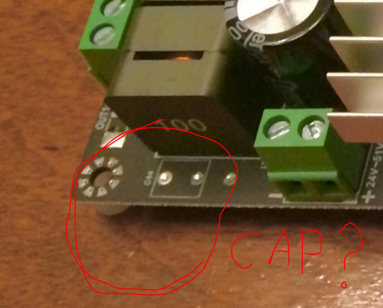

3e Audio 3255 observations and questions
I have had my 3e 3255 stereo amp in place since Septembee 2018. Running at 40v with 40kuf capacitance unregulated PSU.
It was never put into a box so I thought I would take it all down and house it properly. I also have a new 35v trafo, LT4320 based ideal rectifier and new caps for the build.
I thought I would recap the amp board as it has been powered 24/7....and well....we like to recap things dont we.!
The 3e board has 4x 1000uf 63v caps. Looking at the Ti 3255evm schematic, they employ 2x 4700uf caps for the main 'PVDD' power input. So the 3e board is a way off there. I shall attempt to add more capacitance but there isnt much room for anything more than 16mm diameter caps, best I have found is either 1200uf Panasonic FC 105degree or 1800uf Wurth 85degrees. I plan on removing one of the green cable clamps and adding a other cap there, so I shall get 5x caps on the board.
Maximus I could end up with is obviously 6000uf or 9000uf for the Wurths.
What also interested me is looking at Ti3255evm having 4x 1500uf 63v electrolytic on the speaker outputs. (Part of the LC filter??). No sign of such on the 3e board. Just and caps and small tht films for the LC from what I can tell.

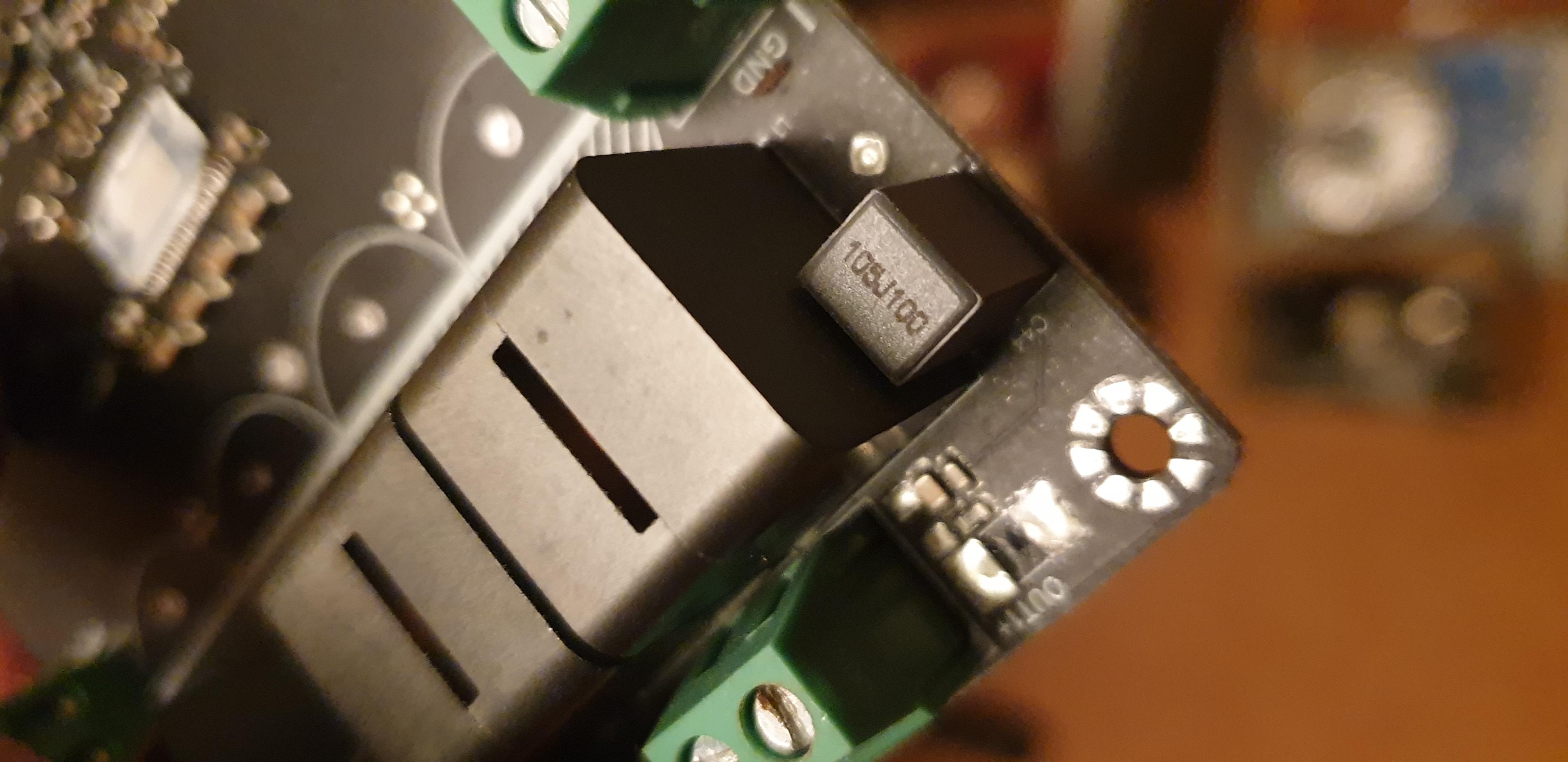

Warning!!!
Joined 2018
I know it isnt the point and assuming you are ok to do so but you may be better/quicker to fix the missing cap yourself. However I do agree that this needs to be bought to 3e Audio attention.
I have 2 of their amps..bought in 2018....both nicely made. I saw a couple photos on the 3e group buy thread later on that seemed to portray a drop in quality control. I hope I am wrong.

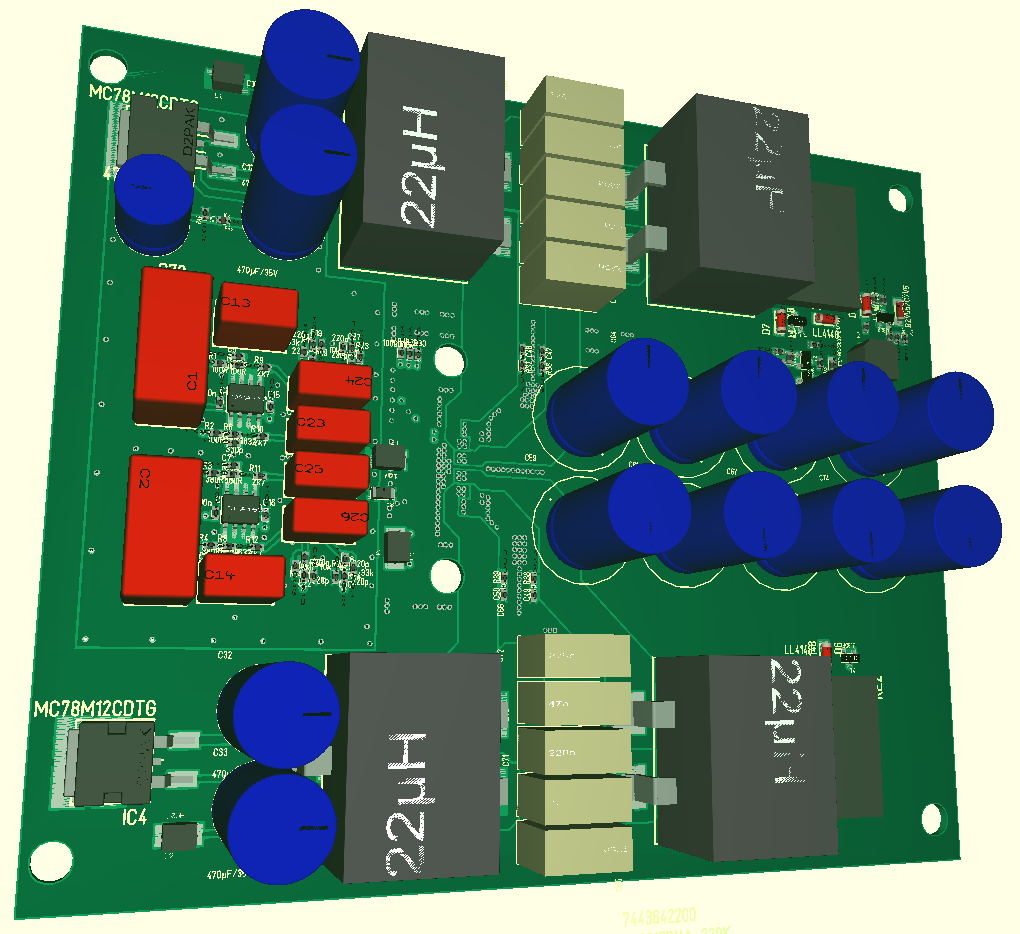

Power amplifier ist finished..
- Input ist single ended and with OPA1632 OPV's
- added relais with power on delay and if TPA detects an error, output is switched off
- PFFB circruit
- hybrid output filter
- zobel filter
- one 12V regulator for VDD and gate drivers with additional LC filters, second 12V regulator for AVDD
- 12V regulators have no connection to PVDD .. must supplied by external power supply
- AGND is not directly couppled and isolated from PGND ( including AGND pins on TPA )
- 4 layer PCB ( added layer for PVCC and GND(s) )
Now i need a suitable preamplifier.
