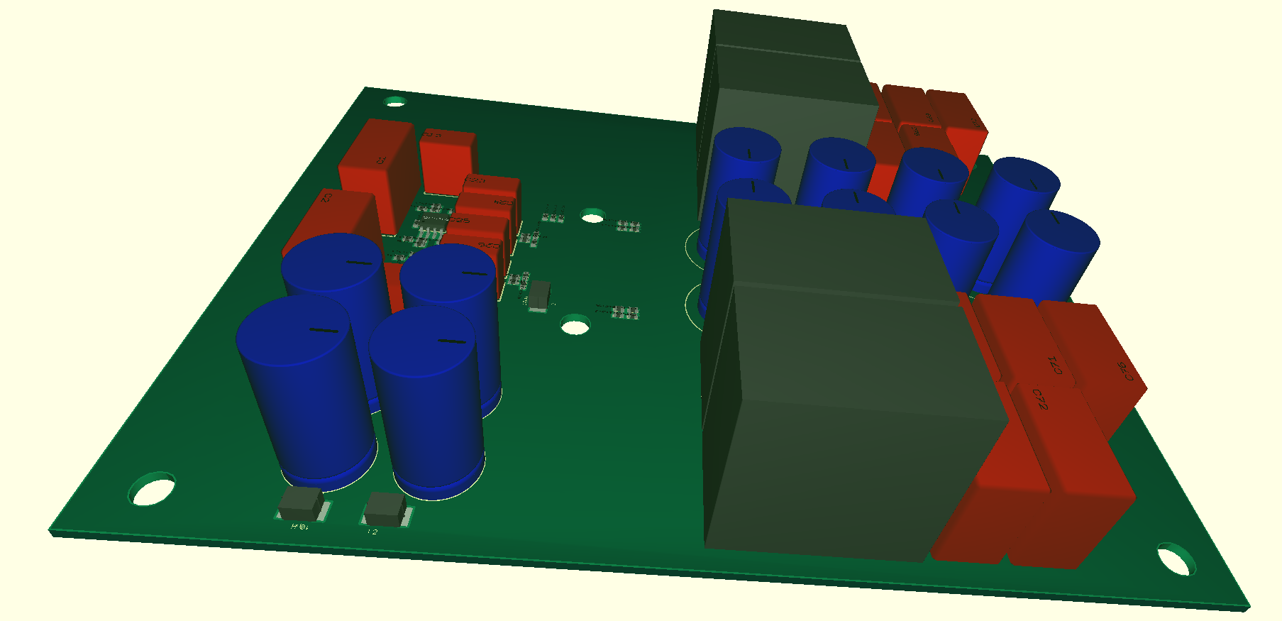

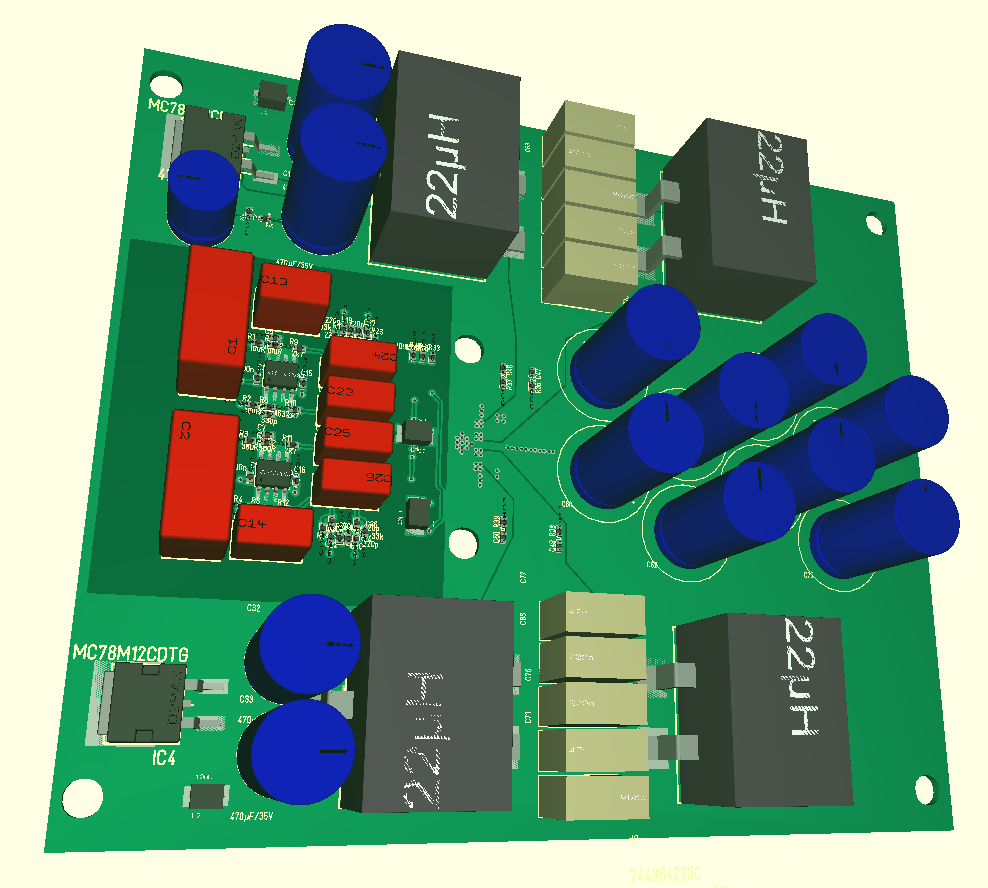

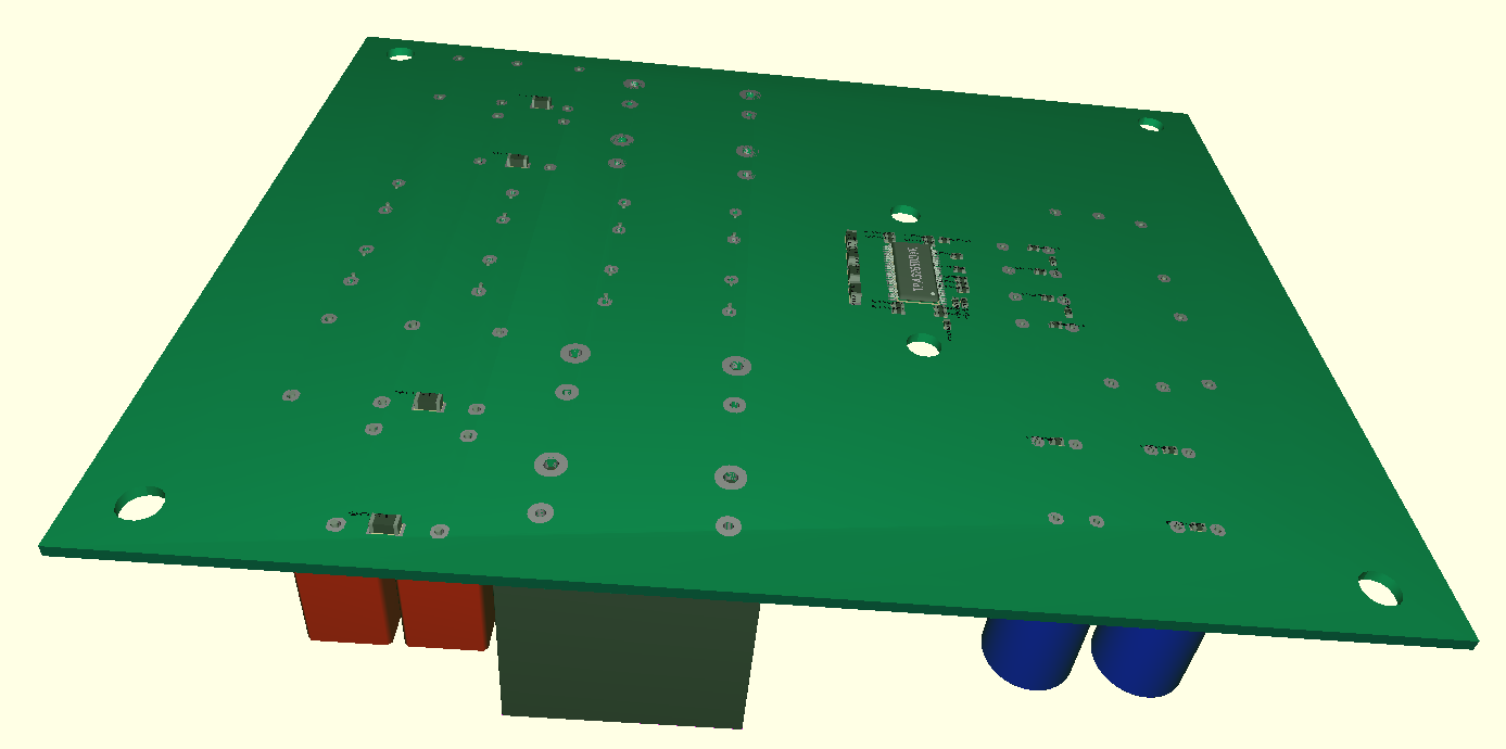

Hi
Schematic ist nearly finished !!
Including PFFB and optional additional snubber
Single ended to symetrical converter ist realized with OPA1632.
A
This Layout was designed for sagami 7G31A inductors.
Good saturation Limit, but weak Rdc Performance.
Newest Layout is for Low Rdc inductors Like
Würth or Bourns PQ2617BHA-220K
One question :
PFFB Return is connected after Filter to Output of OPV via resistor .
Then follows a coupling capacitor to input of TDA.
At the Moment, OPV ist driven by 12V .
Ist ist better to use 24v or symetrical Power supply?
Output of PFFB ist an Offset voltage of this Output Channel.
PFFB results in a loss of gain.
Opa has to be calculated to compensate the loss of amplification
But what is with impedance or to much voltage or dc fault on output

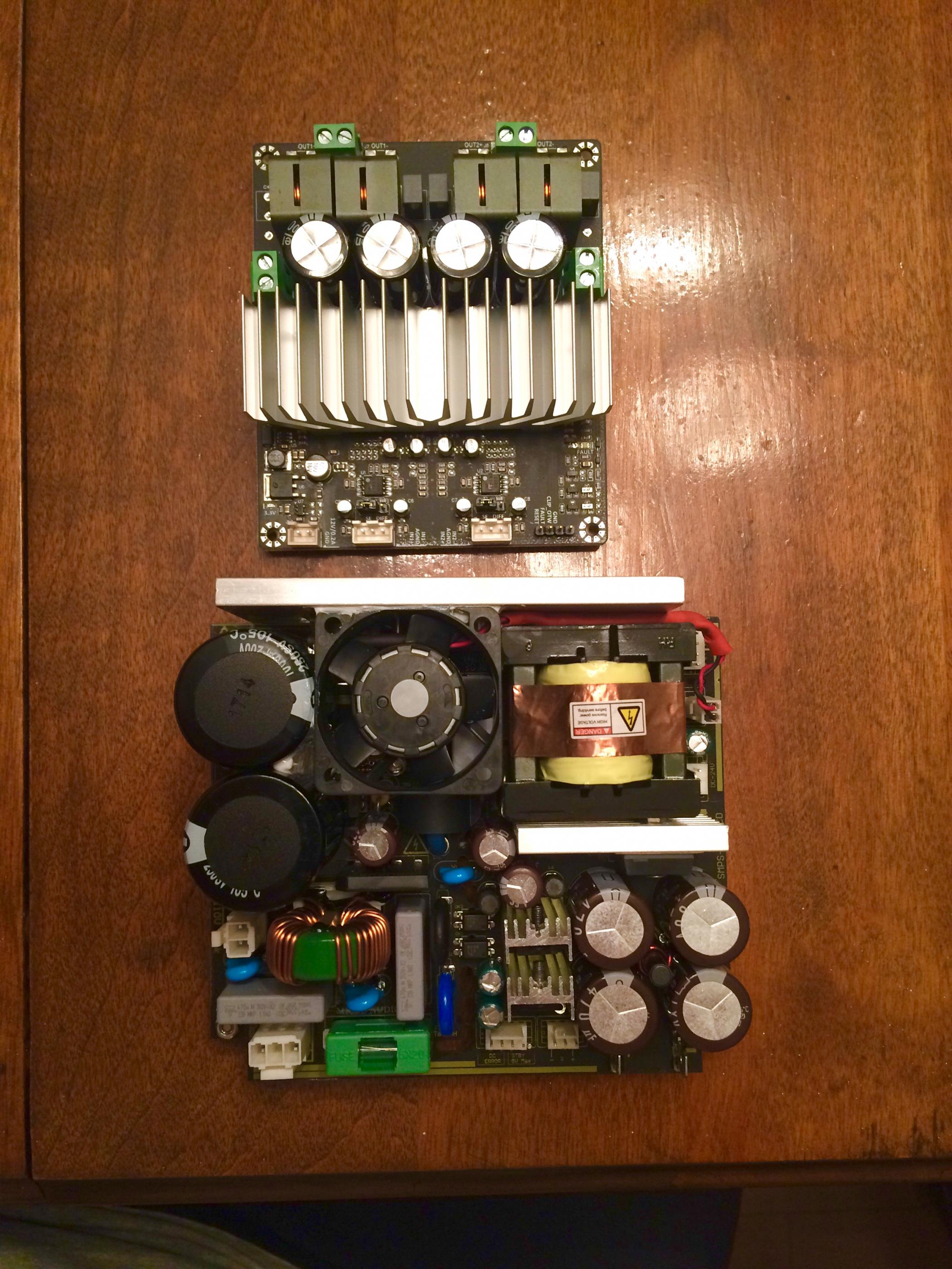

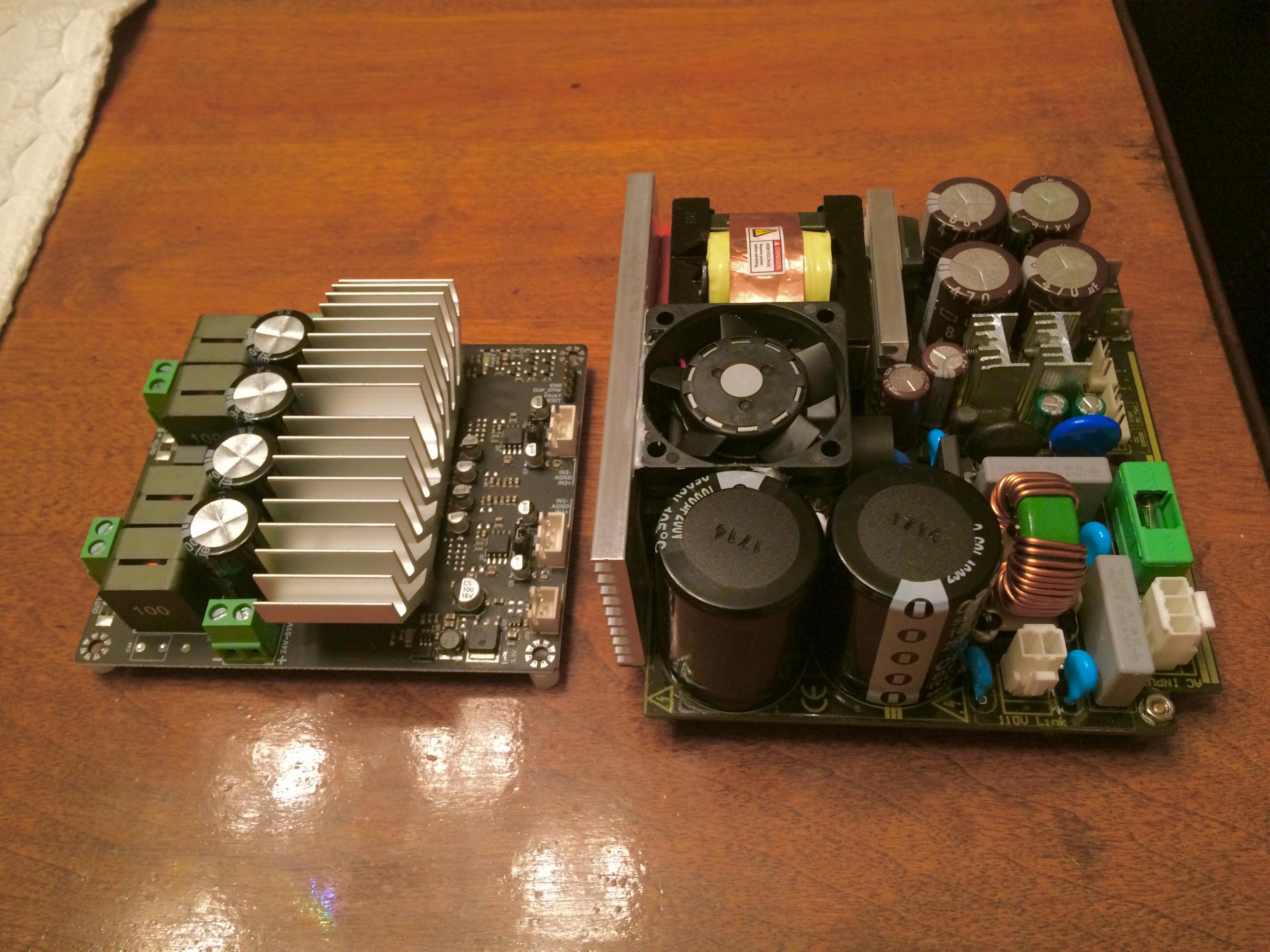

Just received today my TPA3255 power amp module and a few days ago my 600W 47Vdc supply from Cresnet. These 2 items will fit nicely in a enclosure from eBay, do a search w 1907 enclosure. Once I have received my enclosure I’ll post some pics. The 3e Amp is surprisingly small...For now, this is what I have;
