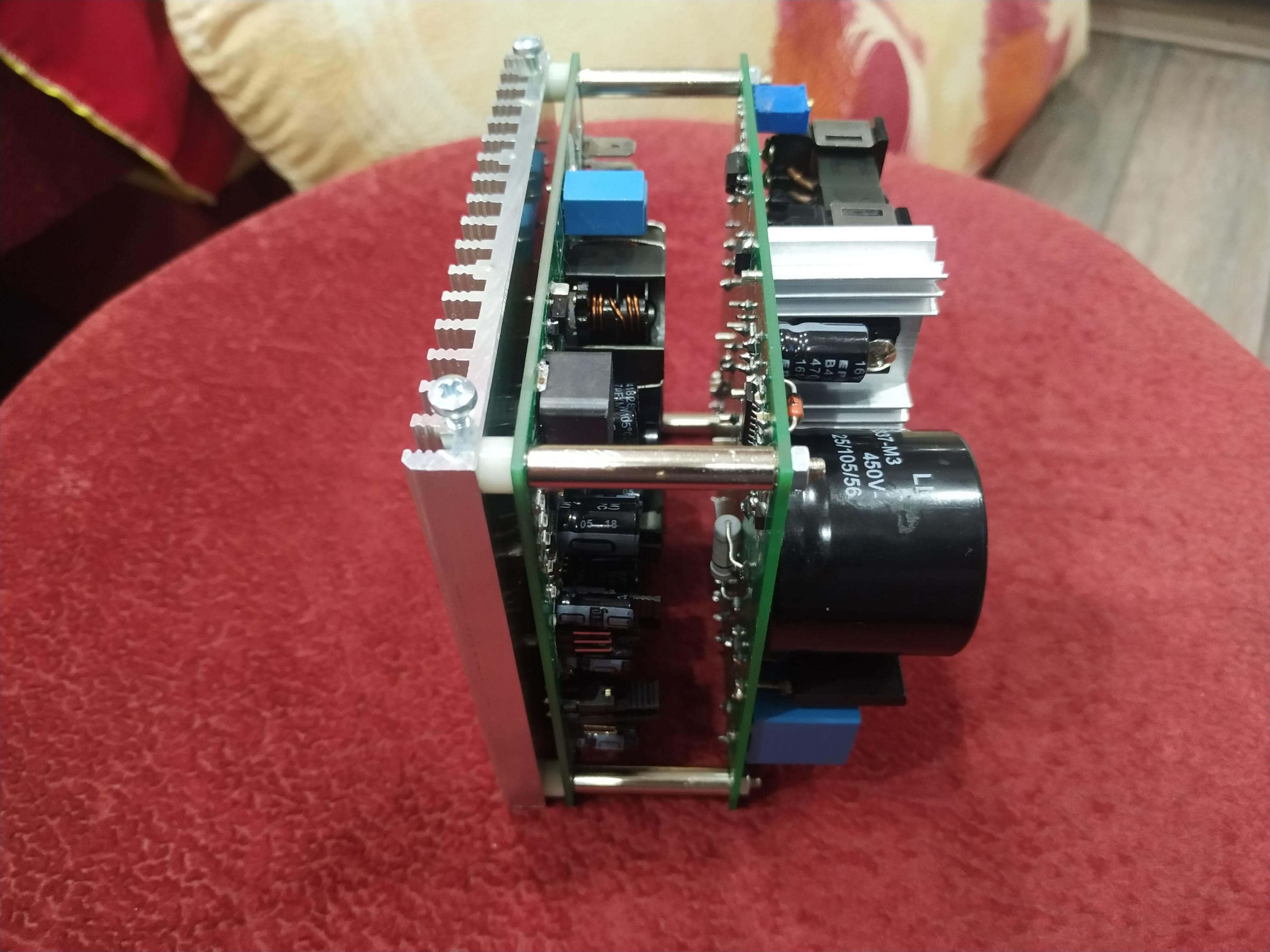

TPA3255 - all about DIY, Discussion, Design etc
450khz 1uf c_out
600khz 0.68uf c_out
Heatsink with fan?
my amp TPA3251 with PFFB
The PCB's desined by me, 2OZ CU
OPamp - TI OPA1652
DC/DC - TI LM5007, LM317 for gatedrive, 7A4700 for anlog section
Power Inductors - selfmade Epcos RM8 N87
Power Cap - Panasonic FC on amp board, FM on PSU board.

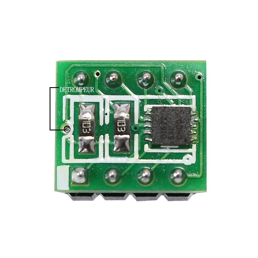

I have been watching your post with interest as I have the same TPA3255 amplifier and also playing with Op-amps.
I think I have the same OPA1622 DIL units bought from china. No markings on the chip. How do I know if they are not fakes. ?? I couldn’t see any markings on your chips from the photos.
Many thanks. James. Devon. UK.
Time test )
I put the OPA1622 inside and testet with my hand mande linear PSU (40VDC)
I also connected my P1 Preamp with some Tung Sol US tubes....
It sounds just fantastic ! Lot of dynamics, sweet and absolutely noiseless.
I need to burn it a bit more... I am really happy for now.
The only issue is the lack of an Anti Pop circuit... IF SOMEONE CAN HELP TO AVOID THIS ?

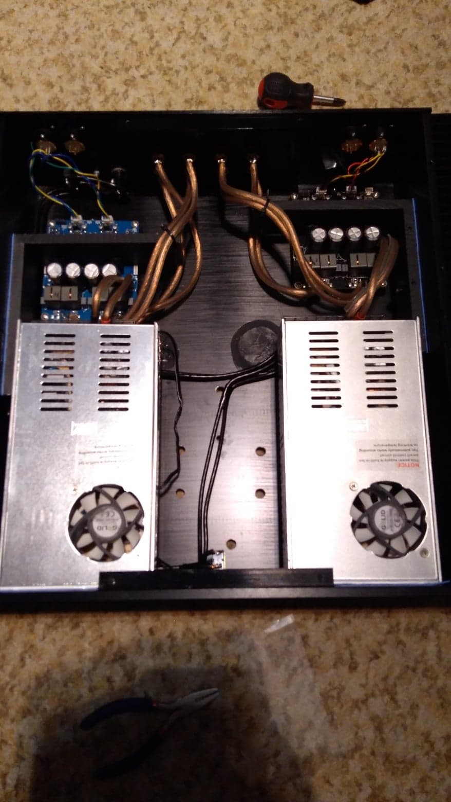

I need some help sorting out hum in my dual 3e tpa3255 build. Each card is a stereo board and I have connected same colors together on the dual inputs. Jumpers set to DIFF(right side). One board for left and one for right channel with biamping in stereo mode. Can this cause hum? I just hooked up a newly built a es90038 DAC in XLR mode and a PA amp so I'm not certain where the problem is. All have mutual ground through the XLR cables. None of the components have ground on the power side since I've built dac and tpa3255 amps double isolated to avoid hum problem.Each card have its own Mean Well psu. I've noticed the 3e board has ground on both left and right side inputs so I tried lifting one gnd cable to see if the small ground loop could be the issue. It did not help. With both signal ground lifted this amp got quiet but the PA amp started to hum! Any pointers to find out where the problem lies would greatly appreciated!
