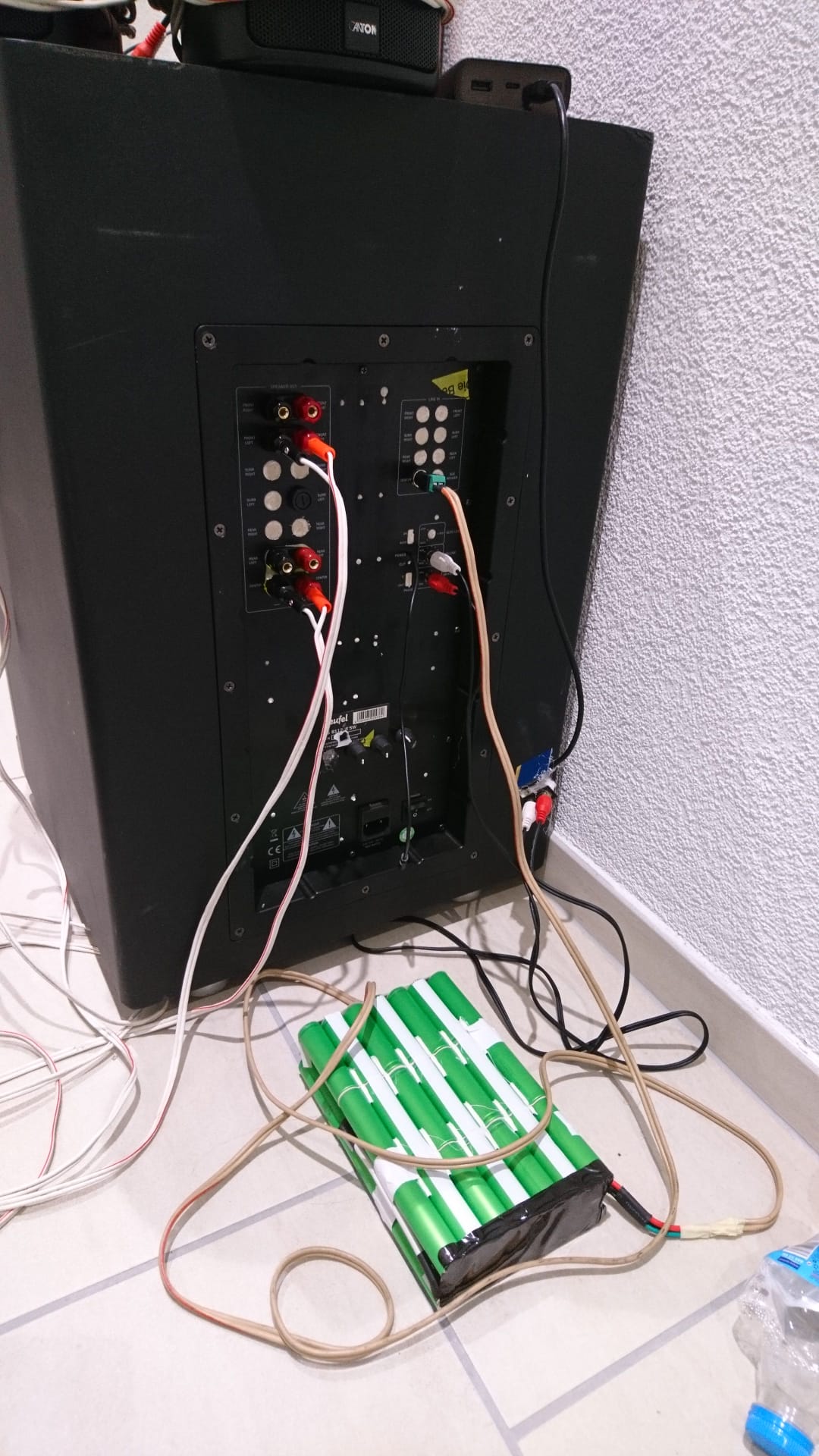

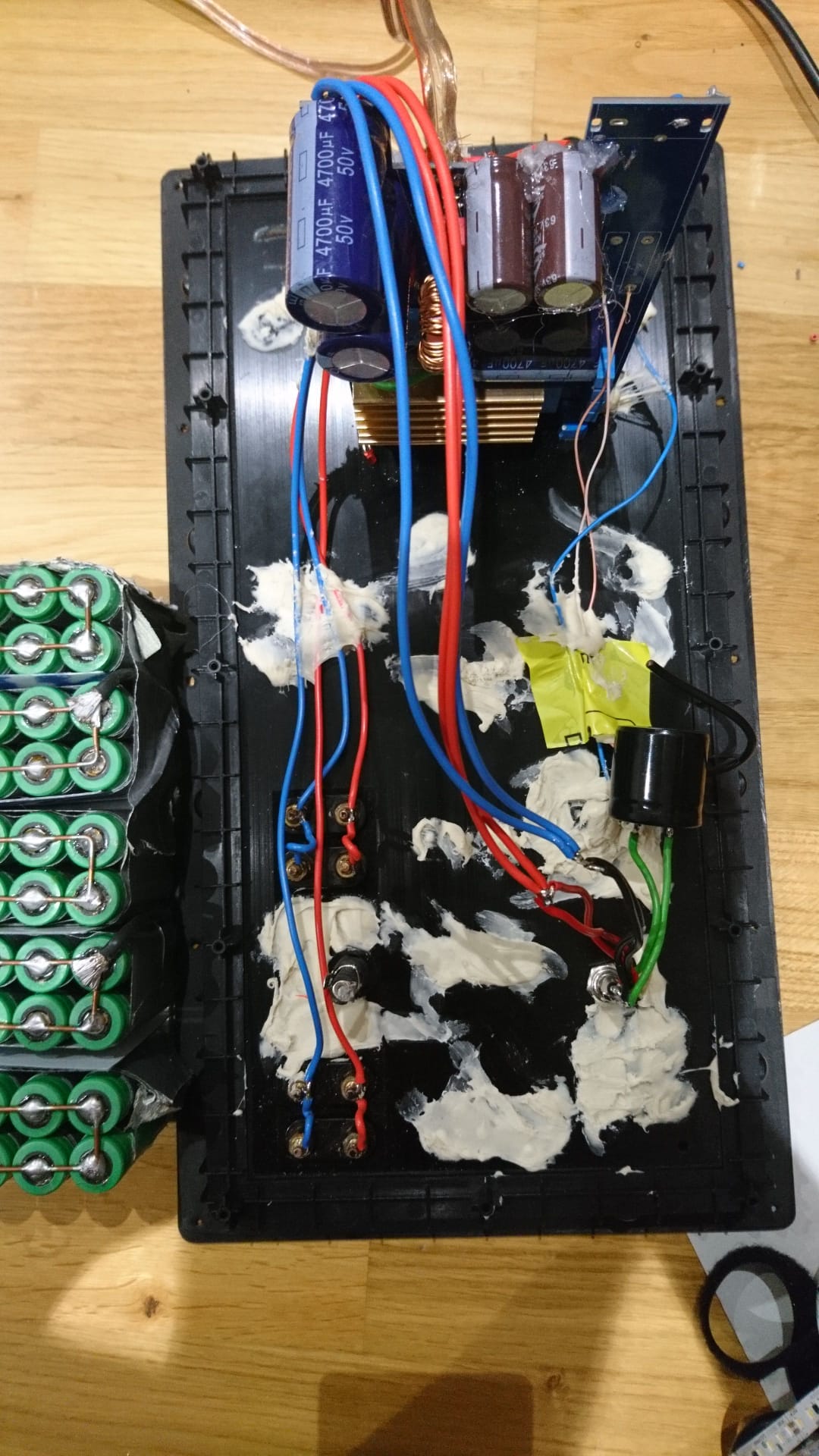

I just finished my "mobile" amp.
Teufel us8118 with tpa3255 powerd by old 10S Li-Ion battery. Audio power is just amazing....with some bass boosted music its heavy.
Power consumption must be false because it showed only under 1A by max volume.
