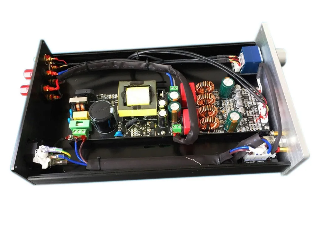

Is it true that allo.com is going to release a TPA3255 amp at the beginning of next year?
It seems to be true... I read it in many other forums.
There is also this "non public" TPA3255 board with an integrated SMPS PSU.
Advanced Integrated Feedback Design with High-speed Gate Driver Error Correction (PurePath™ Ultra-HD)
Signal Bandwidth up to 100 kHz for High Frequency Content From HD Sources
Ultra Low 0.006% THD+N at 1 W into 4 Ω and <0.01% THD+N to Clipping
>65 dB PSRR (BTL, 1 kHz, No Input Signal)
<85 µV (A-Weighted) Output Noise
>111 dB (A Weighted) SNR
Click and Pop Free Startup and Stop
90% Efficient Class-D Operation (4 Ω)
Wide 18-V to 53.5V Supply Voltage Operation
Self-Protection Design (Including Undervoltage, Overtemperature, Clipping, and Short Circuit Protection) With Error Reporting
EMI Compliant When Used With Recommended System Design
Isn't this designed for AC mains operation? So why that
Best regards!
?Wide 18-V to 53.5V Supply Voltage Operation
Best regards!
Isn't this designed for AC mains operation? So why that ?
Best regards!
I think that the seller wrote the generic information about the TPA3255
Check it out :
TPA3255 AMP Module Integrated With High Efficiency SMPS - Sinewave Electronics Co.,ltd - ecplaza.net
This Board is made by SineWave Audio.
By the way, they also made a very serious version of the TPA3251 with a great internal PSU.
Balance Input 300W TPA3251PurePath Ultra HD Analog Input Class D Amplifier - Sinewave electronics co.,ltd
The design is inspired by the IcePower ICE125ASX2
Yes, most probably they just copied informations from the TI datasheet.
Query: How trustworthy can a (Chinese in addition) seller be who doesn't manage or want to publish specified data of his product?
Best regards!
That's weird indeed..... But their Boards seem to be great. On the TPA3251 picture, you can see they use ELNA Capacitors and ALPS volume knob that's pretty cool.
