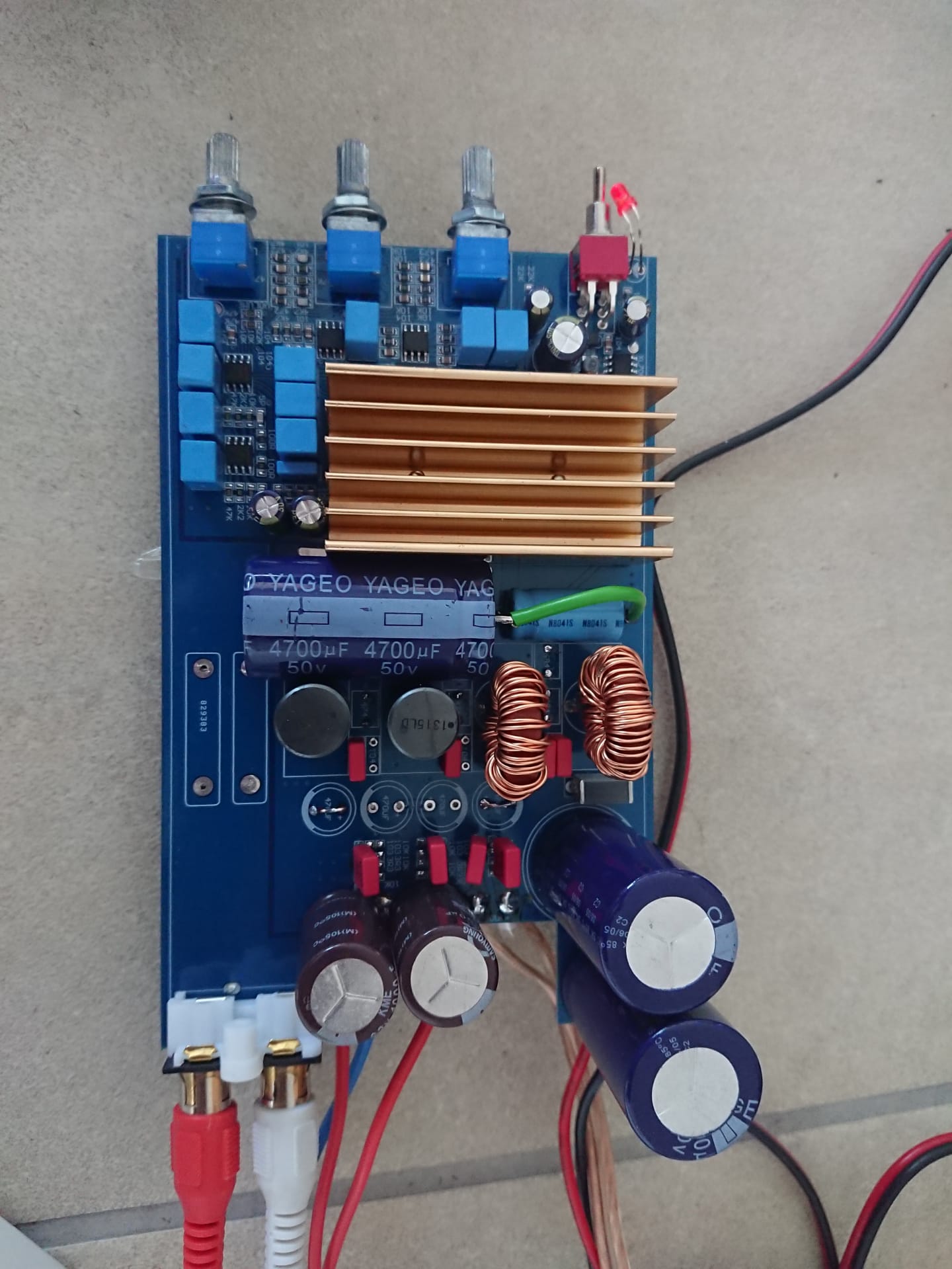

What do you think about replace all 1uF caps for the OPAs? Because of the footprint only MKS will fit. Will it be the better way?
Some people will say no difference, some will say yes difference. There's only one way to find out - and that's Do It Yourself.
Let us know what you find out.

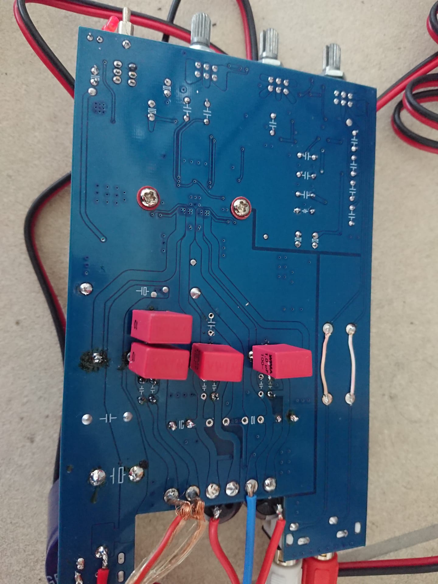

TPA3255 wit WIMA MKP2 outputfilter. Sound is amazing. I'am very happy.
From where did you buy this ?
Hope you have only done the modification mentioned on What is wrong with TPA3255?
