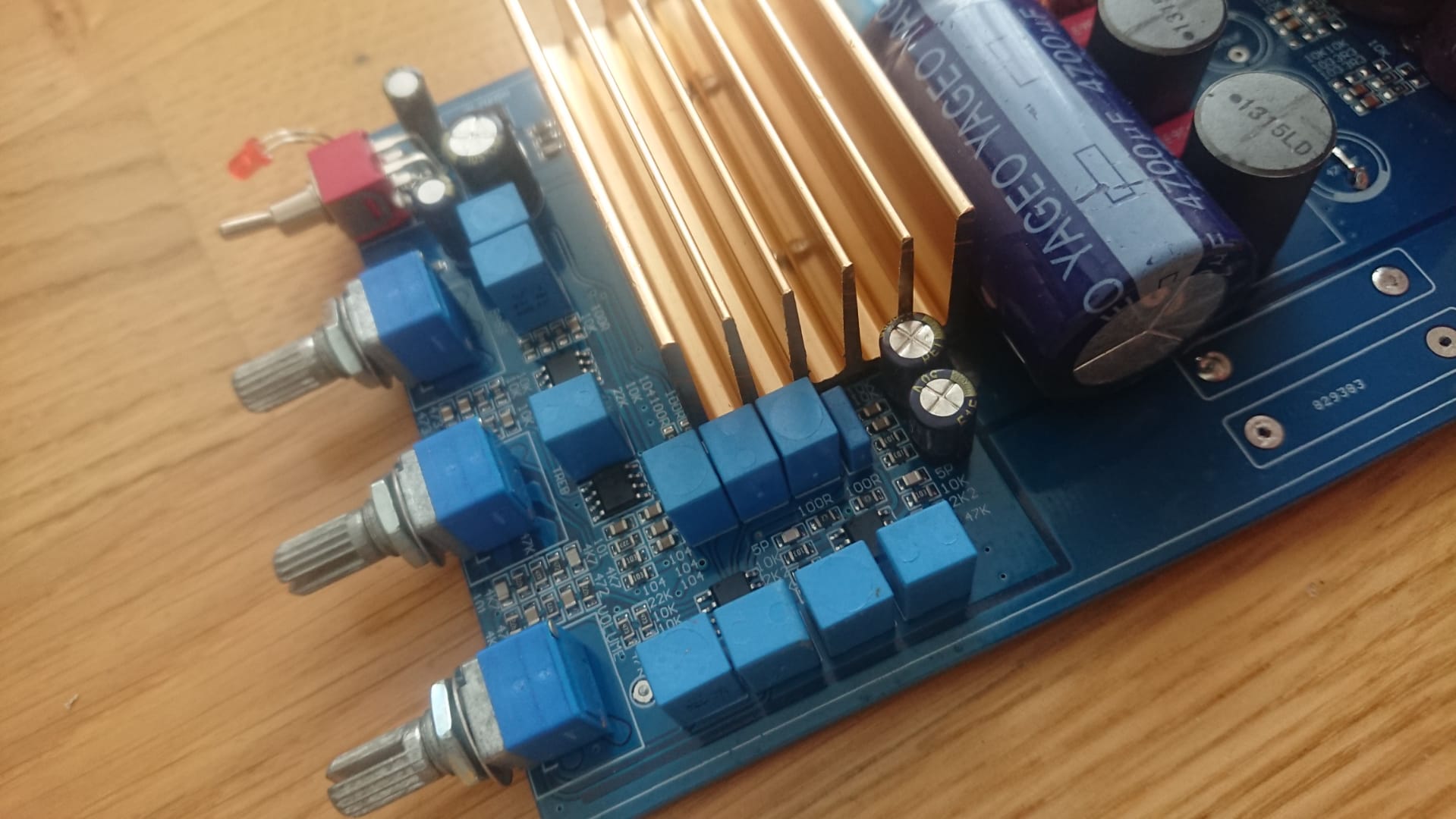

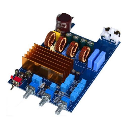

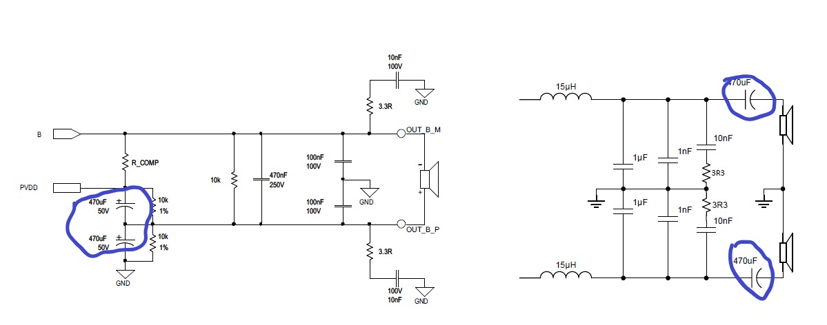

I just ordred just for fun the cheapes TPA3255 2.1 board. I payed 35$ shipping inlcuded.
I want to modd it. change outputfilter and SE capacitos.
I the datasheet the use 470uF capacitor but in the EVM the use big 1500uF.
What will happen if I take 330uF or bigger? I have 330uF 35V LXY for SE-output.
What is better:
Left or right output. Left is from TAS5630 and right from TPA3255
I plan to use:
Wima MKS2-63V 1,0µF
Wima FKP2-250V 1,0nF or FKS2-400V 1,0nF
Wima MKP2-100V 10nF
Change SE output coil to 15uH
What do you thing about this modifications?

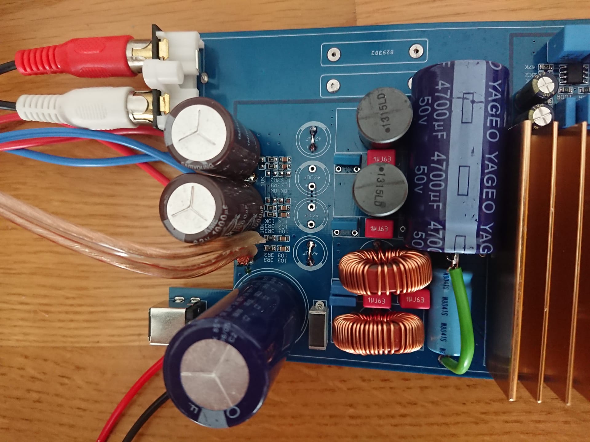

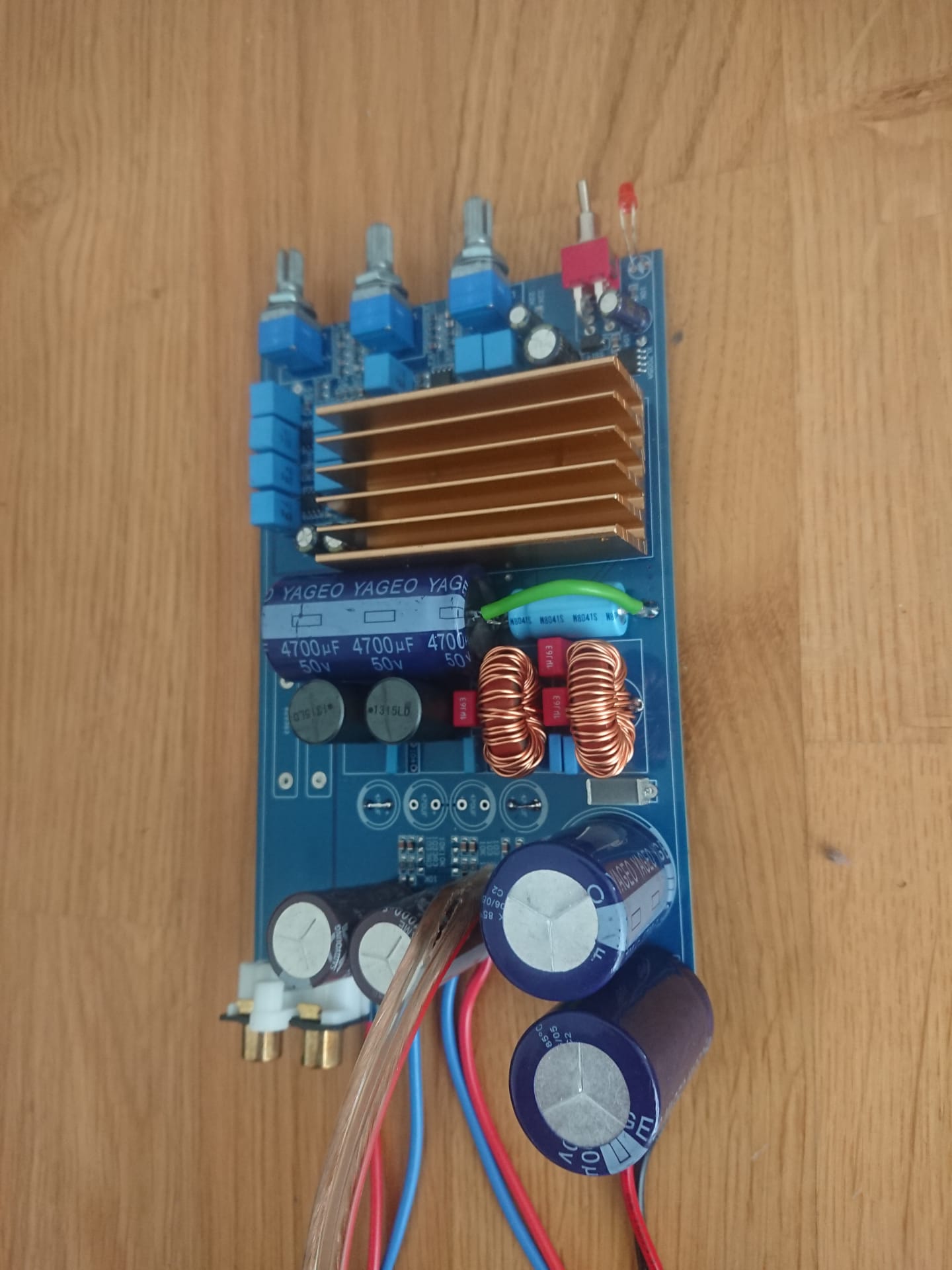

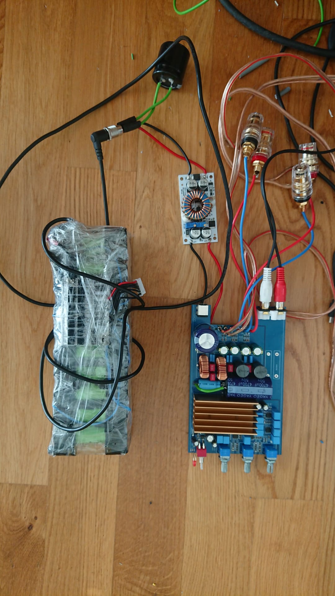

Hello guys
Today I receive my TPA3255 2.1 Board.
I tested it with my bench power supply (max 32V). Stock its not bad. No bachground noise. Impressed... because I read in this thread that it can be bad.
After short test I changed some caps and coils. I want to build it like datasheet.

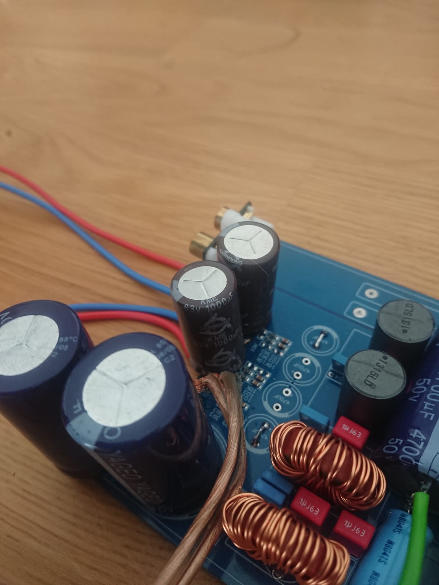

So i also change the capacitor of output circuit.
With all this modification I have 1nF 10nF and 1uF for filter and 1000uF decoupling capacitor. My new RLC meter is not arrived yet so I can not mesure stock coil.
Amp is driven with 40V from step up.
Works great. Party can start

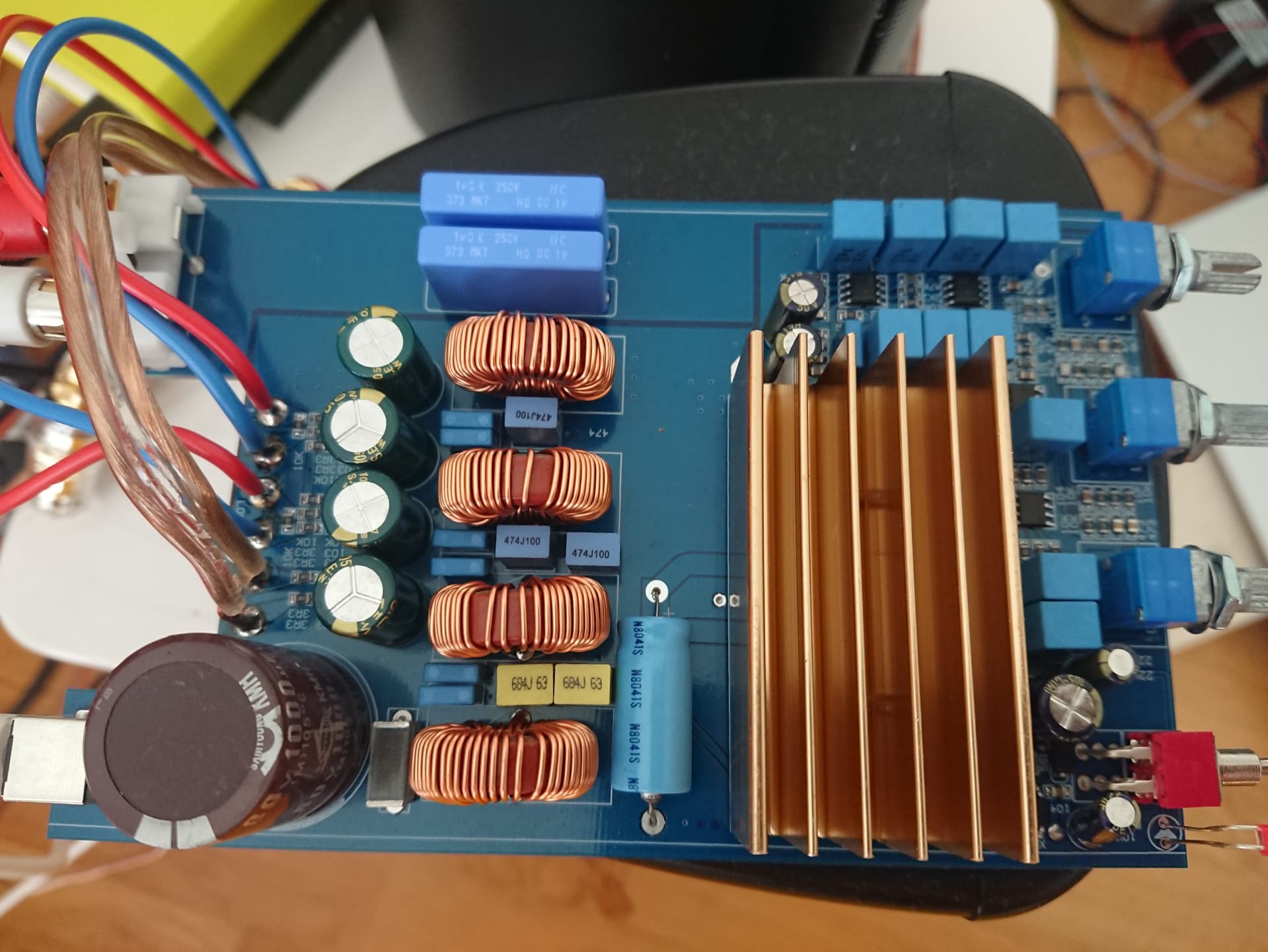

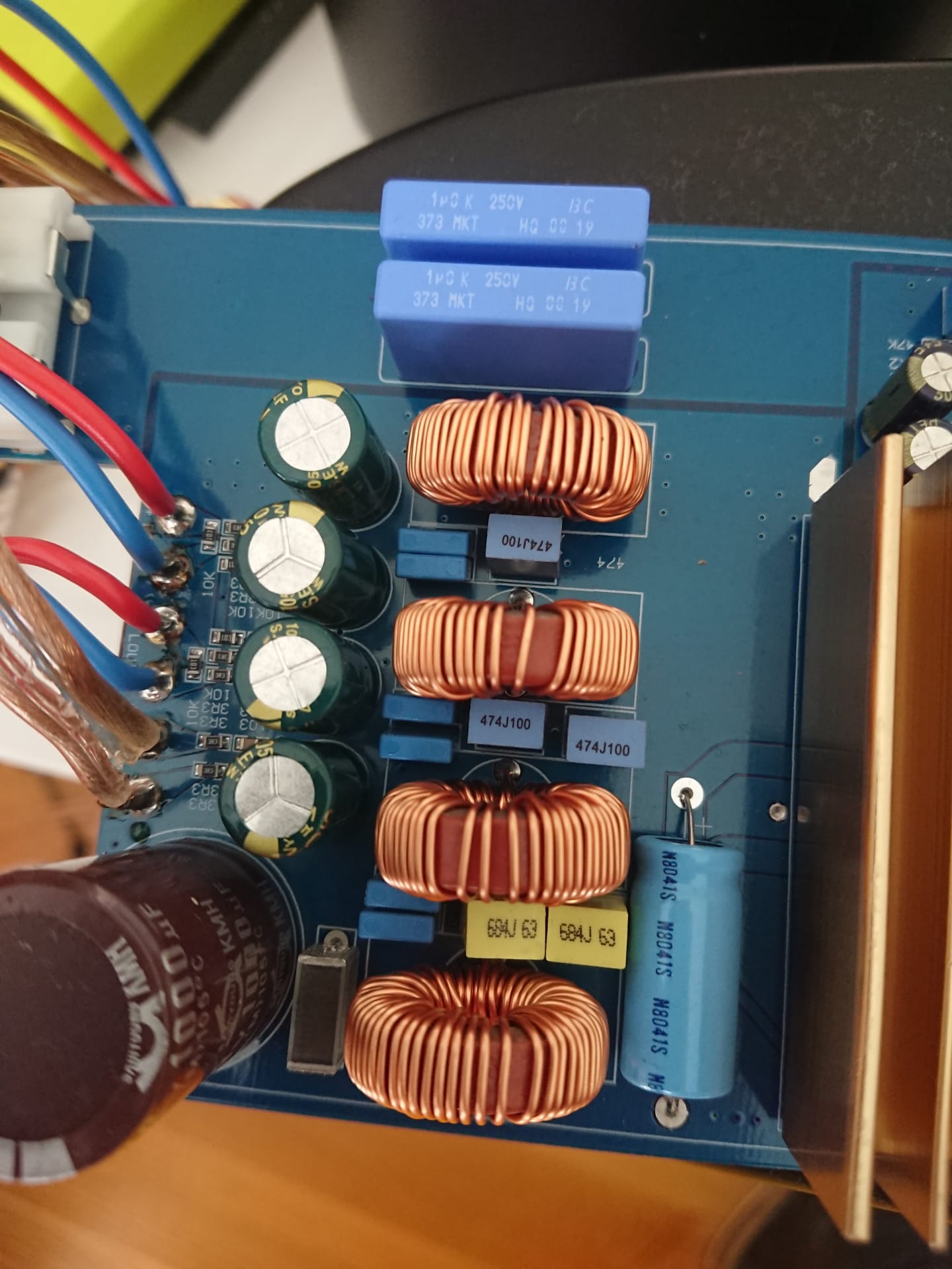

Today I mod the coils. I take same wire but half the amount of turn but paralleled the wire.
from approx 20uH and yet 10uH (measured with china LCR^^)
It could be used in a car but you need powefull step-up.
For your GX-204LE GU you need to take a look on the internet.
With the number of turns halved I would expect a quarter of the former inductance.Nanolized

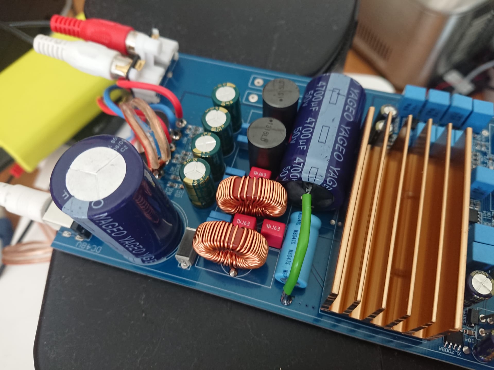

Voltwide nice to know. Amp works great.
I am impressed of quality. Bass is very strong.... I drive an HKTS200 subwoofer (broken amp)

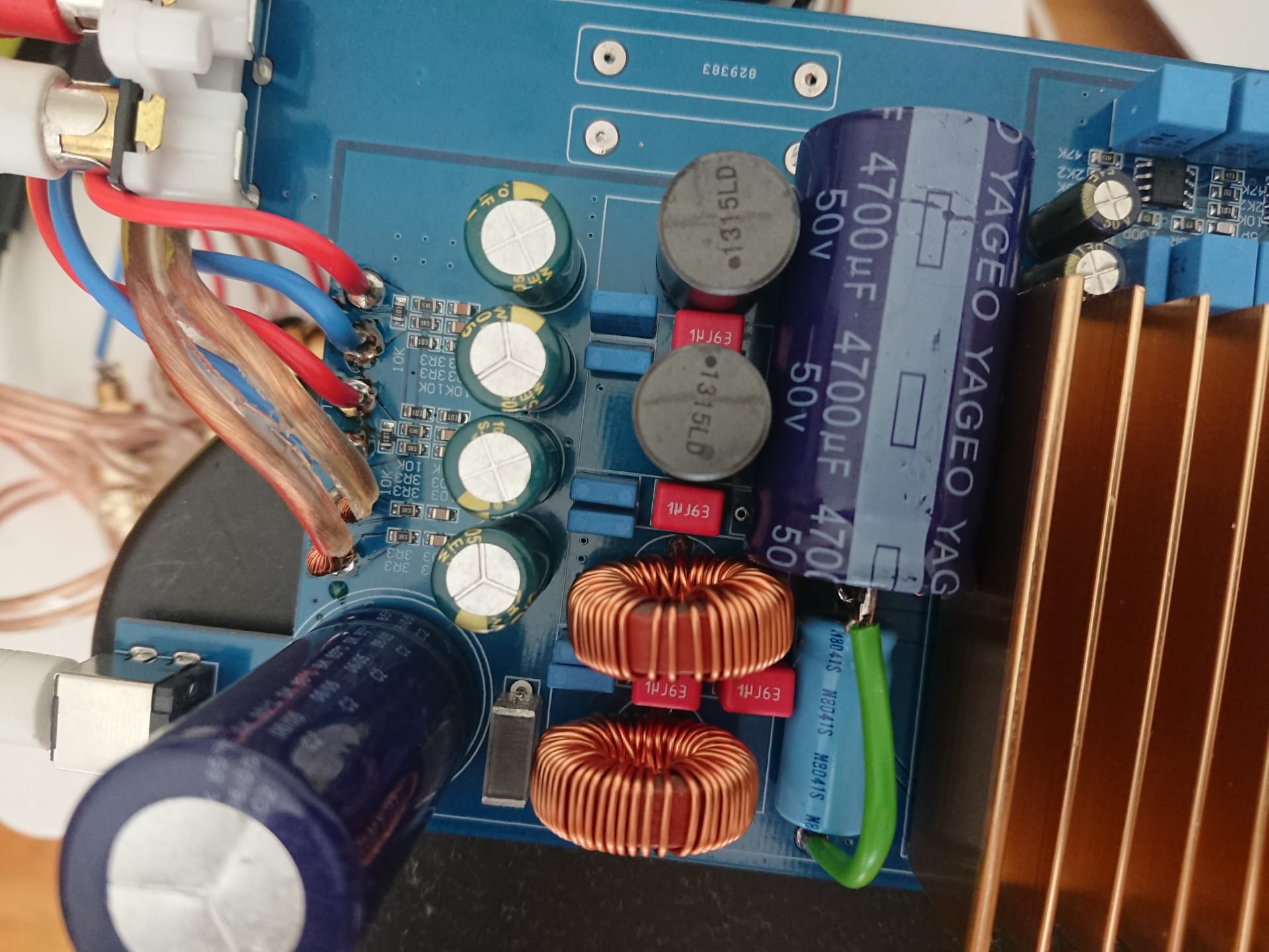

I desoldred the 5.5/2.1mm plug and could place another 4700uF cap. So I have 3 4700uF cap. Not the best I know but they where on my capa box.
I plan to change all caps from output with MKP2. On the dataheet and evaluation board the use only MKP for 1uF and not for the others. Is it not worse the money/changement?
What do you think about replace all 1uF caps for the OPAs? Because of the footprint only MKS will fit. Will it be the better way?
