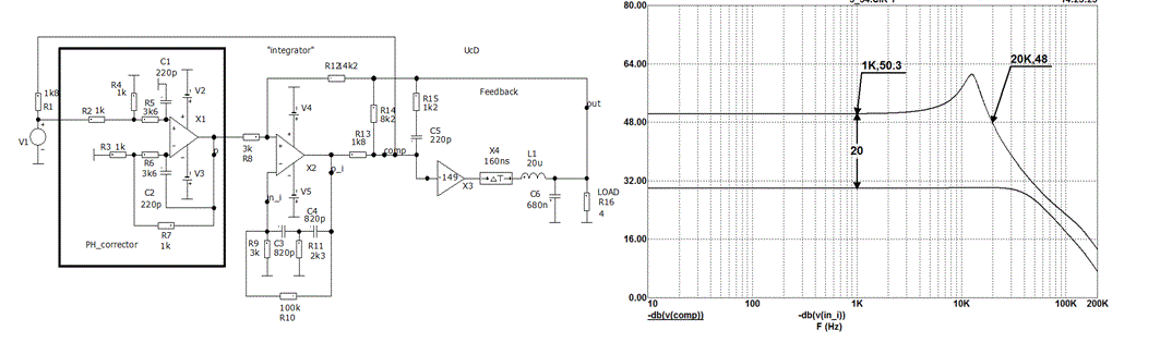

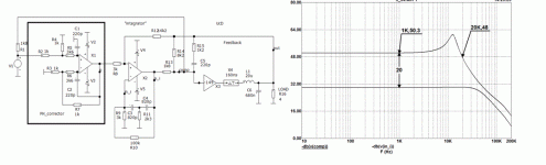

I think he essentially means incorporating the buffer opamp as the front-end of a composite loop (using PFFB); not a huge bandwidth budget to work from, sadly, so the amount of extra loop gain you could introduce at 20 kHz would be pretty limited.
like that
UcD=tpa325x

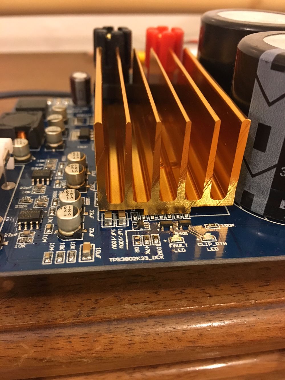

Someone can post pictures in good quality from top/bottom side with heatsink removed?
<snip>

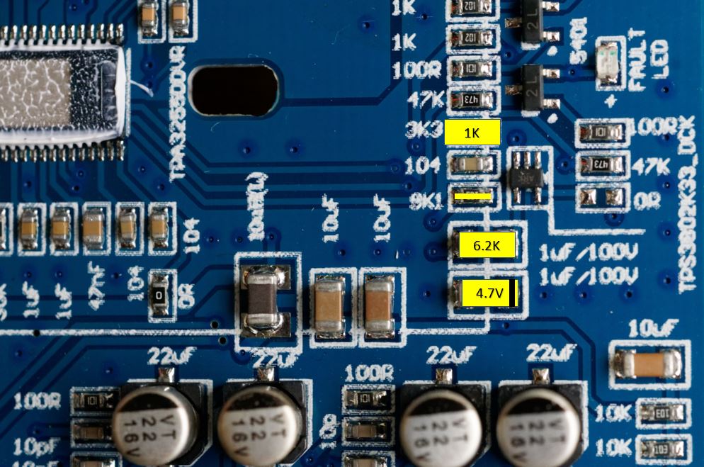

Hi Doc
Here ist my blue chineese board without the heatsink with the yellow Mods
1. Replace the 1K0 Ohm resistor
2. Make a bridge over the 9K1 resistor
3. Replace the cap with the 6K2 resistor
4. Replace the cap with the 4V7 zener
5. Pray that you have made no mistake and that the doctor is right.
But there is no room for other components. Only the 6k2 and the 4V7 would go. the 9k1 bridge is verry difficult.
Is there another way to supress the on and off pop's.
Hans-Peter

TPA3255 Chinese PCB - listening - modding...
I just received from AliExpress, the Chinese version of the TPA3255 PCB. Currently I use the daily t-amp Sure 2X400w (Gremlin). after 2 days listening, and with different styles of music, jazz, classical, pop ... the sound are very clean and transparent.
On the other hand there is a very light ploc ignition, nothing too terrible. No noise when closed. I have 5 TPA311x PCBs and a TAS5613, and the TPA3255 is significantly superior to all points of view.
Finally I prefer it to t-amp Sure (I changed the input capacitors by Obbligato - Sure t-amp). I bought it from this seller.
