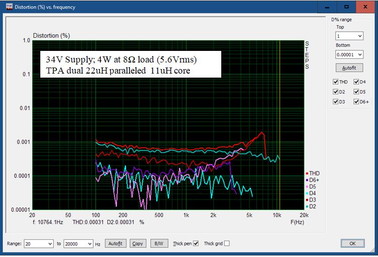

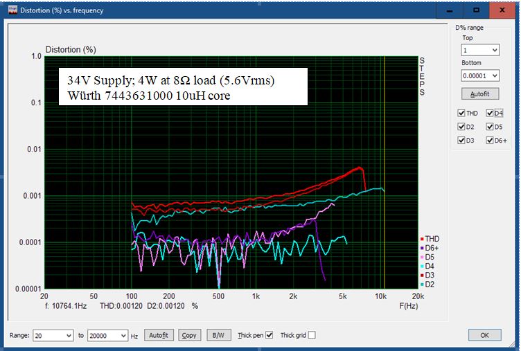

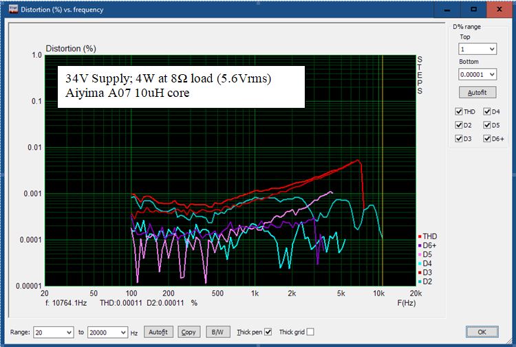

Hi feket663, the inductors are not so bad as it seems. I have this module and tested the cores for a Aiyima A07. Attached the distortion of the Aiyima at 4W with 35V supply and 8.2 Ohm load. The dc resistance of the dual core paralleled to 11uH is only 11 mOhm and they seem to be flat copper wire type.The output filter Approximate match the design. The inductors are 2 x 22 uH, paralelled, = 11 uH as opposed to the original 10 uH recommendation. Unfortunately, better quality, 10 uH Coilcraft or Würth inductor doesn't fit.
If you want to upgrade the sound:
1. put a Wima MKP4 33nF 250V parallel to the 10uF Electrolytic coupling capacitors,

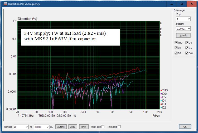

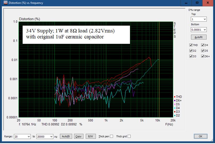

2. exchange the ceramic 1uF (used on this module for the LC filter) to a MKS or better MKP type of film capacitor. See Attachments.

Thanks. I checked the Wurth coil referenced in your measurements, and compared to the Coilcraft used by Texas Instrument in their PFFB document. Your measurements show THD much lower for the Wurth output inductor than the TI implementation of the Coilcraft.
After checking Audioscience review the THD is as expected, so perhaps your measurements are showing the THD lower than it should be ?

but there inductors bulid quality not so goodHi feket663, the inductors are not so bad as it seems. I have this module and tested the cores for a Aiyima A07. Attached the distortion of the Aiyima at 4W with 35V supply and 8.2 Ohm load. The dc resistance of the dual core paralleled to 11uH is only 11 mOhm and they seem to be flat copper wire type.
