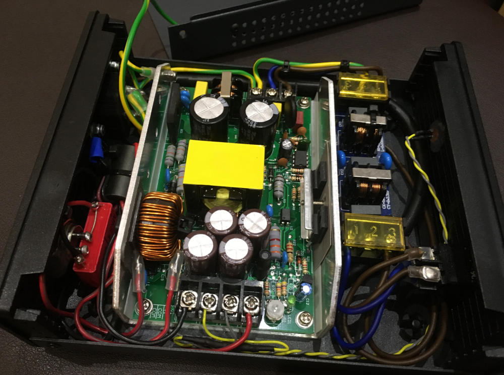

The problem with this switching supply comes from the switching noise. I bought same AD-35036-52 supply to use with my Aiyima A07. On test, I found the switching frequency of the supply was 66kHz, each cycle produced a 'ringing' pulse of 20MHz that decayed within 500nS. More details can be found in my previous post #4189, I included oscilloscope traces there.
So the power supply is not great but again I think it is great value and perhaps in-line with the cost of the amplifier. So far I am very pleased with the price vs performance.
My attempts to reduce the switching spikes had only a very small impact. The problem with any add on filter is the balance between a high impedance (attenuation) for the pulses and a low impedance path (low loss) for the DC supply. On the PSU output I fitted an RC filter and ferrite choke.
I also found on the A07 that the TPA3255 switching noise was poorly contained and I suspect that the filtering between the analogue and digital sections are implemented badly. I hope that the A08 is better in this regard. A photo of power supply with my added filtering is attached.
