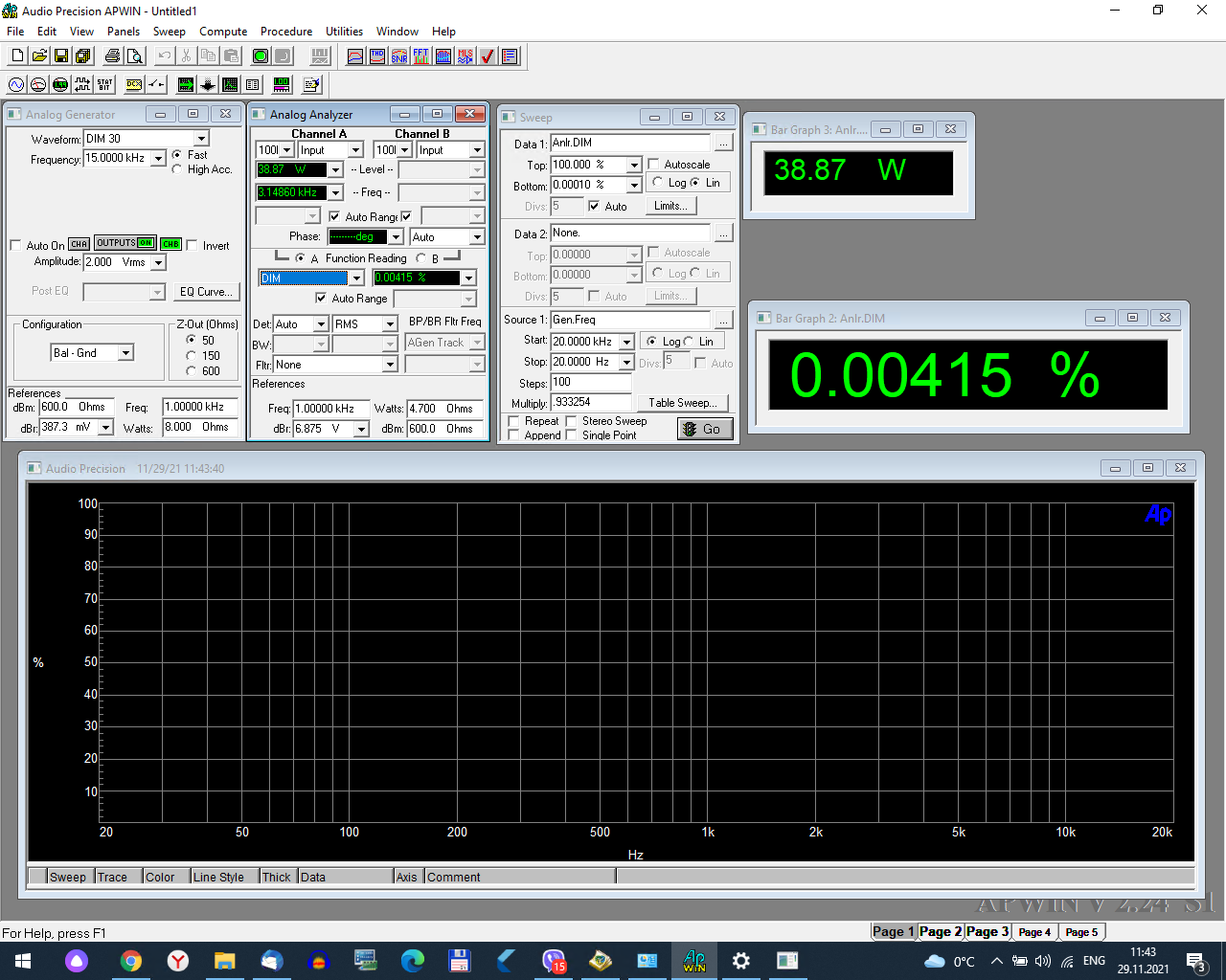

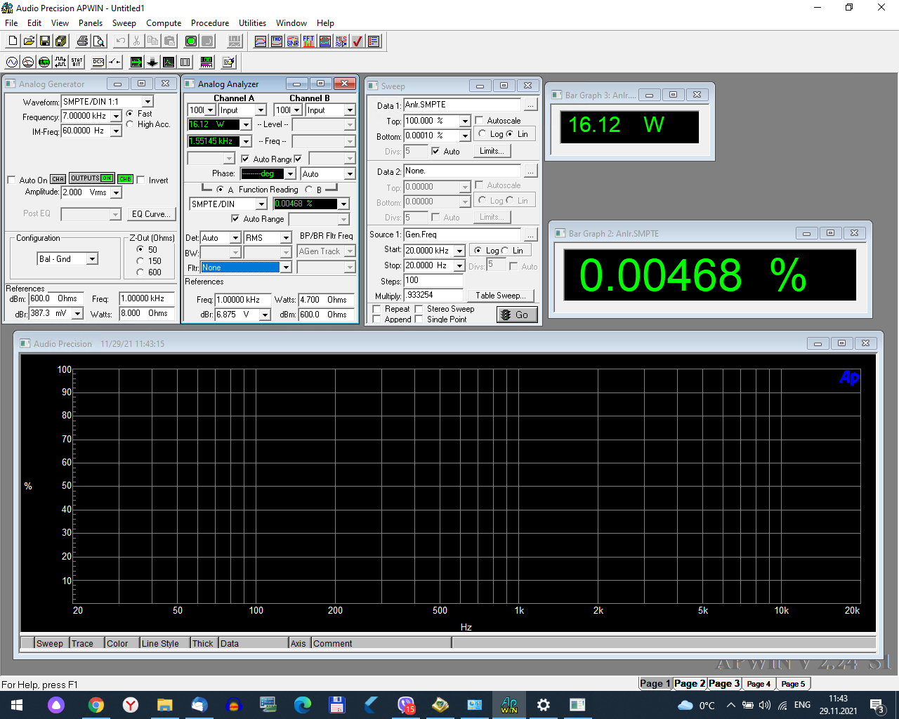

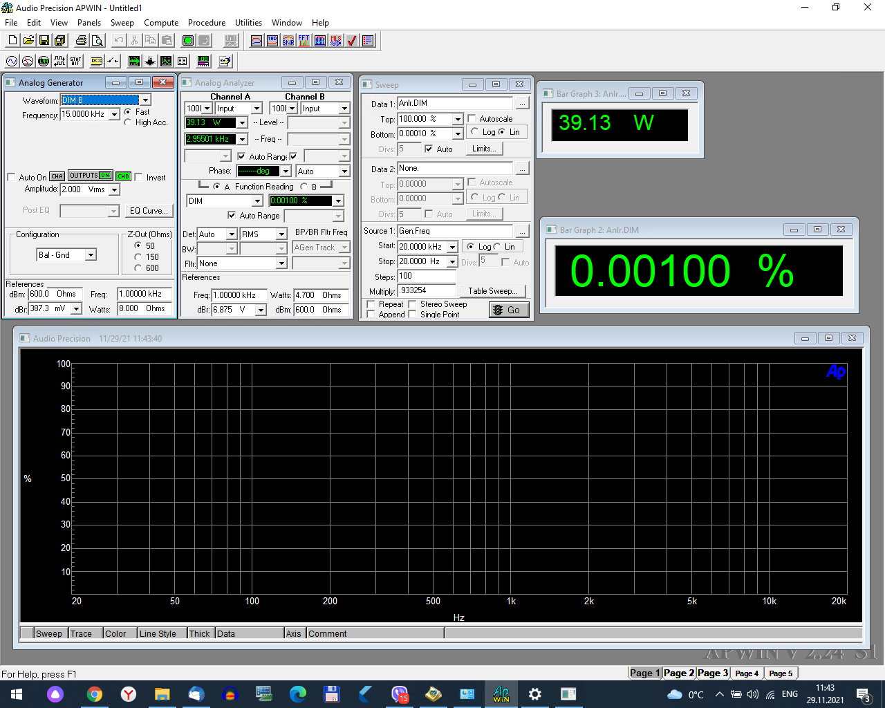

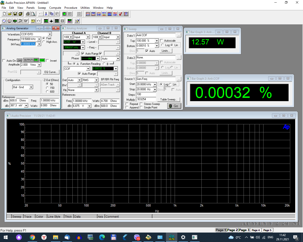

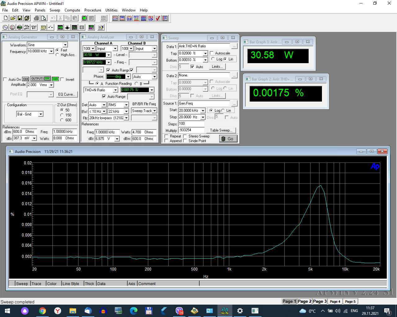

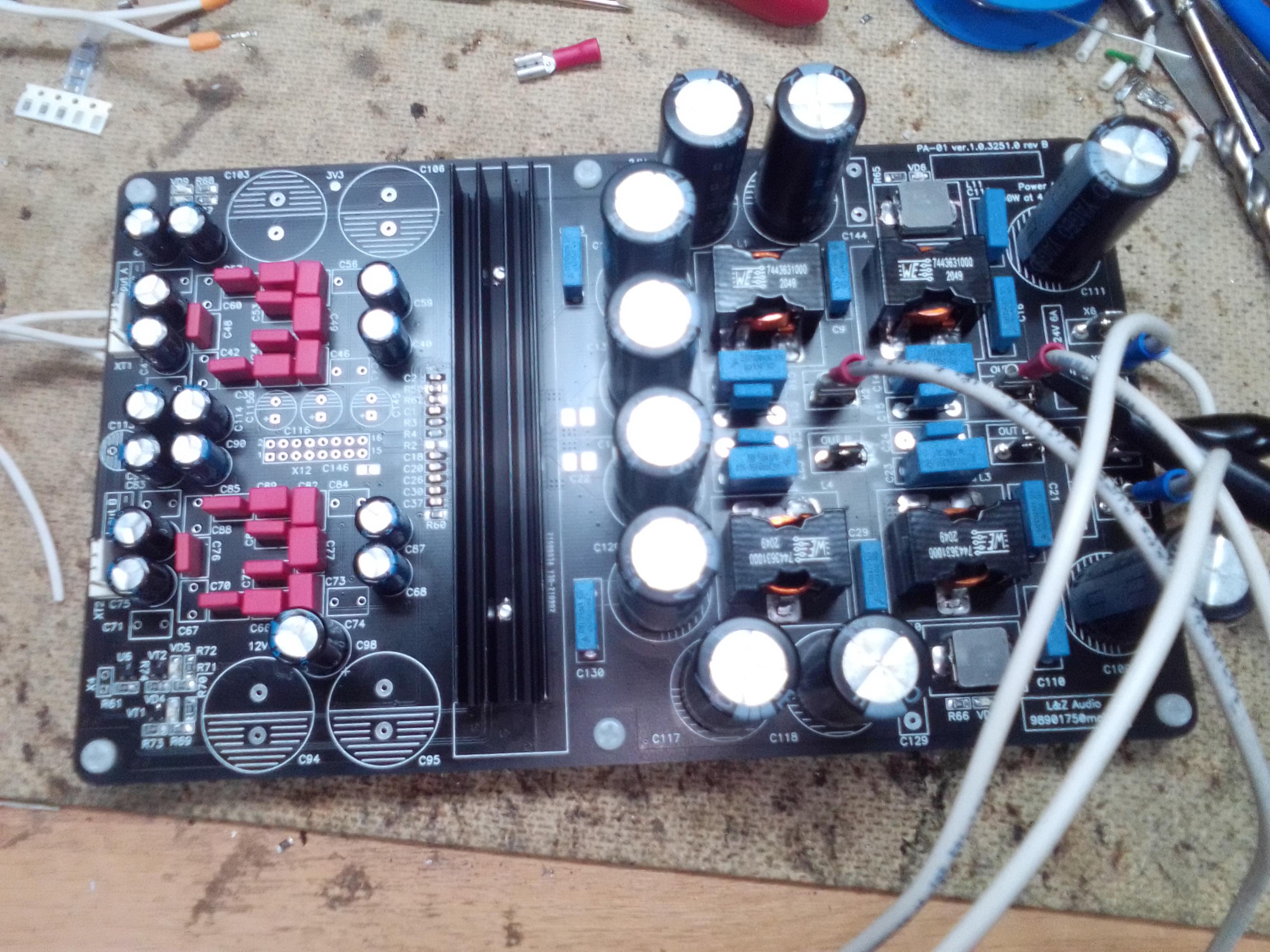

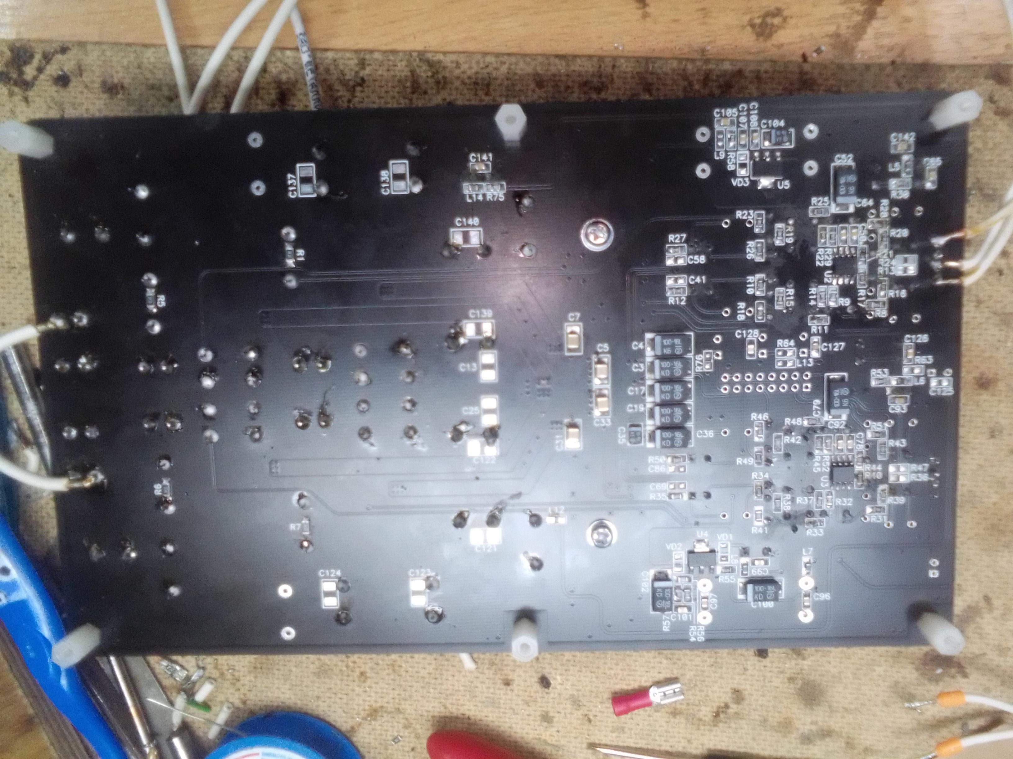

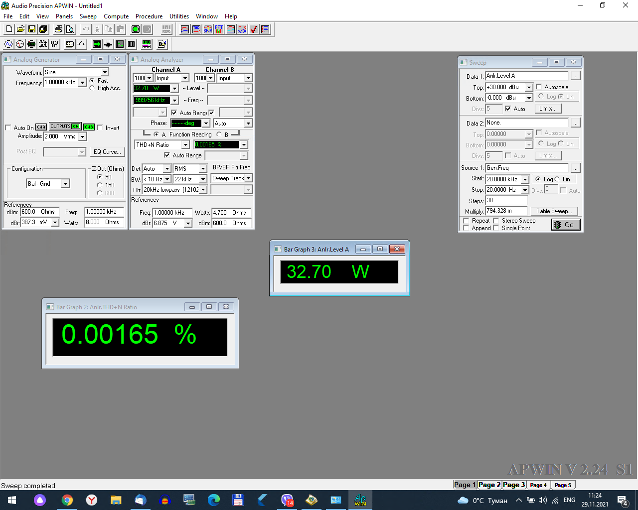

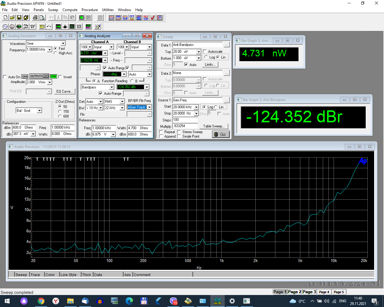

TPA3251 amp
Hi!
It's my variant amp on TPA3251 (BTL mode). 24V power supply, 30W output power.
Balanced/unbalanced 2Vrms input.
Hi!
