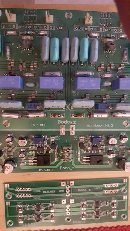

what is 0815?Did you mean the voltage stabilizer 7815? The fact that it's noisy. I used one of the Texas TPS7A in my phono preamplifier. In the JLE power supply you have to power the TPS7A op amps. Do you write about it? Because if they are all so badly done, why should they replace the capacitors for 5-10 $ each, because that's how I understood your comment.
I apologize in advance if I added a picture incorrectly because I do not know how it is done well here so as not to annoy anyone. At the bottom you have the TPS7A variant and together with the PCB a power supply on discrete elements
regards
regards
In 99% of the China TPA3255 designs is a simple switcher LM2575/ LT2575 with ~50khz switching frequency
Layout ist also mostly Not good.
You can measure this 50khz Signal in OPV supply , GVdd supply
And also Output
There is no decoupling between analog and digital Part.
And also Output
