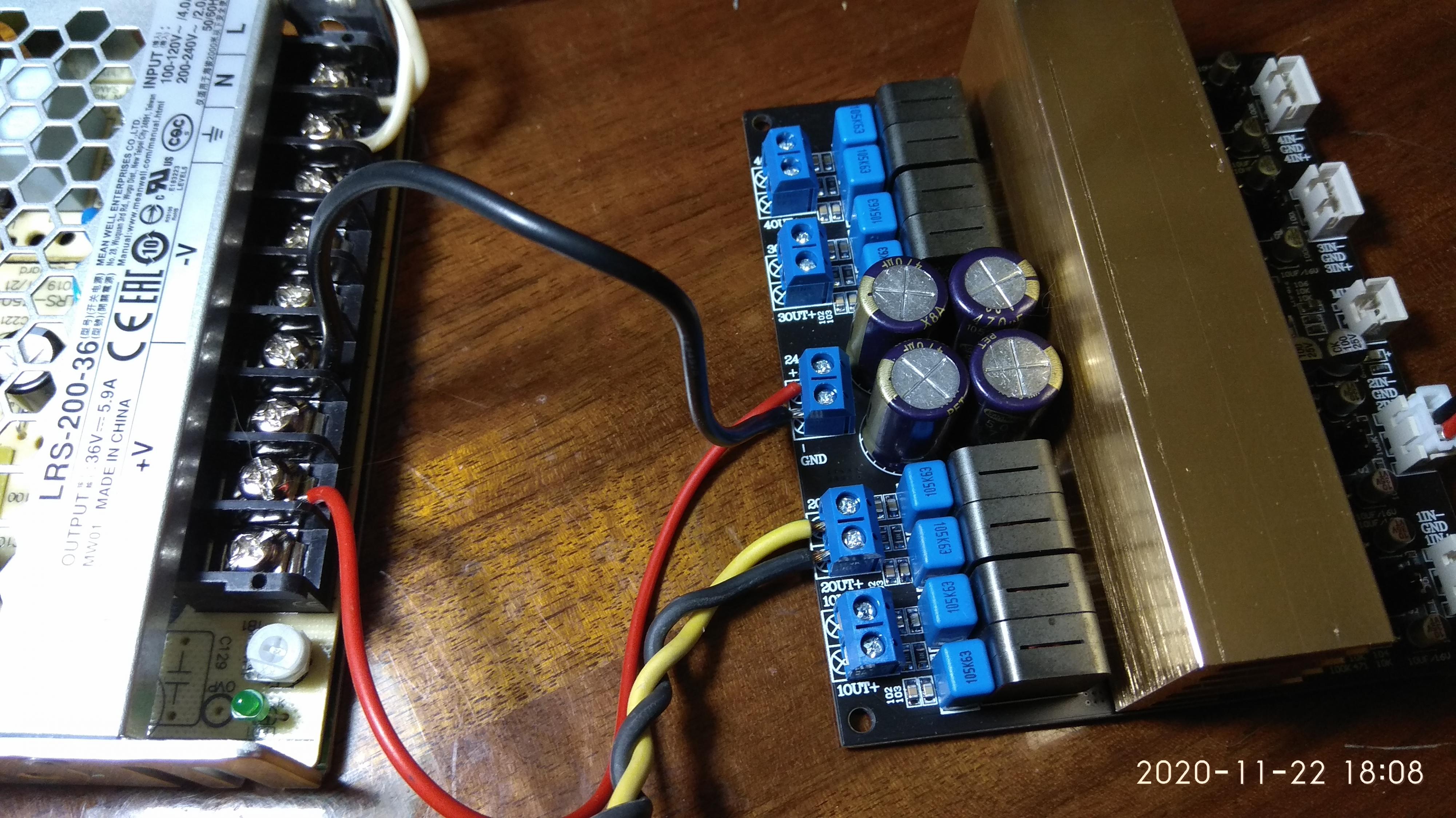

I have a few questions about this amplifier.
I connected it to a 200 watt 36 volt power supply.
When a signal is applied to the input, the amplifier goes into protection ...
What could be the problem?
For future reference and in case anybody wants a nice 2.1 amplifier, I managed to put one of the chips into PBTL mode on the following board.
Second question.
How to connect the load at PBTL?
How do I apply the input signal (third question)?
P.S. what power supply do you use with this amplifier?
Sincerely, Mykola.
Forgot to upload a photo.

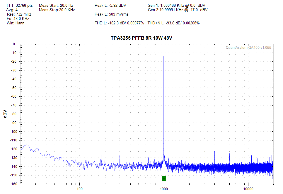

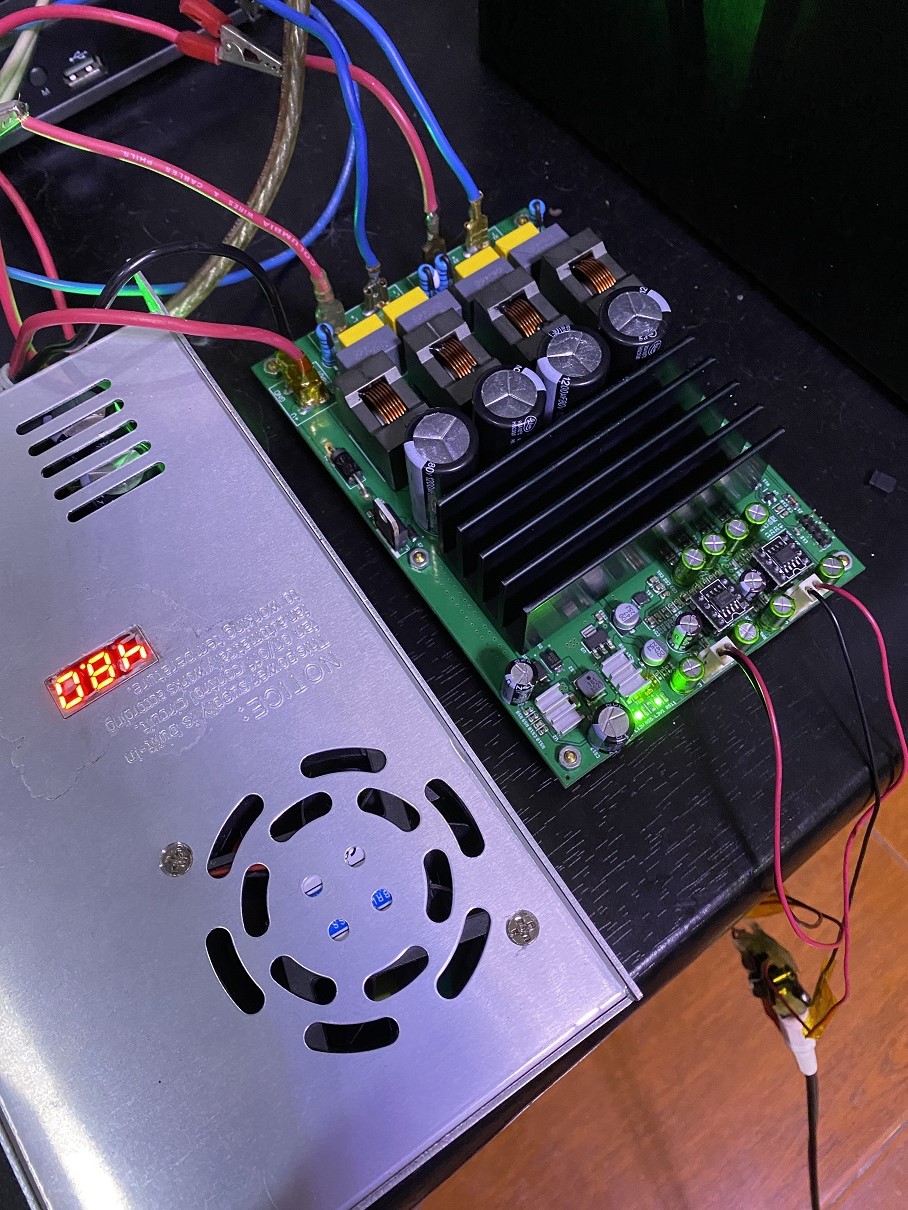

My TPA3255 PFFB can get 0.0007% THD and 0.0021% THD+N just by using QA400 + interface.
10W 8 ohms and 48V DC supply,
I believe the measurement can get lower with AES17, AUX-0025 filters and AP analyzer.

Hello Daniboun
The numbers above are incorrect.
Purifi Amp has about 0.003 THD+N 20-20Khz 5W to 133W.
Bosc Gan , depends on what you see. As far as THD levels we beat them already (above numbers)
Our amp will be independently verified by Amir and I guarantee that our numbers willl be 2-3db better (since our AP floor is not as good)
At last , this is not about THD only. The SQ of a class d is not only AP numbers but multiple noise reduction techniques .
For those of you that know our TPA3118 design ,or for anyone else , you can check indepandant reviews and measuring on Amir site. We have reduced noise on output for example , something that's not taken into consideration on those forums.
Yes DrMordor design seems to be very competent , but experience in class D is crucial . Show me the noise on output , EMI levels , THD. Once you can tame those you can have a good sounding Class D design
As for us , we are still doing the incremental work on our AMP and when its ready we will have some units sent to test.
Yes you can use loop gain to reduce THD and the math makes perfect sense. However we approach this differently. Make a LLC quasi resonant, dual power with noise at 1uV (tested on AP) or less (up to 3A). Use best inductor and multiple C in parallel for low distortion . Use RDC snubbers on outputs to eliminate the oscillations. Design the PCB for low EMI. Why rely on feedback when you can design for ultralow distortion in the first place ?
Time will tell if we chose the right approach .
