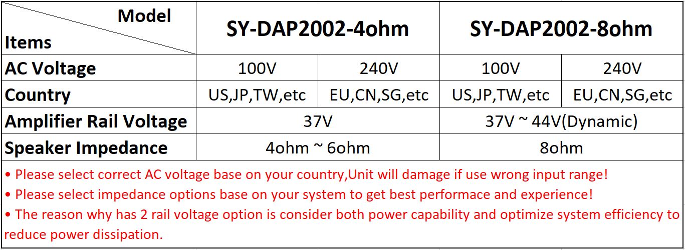

Can anyone here clarify why the 3e audio TPA3255 All in One has an 8 Ohm and a 4 Ohm version? Will one make more power than the other? or is it the heat generated as I suspected?
hope this help understand which options you should go for.
in other word, you still can run at 4ohm on 8ohm model,but should not kill very high output as it may over power supply capability(amplifier is constant voltage output,the lower load the higher current draw from power supply).
also,the rail voltage configuration is changeable by DSP F/W,that is say,you can change 37V to 44V or 44V back to 37V for some reason want to pair different speaker, or getting more head room or want less power loss.
