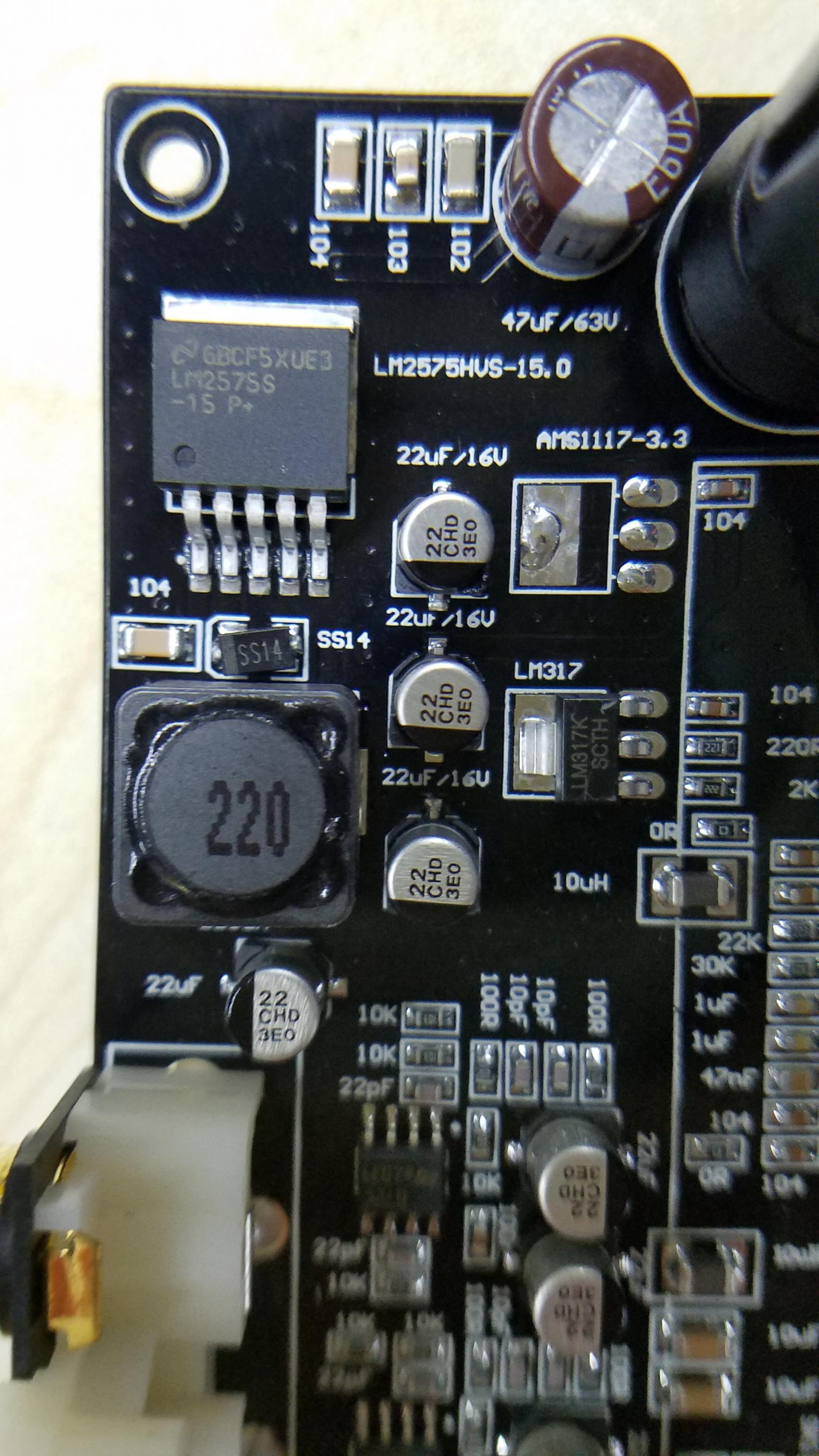

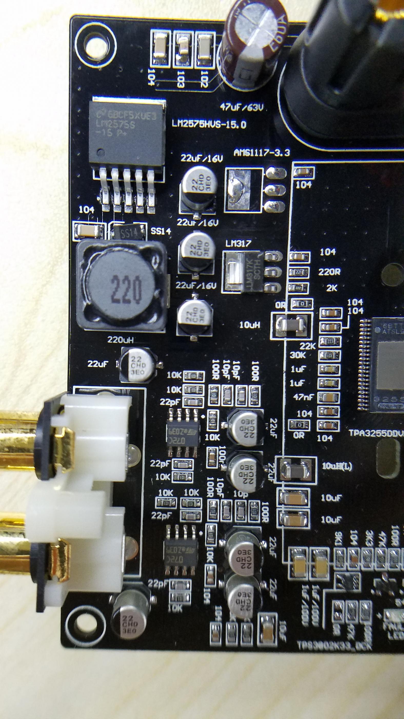

Finally arrived...yuan jing board that is...
Started playing @23vdc...convertor now set @32vdc.
Not noisy...
First (cold) impression:
Seems a little warmer sounding than de 3e-audio board.
Good imaging, good bass extention, good details...
Make no mistake, both are very fine boards...but the YJ board may be a hit for less than 50 euro, shipping included...
3e-audio board looks a little more industrial, very neatly built...
YJ board looks more like DIY, but everything seems ok quality wise...

For what reason?Someone should design a discrete inputstage
Looking at pictures earlier I think these were used then:
3eaudio: njm4580
YJ: tl072

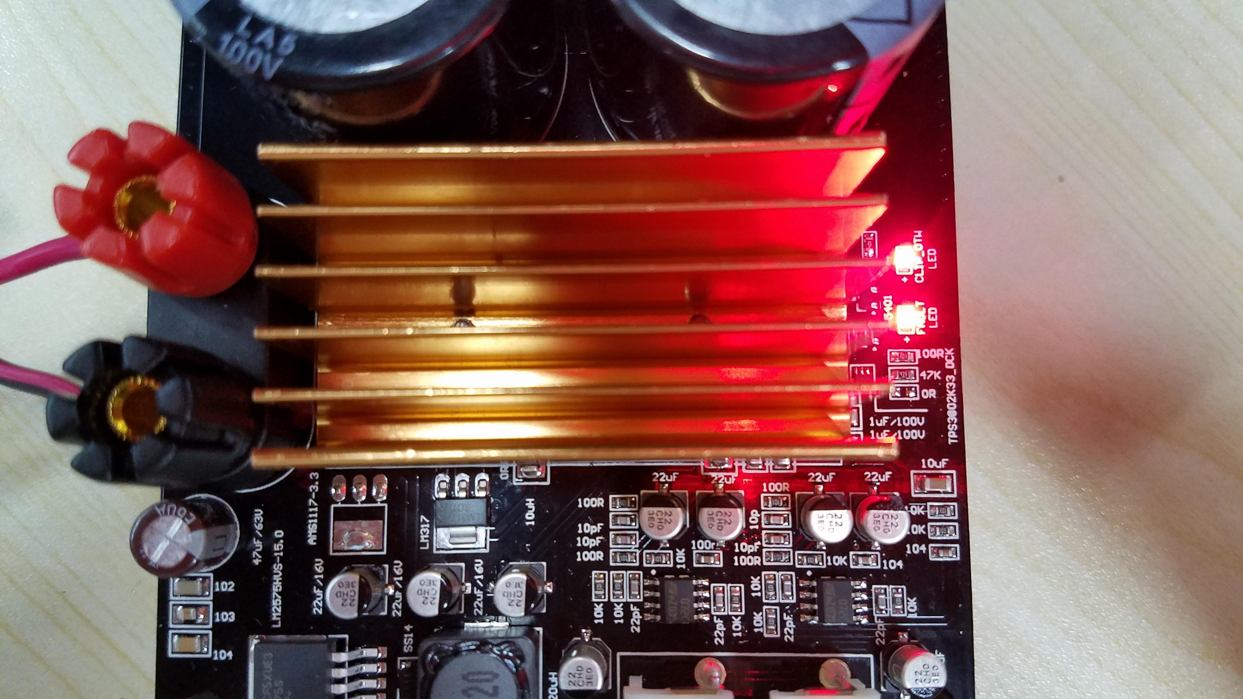

Hi did you check this board very detail?i am agree with you that this cheaper board is good for DIY but now i am getting disappointing.
i have some problem on it.
1. there is a very loud 'POP' noise when power supply drop during playing music through my phone, now i need to stop my music first before pull out the power supply......
2. the display LED always ON,i check the datasheet that it's' for clipping and fault indicate,now i don't know when it will clip or fault since it always working.(i did ask the seller but he said it's normal)
3. there is one IC not mounted,but the picture show on the selling page,it does has.(i did ask the seller but he said it's normal)

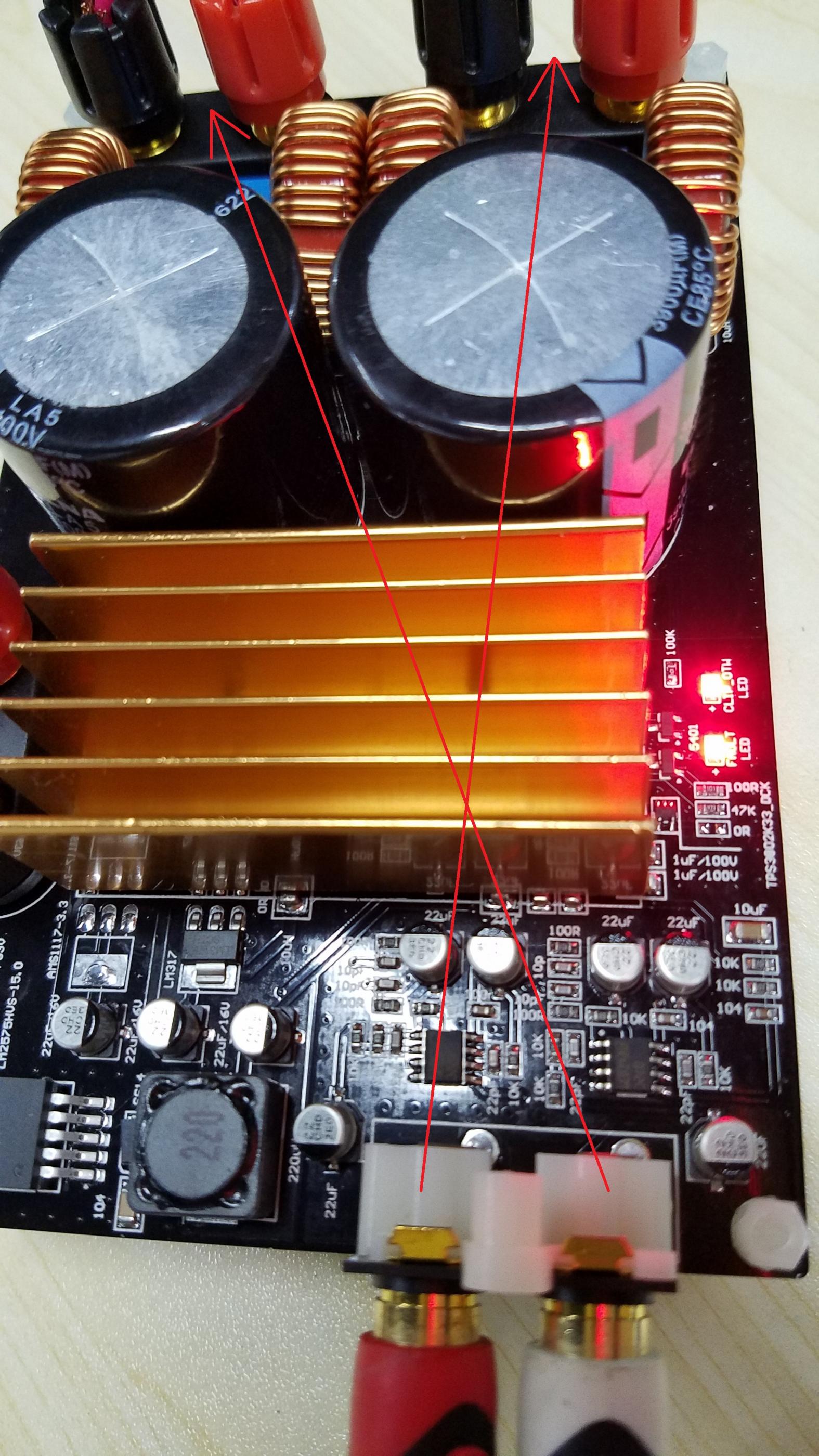

4. the RCA input and speaker output is not symmetrical,i mark in the picture.

this board sounds almost same with my TAS5630 board,still a little be far away from High Fidelity.
Maybe i need ask friend to have some measurement on it to see what is go on.
What is the problem if the input and output are correctly marked?4. the RCA input and speaker output is not symmetrical,i mark in the picture
In any case, you can check which input is appropriate for the output.
