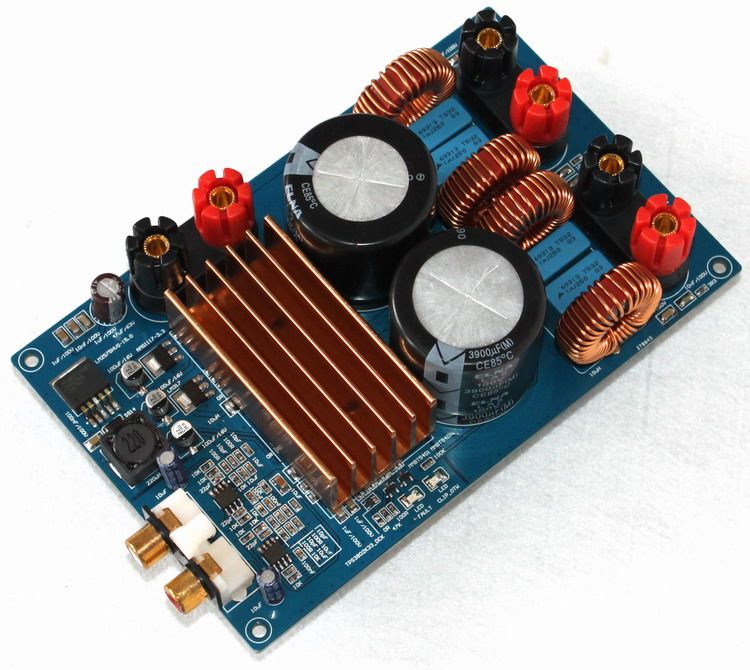

For tpa3255 there seems to be additional LC filtering after the 317, but seems to me the opamp inputstage is not after lm317, well will see when people receive these boards.

LM2575 operating frequency and tpa3255 outputfilter peaking frequency, currents with 3255 and fullrange chassis speaker could get interesting.
What's the filtered output feeding? 100uF won't have low enough ESR unless a polymer (which will be an expensive solution). Better to add some ceramics in parallel with the 'lytic.
Isn't this information a bit useless without knowing the impedance curve of the cap and the switching frequency + ripple current of the converter?
You can get 100uF with 1R at 100kHz and/or 30mR at 100kHz.. both are 100uF. 😕
It might give 16dB attenuation at 52kHz, if the 22uF isn't an el-cheapo.
What ESR did you assumed within the formula?
It was a seat-of-the-pants guesstimate, so it could indeed be useless. We know the switching freq (52kHz) - why would we need the ripple current? I was assuming that this was an LC after the buck converter - perhaps my assumption's wrong.
I'm interested in the 100uF/16V with 30mohm ESR which isn't a polymer. Link please?
I assumed 1ohm ESR for the 22uF.
You're right mate, it needs to be an aluminium organic polymer formula at minimum to get down to 30mR with this low capacitance at 16V. But if you go for 25V+ and double the capacitance, you can find some from i.e. SunCon (Me-Wa, Me-Wg).

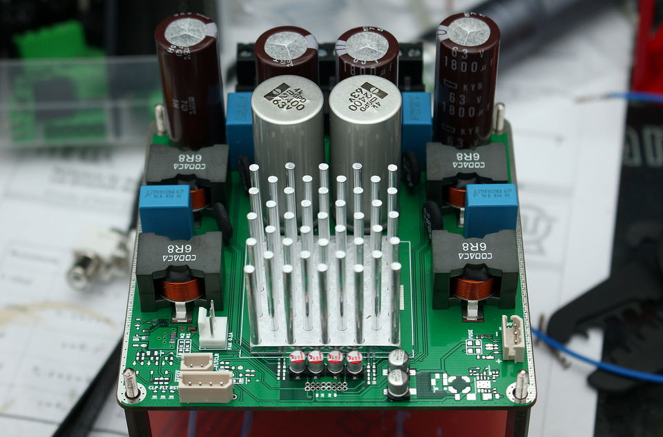

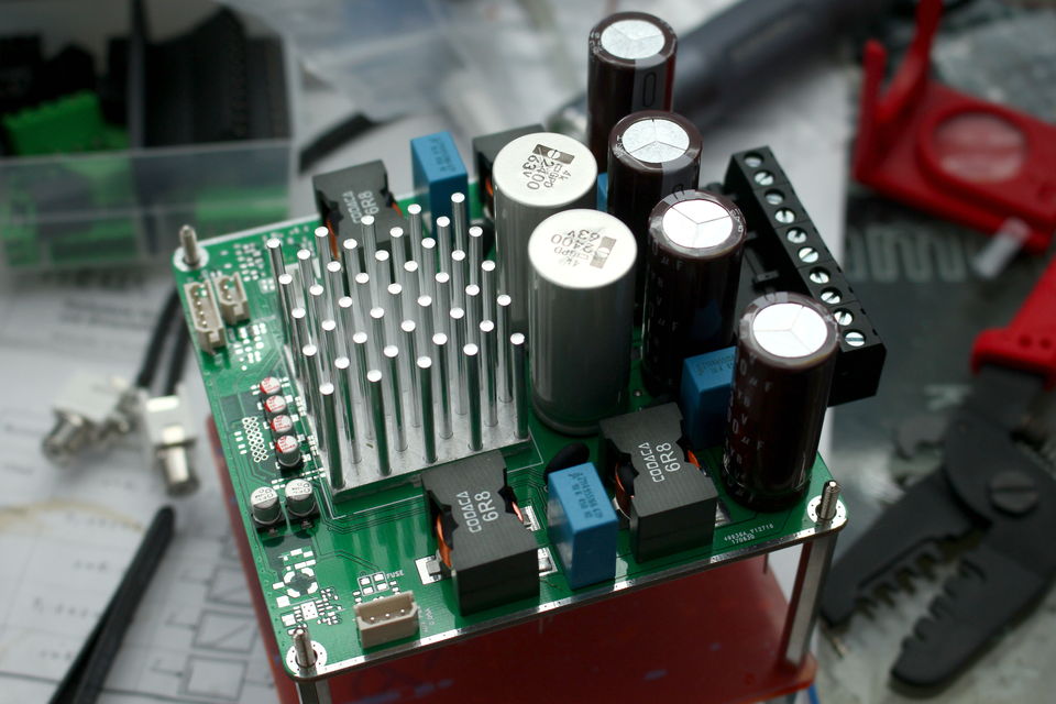

Doctormord,
how is this board your showing here differing from what you've done on the 3251 thread? Are the circuits totally different or would the 3251 and 3255 be interchangeable here? Just trying to figure out the difference between your designs.

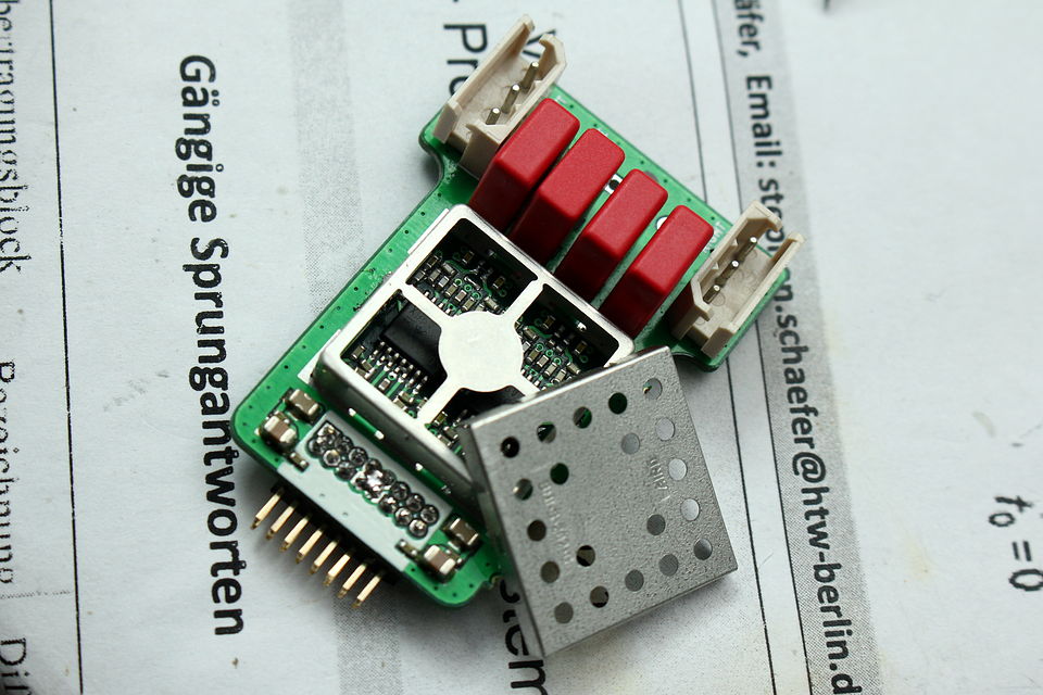

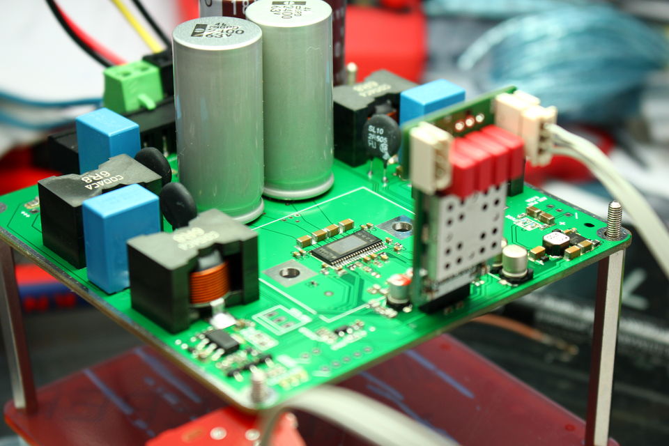

Compared to Rev 1.A. it does have an interchangeable analog-frontend and dual supply for the frontend via Flybuck. (+-15V)
The board works for all Akita TPA32XX with thermal-pad up but not the "Boxster" chips like TPA3221.
Compared to the REV 1.A it is meant to be used with PFFB at all times.
Differencies to Rev 1.A.:
- Analog Supply
- Flybuck IC at 950kHz
- HF decoupling
- GND layout
- PFFB layout
- Analog frontend
- Signal coupling
- Analog Supply
- HF decoupling
- GND layout
- PFFB layout
- Analog frontend
- Signal coupling

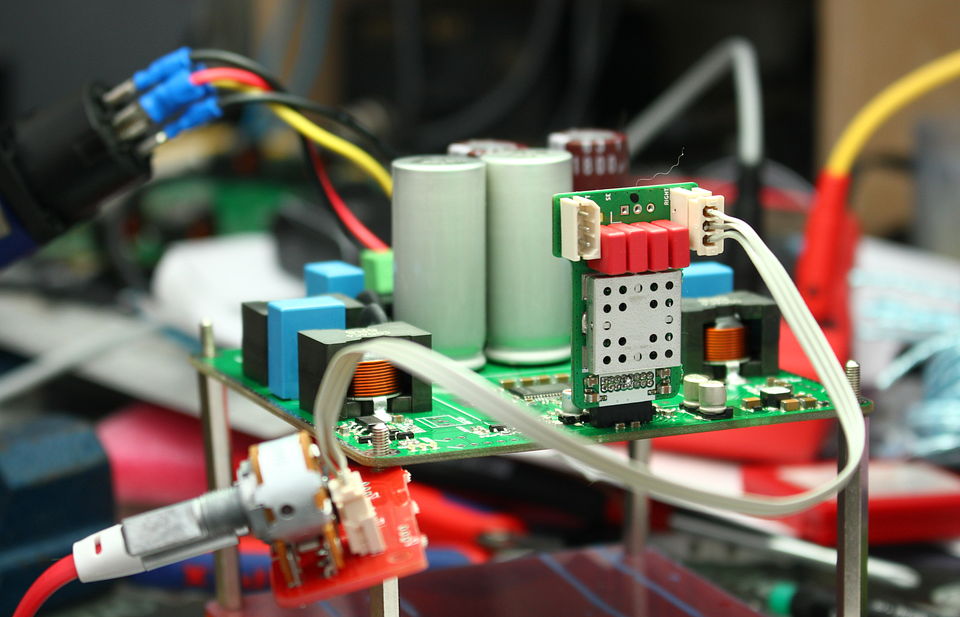

Will the analog input module work with the earlier version of the TPA325x PCB I purchased? I am also very interested in the PFFB implementation based on the TI white paper.
