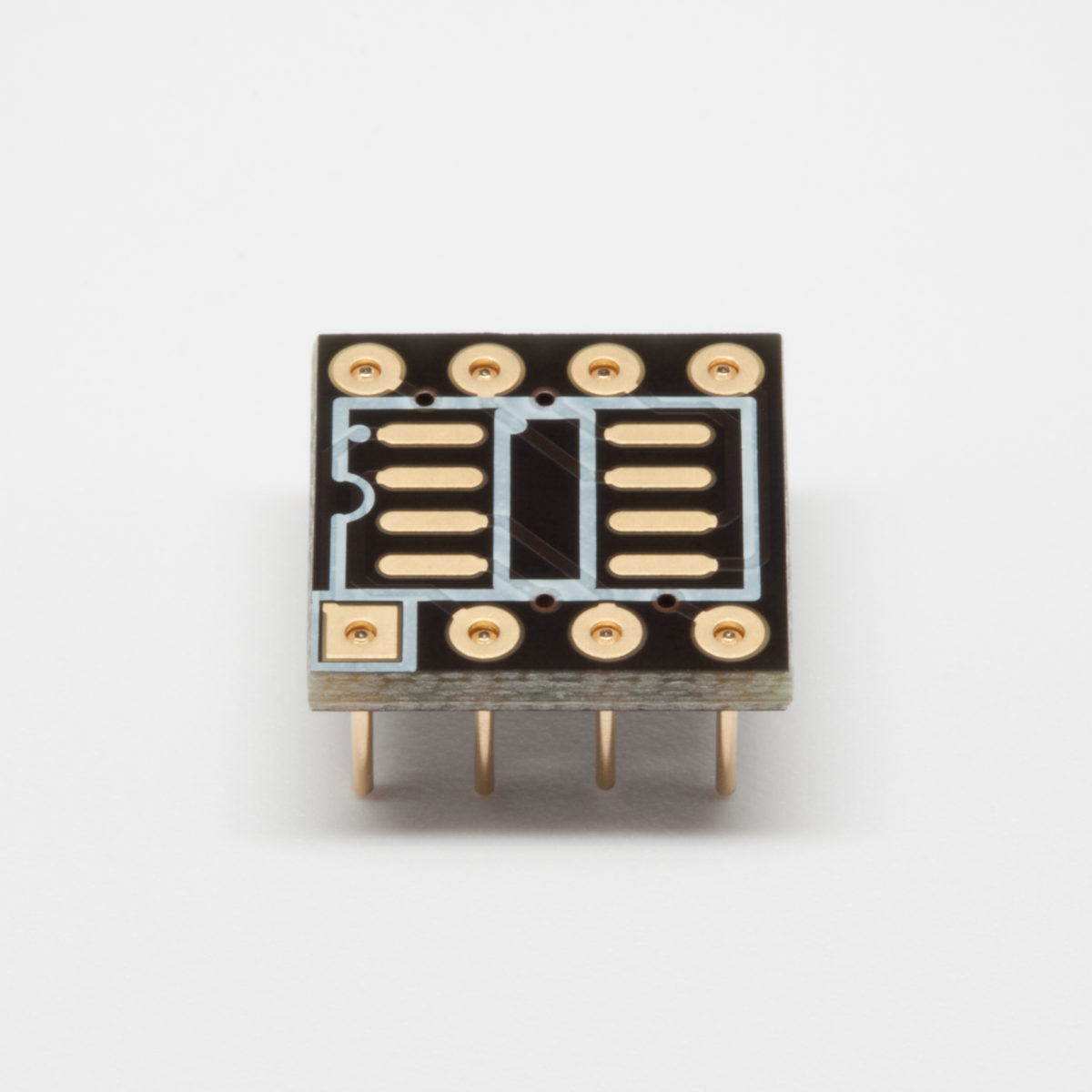

A solution for DIL adapters !!
https://320volt.com/wp-content/uplo...ter-smd-adaptor-smd-adapter-8-pin-adapter.jpg
Anyone found a good/cheap source of OPA1656 chips. Everyone who has stock wants crazy postage !! I am in the UK.
you Can find it un Hungary. But not sure the Guy will sell it without the dip 8 adapter
I'm not going to tell anyone that this process doesn't work, because it will work...
But I will tell everyone it's not a good way of doing it. When you bend any of the pins/legs on a chip like this, you really risk damaging the chip.

I decided to pull the trigger on some SOIC-8 to DIP Adapters (BrownDog 970601) and some OPA1656 op amps from Mouser. I also ordered a set of Coilcraft MA-5173 toroid power inductors (same used in TI 3251EVM) to determine if even better sound can be attained with this little Aiyima TPA3251 2.0 amp.
