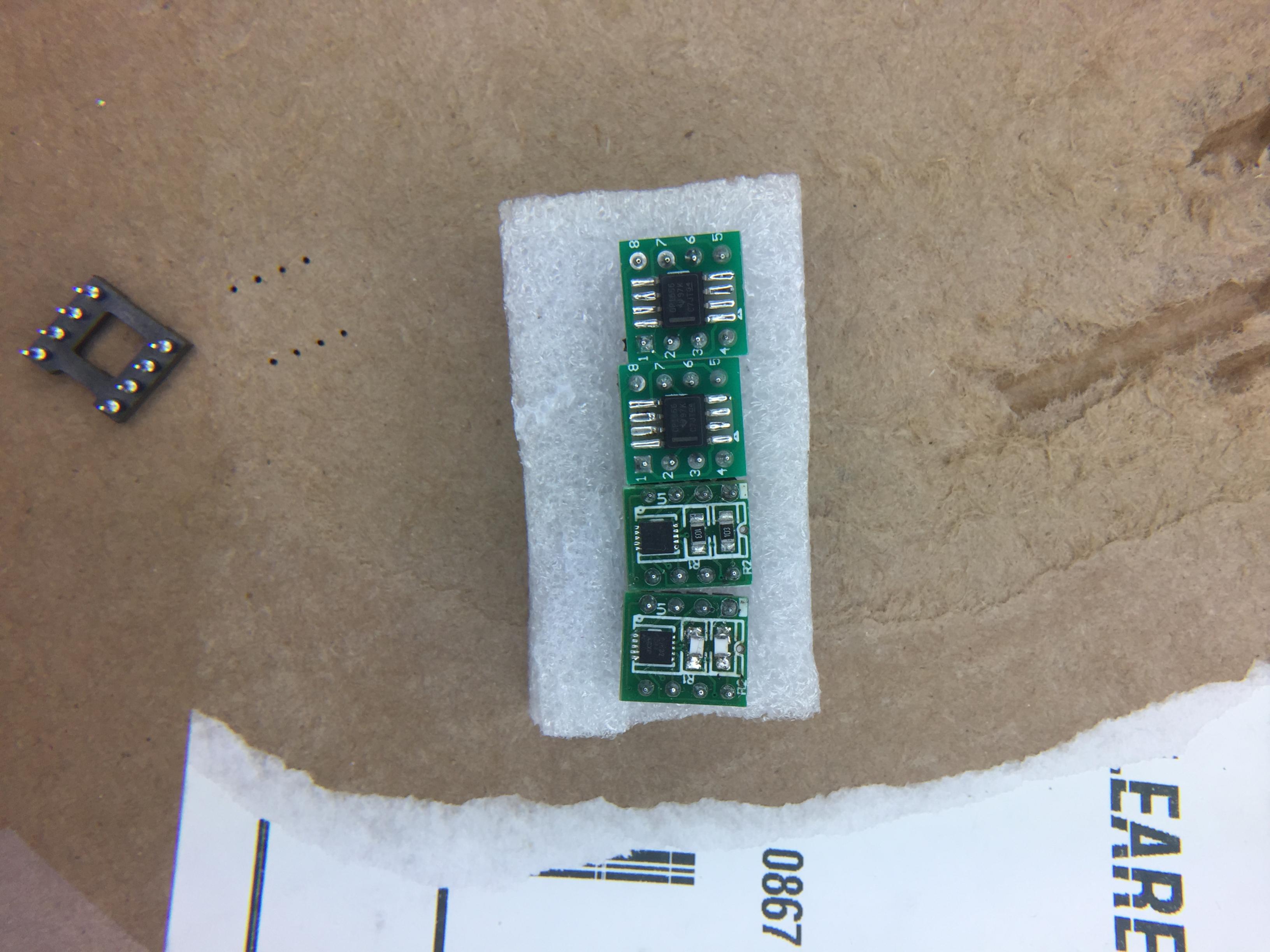

I purchased a pair of OPA627 already made up on an adapter from China off eBay which were not expensive. Still to arrive. They are still listing them.
Also purchased some OPA1656 chips from Mouser which I will make up on adapters if anyone in Europe is interested ?

Mate, what an awfull soldering job these have endured!
Anyway, the orientation you have on the pix seems to be the right one.
Good luck

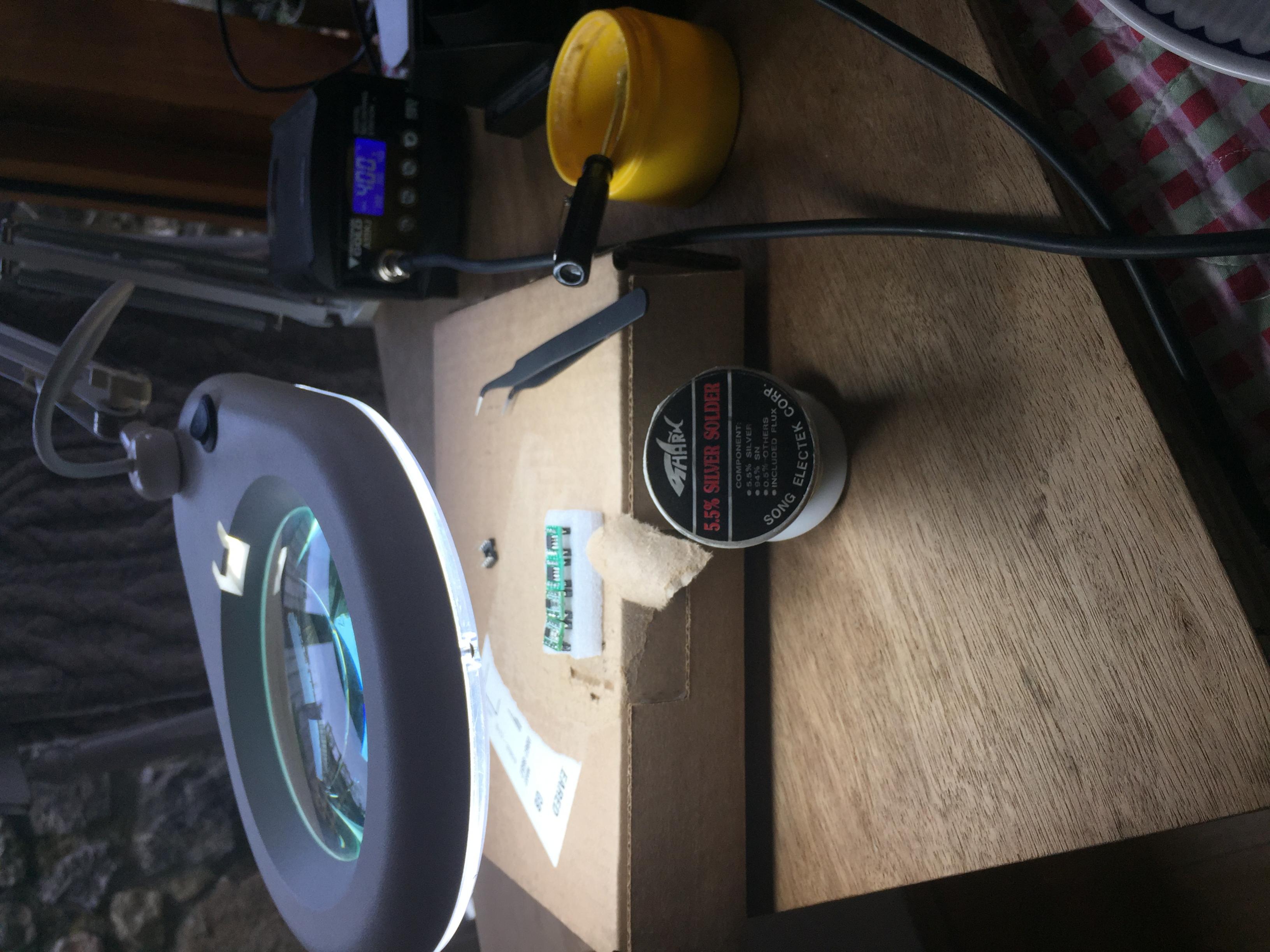

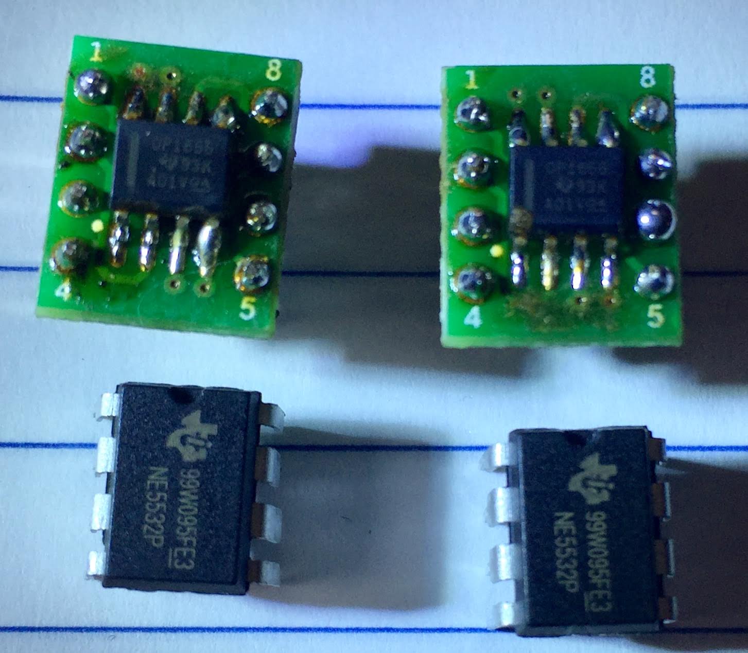

PS. Just soldered up my first two OPA1656 Chips so will test them shortly. Also just received a pair of OPA1622 chips so plenty to listen to over the next few days. Do you want any more OPA1656 Chips ?
A pair of OPA1622 chips - Made in China ! - Soldering questionable !!
A pair of OPA1656 chips - Made in UK by me ! - Soldered using 5.5% Silver solder !! Op Amps sourced through Mouser - Shipped from Germany !
Ready to start doing some Op Amp Rolling with my Aiyima 07, TPA3255 Amplifier.
I only have some little KEF Uni-Q Q15 Speakers to play with at the moment. First tests with original NE5532 chips I thought the speakers were bad ! Took me ages to find some decent quality source music and actually they now sound pretty good but could also because the amp has now been burnt in for a week. This amplifier shows up a bad music source very dramatically - With a good source, it sings.
