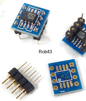

I've got several OPA1692, OPA2209, LME49860, and OPA1656's on order along 10 SOIC to DIP-8 adapters, but I'm still weeks away from being able to solder them up and burn them in. Rob43
By the way, you can get a SOIC8 to DIP8 adapter like this, no need to solder )
^ Thank you.
I considered those non-solder adapters before I ordered everything, but they're on the big side and probably would not fit into my application. Also the bigger square pins that they use probably won't fit into any round hole Dip-8 adapters that normally would get used for op amp rolling.
Rob43
Rob43

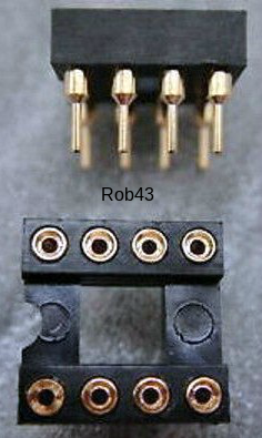

The problem with these adapters is I barely have space for a DIP8 chip between other components so no room for chunky adapters !!
^ Thank you.
Rob43
Yep, they are big.
I'm building onto this type of gold plated adapter, I'll solder the black ones to my main board. Then I'll be able to roll in and out with the blue adapters.
Rob43
