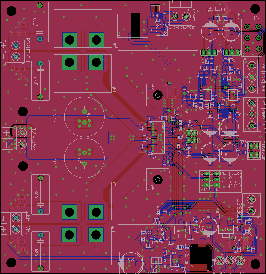

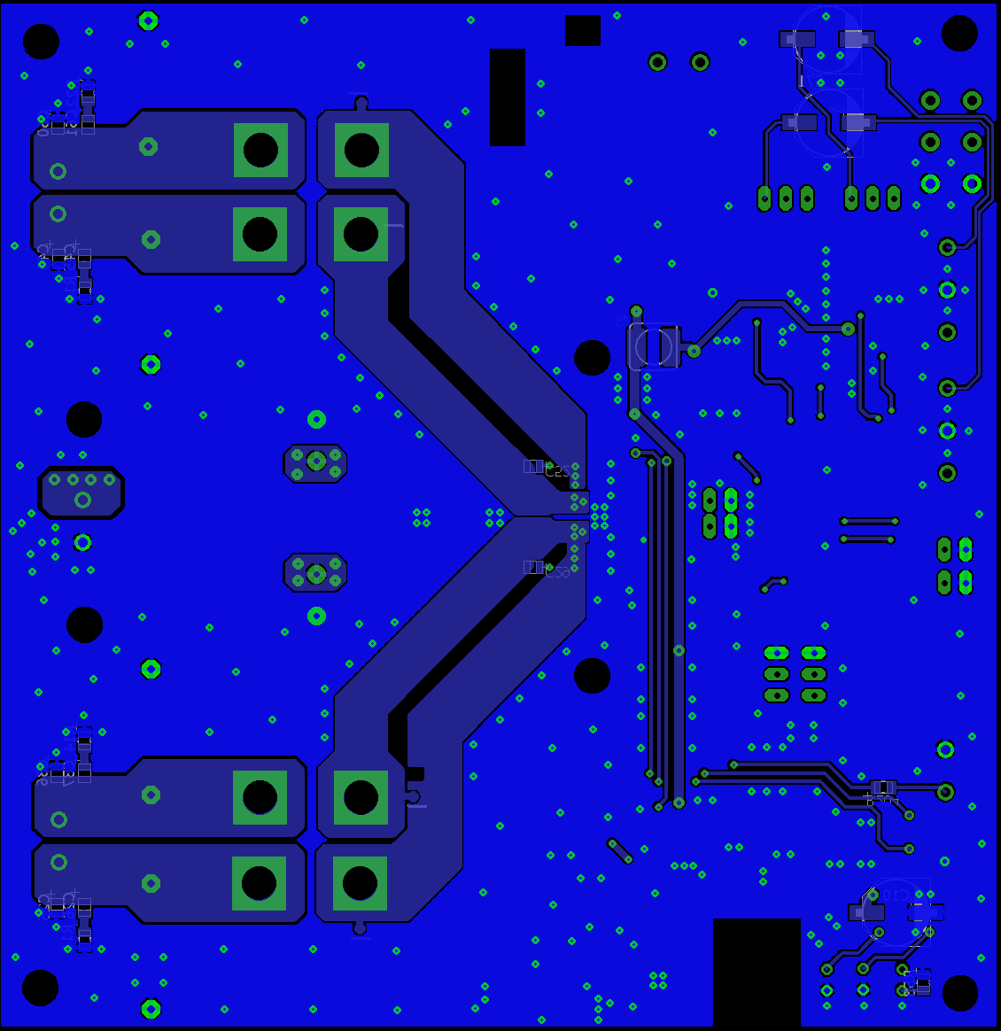

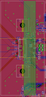

The attachments where helpful frammis. I redid the outputs and C32/C47 based on them.
Thanks for being patient with me Doctormord. I finally got some grasp of current return loops. I think the return paths to the buck are shorter now with the combination of top and bottom gnd plane.
I misplaced 2 of the MLCC's, they were for the supervisory circuit. The MLCC's for the lm5010 are 2.2uF and 0.1uF. I have been reading application documents from TI and other sources. While I know the calculations to get the filter frequency, I am not sure what specific range of frequency that is suppose to be removed. Out of my element. I am adding the 10nF near the buck along with the two original.
As for the header, I am planning to put the jumper underneath the board.
Will the 12V trace underneath the AFE inputs cause problems?

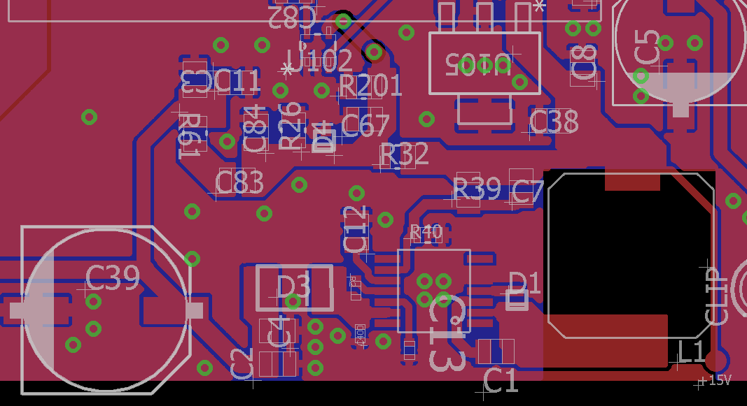

Did you got thermal pad finally fixed now?

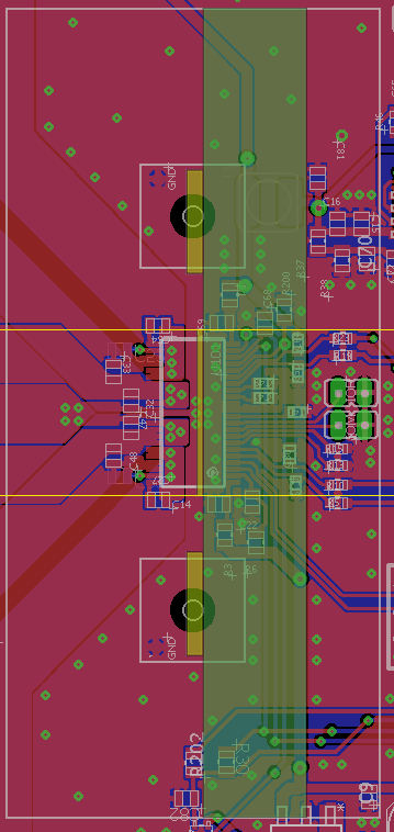

You also finally want to open the middle slot at the bottom plane between the outputs. There's no need to put the two output traces together like this. The you additionally can get rid of the 4 vias at this "Gnd stub" on the top . (That rectangle right next to the bulk caps.
Then think about the jumpers under the heatsink - even when mounted from the bottom, won't the header touch the heatsink anyway because trough hole? And what about mounting distance to a bottom plate or case.
Give this LDO some more thermal vias next to the tab. (like 0.5-0.6mm diameter)
Good progress so far. 🙂

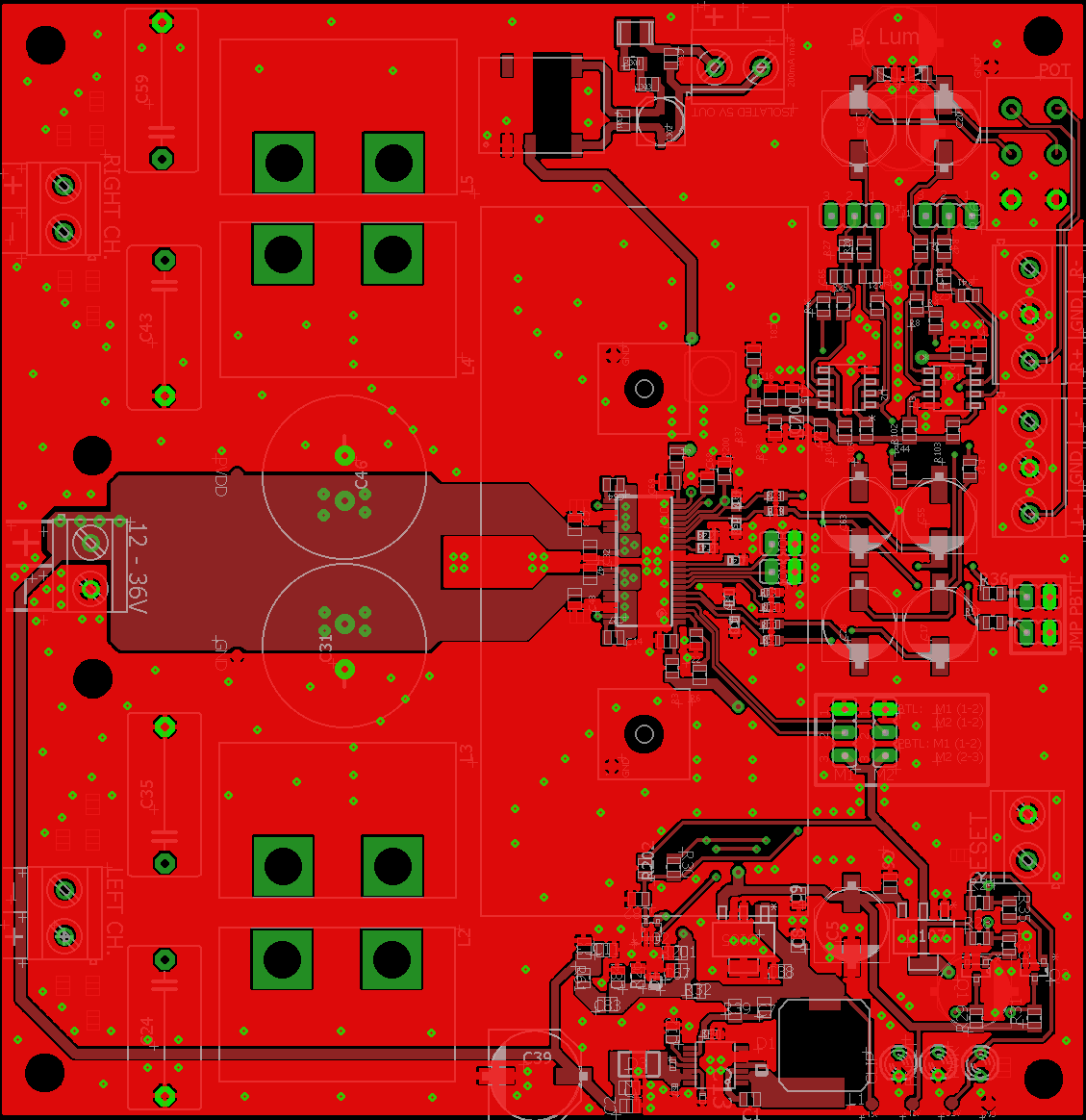

trashcanz,
Great progress! The PVDD decoupling looks good now. I agree with Dr. Mord's comments about the middle slot between the outputs.
I also have questions about clearance. Maybe you already accounted for this, but the TPA3251 TSSOP package is so thin, you might not have enough vertical clearance for the MLCC's unless you use a machined heat sink. The TI EVM sink is available from Digi-key (Advanced Thermal Solutions ATS-TI10P-519-C1-R3) and pictured below. You can see the little pedestal for the die mounting pad that allows lots of clearance underneath.
The heat sink fins or length could be cut down for audio. TI tends to use overkill sizes on their EVMs.

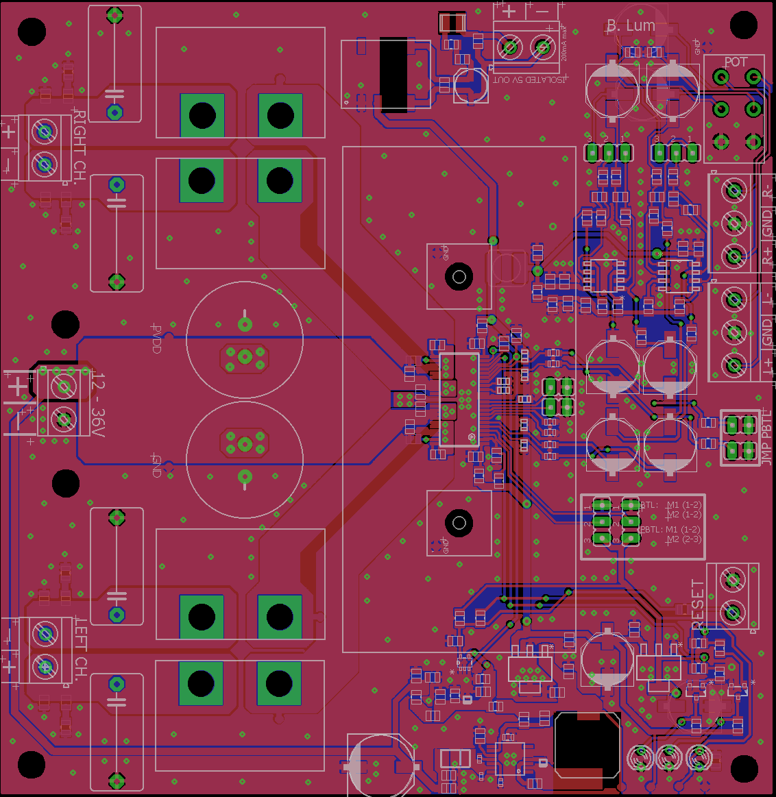

Thanks for the help fellas, greatly appreciate it!
You are correct Doctormord, I looked at the lm5010 and there is a thermal pad there. I forgot about it reading the datasheet. The ground vias you suggested with solid bottom plane should handle the heat dissipation.
That is the exact heatsink I have in front of me, frammis. It is large indeed. I imagine that a very compact board can be made with a smaller heatsink/inductors like doctormord's. My board size as of now is 125x125 mm.
I measured the headers I am using and there should be plenty of clearance. I do have to get extra tall standoffs because of the capacitor and jumpers underneath but I am using a large enclosure for this.
I am getting board made with 2 oz. copper. I am going to spend the next few days going over and cleaning the layout some more before I send it off.
Thanks again!
Thanks again!

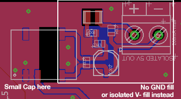

Hmm, 2 more notes:
As this is isolated you don't want to have radiation into the isolated lines or vice versa from the DCDC. Additionally, theres no local decoupling at the converter at the in side.
Either remove the GND-fill in this area completeley or additionally do a local V- fill.
Optional: put a "AC/HF" coupling cap from V- to GND for EMI reasons. (You normally wont need it, but who knows.) Should be 2n2 2KV, so a small X7R ceramic disc through hole is fine.
Secondly:

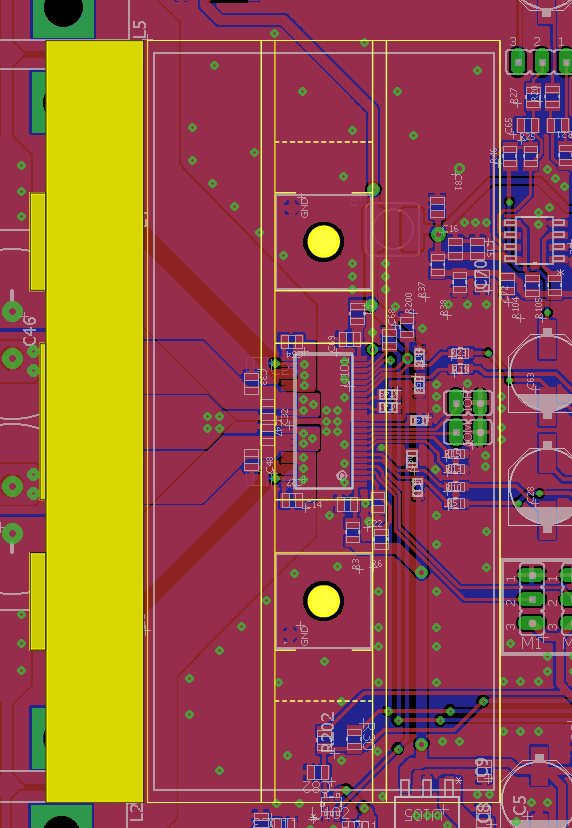

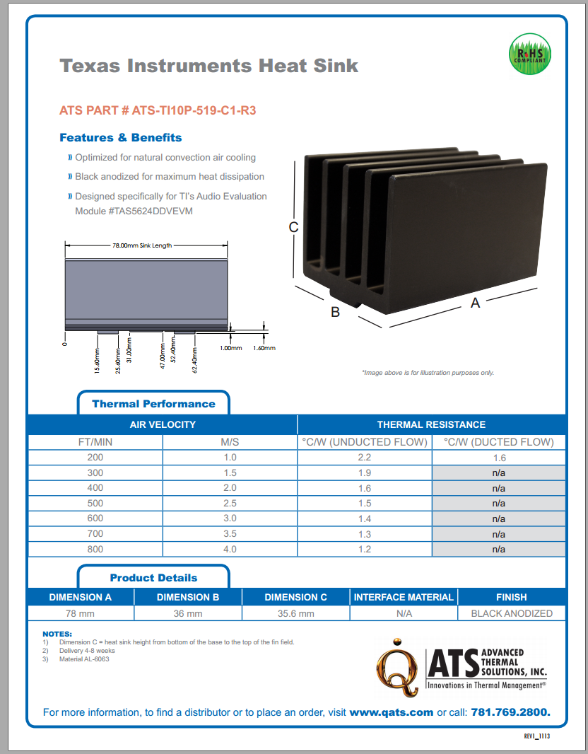

Assuming the Eagle image is with the correct aspect ratio, it seems your heatsink footprint is way of from the dimensions shown in the datasheet. Then, you might have a clearance problem with bootstrap and decoupling if their footprint height is >= 1mm.
Secondly:
As i can't find any more detailed heatsink dimensions, i extracted the outline from the TAS5622 EVM manual:
http://www.ti.com/lit/ug/slau376a/slau376a.pdf
The dimensions are equal to whats shown in the heatsink datasheet.
When scaled to your heatsink outline, the drills are way off:
When scaled to drills, you may run into clearance problems even more:
I'm a bit unsure if they come predrilled or not. The heatsink from the 3251 EVM looks like this:
Images: J.B. - Texas Instruments

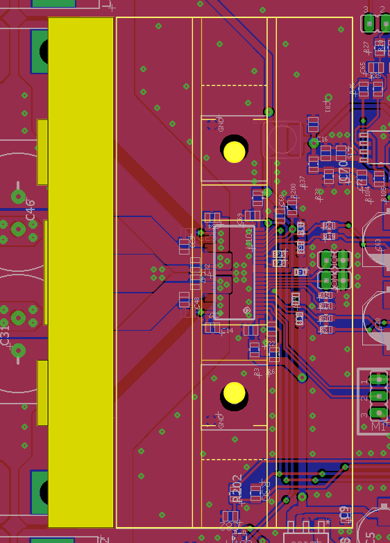

Doctormord,
I double check the heat sink dimensions and clearance on Eagle. Everything seems to check out. I think that scaling is off since I used snipping tool to get the screen captures. I added your suggestions onto the dc converter.
Thanks!
The quality of the Yuan Jing is unknown since it has not been released. However, at 38 usd you will have to expect some low quality components. It is a surprisingly low price, maybe they are getting crazy low bulk prices?
Anyways, I would recommend to get a board with a proven design from forum member gmarsh. Here is his group buy thread.
Doctormord,
Thanks!
Doctormord,
Thanks!
Strange as the mounting holes come out in perfectly round shape. So if it fits, good. 🙂
